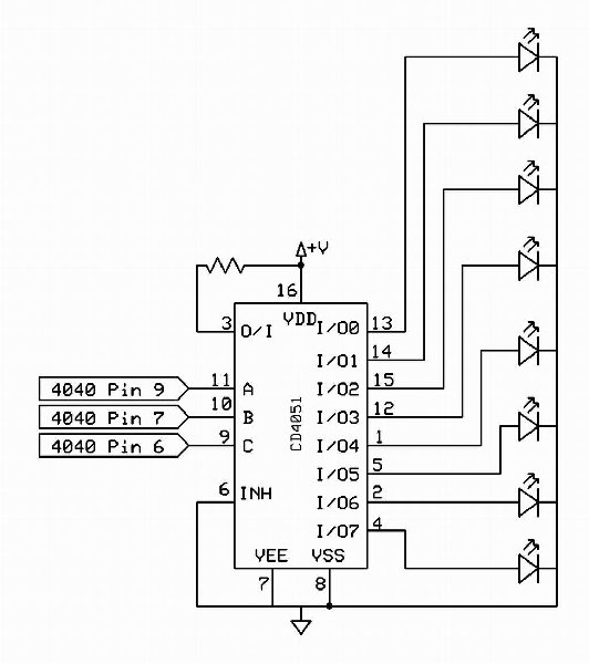

Scott Stites
Joined: Dec 23, 2005
Posts: 4127
Location: Mount Hope, KS USA
Audio files: 96
PostPosted: Sun Nov 21, 2010 2:56 pm    Post subject: Reply with quote  Mark this post and the followings unread
This will work. R is the current limiting resistor for the LED (whatever value you are using). You only need one resistor. Make sure all the ground connections are made on the CD4051 (6, 7 and 8 ) - you don't want any input to float on CMOS. Ever.
Cheerios,
Scott

PostPosted: Sun Nov 21, 2010 4:59 pm    Post subject: Reply with quote  Mark this post and the followings unread
AHA! That works.
Thanks guy's.
