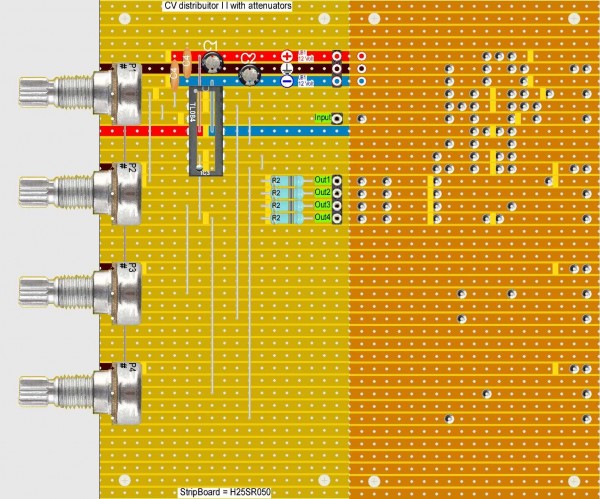

PostPosted: Sat Dec 22, 2012 4:49 am    Post subject: Reply with quote  Mark this post and the followings unread
I saw this thread seeking for buffered multiple tips and also found another schematic from Ray Wilson online. See attachment.
Wondered which one I should choose. The one attached or the one seen in this thread. More detailled here:
http://www.musicfromouterspace.com/analogsynth_new/OLDIESBUTGOODIES/VOLTAGEMIXER/voltagedist1.html
Cause the one attached looks more recent, has attenuator pots and has less components, caps etc. ("more simple" in a way, though the other one is not complicated).
Mostly I was wondering if I would have to change any component value for 15V supply use instead of 12V.
Also if this could be used without problem with audio signals as well... Not necessarily mixing AC and DC signals, but using this module for both uses.

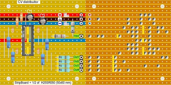

Nardu
Joined: Feb 28, 2011
Posts: 62
Location: Braila, Romania
PostPosted: Sun Dec 23, 2012 8:47 am    Post subject: Reply with quote  Mark this post and the followings unread
Stripboards
 Filesize:  190.8 KB
 Viewed:  285 Time(s)
 Filesize:  98.24 KB
 Viewed:  269 Time(s)
 Filesize:  102.74 KB
 Viewed:  260 Time(s)
