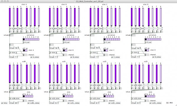

It is a Pd patch for controlling your G2 over midi.
It works fine with my setup.. a MacBook running OS X ver 10.5.8 and Pd-0.42.5-extended.
To use the patch you will need Pd-0.42.5-extended installed on your computer. All you have to do is unzip the file and double click the file G2_Midi_Controller_ver1_00.pd . At the bottom of the screen on the left hand side is a box marked pd help , if you click it you will find some hints on how to set it up.
My G2 has keys but I don't see why it should not work with a G2 engine.

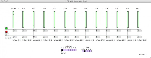

G2 Midi Controller 2
Another Pd patch to control your G2.
I found this one best suited to making presets for a specific slot and variation [with the midi out also being sent to a midi recorder]. It can be used for general performance but things become chaotic as it is easy to get lost.
