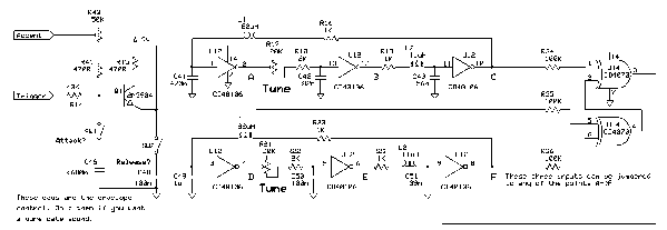

I've got a bit of space left on the board, which is for the second 40106, and I'm seriously thinking of building this version of the oscillators, hard wired into that space, and leaving the first one as my experimenting area.
To add an extra challenge, I'm gonna replicate this circuit around a little audio transformer. The transformer windings, taking the place of the two inductors. I'm not exactly sure of what this will achieve, but I s'pose that's part of the fun. I am 99% sure it will oscillate, but not sure at all about how it will oscillate!

I've been trying out your oscillators on my PC scope, but I'm not sure if I've discovered anything too exciting yet! I've been using two 40106 oscillators to work the trigger and accent, but they are not synchronised.
The problem is that, although the waveforms pre-4070 look like they are being filtered somewhat, the output post-4070 has been squared-up again. There may be subtle phase-shifts going on, but I haven't yet spotted any radical signs of it. I've tried changing L1 and L2 to 68mH and 10mH respectively (about 3 orders of magnitude higher) and it does affect the outputs at pins 10 and 8 of the 40106, but the output at pin 3 of the 4070 doesn't look substantially different. I've recorded a bit of each for you to listen to, to see if you can spot the difference. I will try some variable inductors next, as it may be more easy to spot the difference as you alter the inductance.

I would have thought that all those holes in the 4070 trace show that there is alot of phase cancellation going on. Remember, I don't want these inductors to "filter" the output. Simply to create more delay, and hopefully add more strange artifacts, especially when the other half of the 40106 is setup as the second oscillator. The phase delay will be more obvious when the tune is adjusted, I hope.
Everything will go through the WSG filter after this.
I've come up with a schem for the transformer idea, I'll post it soon. _________________ What makes a space ours, is what we put there, and what we do there. |

that schem is totally untested at this point. There is a good chance that it will actually howl! But that could be good! Couldn't it? _________________ What makes a space ours, is what we put there, and what we do there. |

It's a predominantly percussive instrument, so why not just take two points off each oscillator (in one 40106) and take them straight through a ring modulator? A "real" ring modulator made with two transformers and an assortment of old diodes for the bridge, like that design that,.... hmmm,... oh man, I forget his name. Is it Eric someone?............
Anyway, you get the idea.
With the oscillators close to in tune, you'd still get very nice rich tones, if you want them, but get them a little bit "out", and you'd get a much bigger, clanging kind of beat. High frequencies, way out of tune would be bordering on noise, great for crashes. _________________ What makes a space ours, is what we put there, and what we do there. |

I've been tossing around a few ideas about this, but I've realised that the best course of action right now would be to build the permanent copy of the original schem, minus the inductors. I'll add some insertion links where I can on the stripboard, but it really will be a tight squeeze just to do that. The transformer/ring mod mod will have to be a little tower which could be played around with later.
The other reason is that I still haven't heard the two, three stage oscillators, going into the XOR. Which is actually supposed to create a pseudo ring-mod sound anyway. (once we have two inputs with different frequencies, rather than just different phases, the sound will be somewhere else! Hopefully. )
