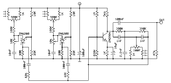

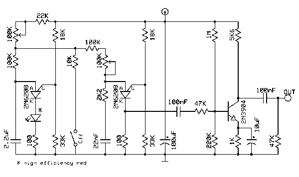

here are 2 schematics, first one is the original Schrödinger II circuit with the modifications I mentioned before.
the 10K pots to adjust the sound (pulse-saw) and the extra resistor, but I used 68K instead of 100K to get the signal
a bit louder. (you can decrease it further if you want it louder, maybe add a pot). The LDR's are connected a bit different
too, so you can kinda fade between pot-control or LDR-control. I also added a pot for the filter.
the second schematic is the siren circuit, nothing really special,. but since I've drawn it I might aswell post it here. Cool
Don't have it breadboarded right now else I could record a short demo.

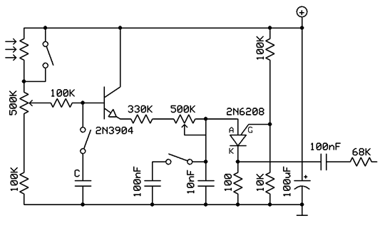

That's pretty much the same as I'm doing except for the transistor, which has a high input impedance and low output
impedance. However the circuit itself allready isn't really low impedance, so modulating it directly (especially with a 555)
should work, except that you might get a small range like I did before I adjusted it. I also added a capacitor for a glide
effect (this is where the transistor comes in handy), just labeled C since it's value is dependent on your own
preference. Maybe a rotary switch with a couple of caps and/or a potentiometer in series is useful here.
Anyway here's the circuit for one oscillator, (I left the filter out of the schematic). you could feed a modulation
signal to the 500K pot at the point where it's connected to the LDR/Switch. (Leave those out is you do or use a diode in series)
O and I left the 10K waveshape pot out of this one since it reduces the range quite a lot.

I've finally got round to to trying out the Schrödinger II - V circuit that you posted. I found that I had to make some minor changes, as I bought some more (cheap) LDRs and they have different characteristics to my older ones (lower resistance, basically). At the moment, I've got 2 of your circuits feeding into the LCF (if you can have an LCA, I can have an LCF). I'm also experimenting with my 555 LFO frequency modulating the 2 oscillators. I'm going to try replacing the 555 with a 4069UBE LFO, as I think this might give better results.
The problem is, that I now have 5 LDRs to "play" and on a breadboard, it's hard to modulate one without affecting the others to some extent. I might actually have to put it in a box eventually...
If I get any good results, I'll post them.
Ralphperez wrote:
Hey thanks for sharing circuit. Very helpful in network analysis
Sorry for the late reply and thanks Very Happy
Gary
Posts: 3826
Audio files: 566
PostPosted: Thu Jan 17, 2013 12:07 pm    Post subject: Reply with quote  Mark this post and the followings unread
sure you can have your LCF Very Happy
It's indeed tricky to play without effecting the others, I allready had the same problems with only 3 LDR's on a breadboard.
And yes they can respond quite different, I think the ones I have have a minimal resistance of ±2K.
As for the oscillator, I'm currently playing around with a 4046 again, and it's surprisingly easy to use, just a cap and resistor/pot
and you got a VCO (modulate the modulator Wink) and you get some nice bonus features too.

Help!
I always liked the sound of this circuit but couldn't really figure out what I wanted to do with it. Until now, when I decided it might work as a small 5-key sortof organ. So I built 5 oscillator pairs (without the LDRs), ran the outputs into momentary switches (not sure how I'm going to implement the keys yet), the other ends of the switches to a common point which then goes into the twin-T filter.
Alas, problems. there is a constant, not-so-faint signal going into the filter even when no switch is pressed. I tried increasing the 68k resistors to 100K then 220K, but the sound remains.
I tried using a unity gain summing amp between the common point and the filter... that produces silence and the filter doesn't work at all. The output of the amp seems to work, albeit perhaps a bit faint.
I built the "Original Schrödinger II schematic with PHOBoS mods" circuit, except removed the LDRs and 10k pot from the oscillators, and increased the 68K's to 220K. I kept the 18K & 33K on the PUT's gate.
Another problem is that I tried building PHOBoS's buffered range control mod, and it doesn't work! I tried a couple of times, I'm quite sure I wired it correctly, but the output signal is extremely faint. I am using 2N6027s rather than 2N6028s (which is erroneously marked as 2N6208 on his schematic). Could that account for a difference?
James.
Posts: 3826
Audio files: 566
PostPosted: Sat Oct 04, 2014 4:54 pm    Post subject: Reply with quote  Mark this post and the followings unread
hmm that's kinda weird,. either it's coming through the powerlines or could the filter be oscillating ?
did you use a capacitor between the opamp and the filter ?
I'd have to test it myself to see what does and doesn't work.
Embarassed
how soft is it?,. I probably tested it having a line out signal, which is much lower than what you would normally get from a lunetta.
No idea about the 2N6027, I'd have to check the datasheet.
SoundCloud BandCamp AcidTrasH Stickney Synthyards
Posts: 348
PostPosted: Sun Oct 05, 2014 6:47 am    Post subject: Reply with quote  Mark this post and the followings unread
Thanks PHOBoS, but don't waste your time building/testing stuff yet. I'm going to take everything off the breadboard and start over. I noticed a few little errors I made, but still, there's a weird thing I don't understand about this circuit...
e.g. if I just listen to the output of one pair of oscillators, without them going into the filter, then the volume is much less (perhaps 1/3 of the normal). I don't know why that is, why a notch filter would boost the volume, but my testing was not considering that "fact".
Back to the breadboards,
James.
Posts: 348
PostPosted: Mon Oct 06, 2014 3:41 am    Post subject: Reply with quote  Mark this post and the followings unread
Alright, so I rebuilt some stuff, and I think one problem is that the twin-T filter seems to pick up noise/hum quite easily. I had a couple of switches to act as keys (wired to breadboard with alligator clips) for the oscillators and already there's a lot more hum than when I had the oscillators wired directly to the filter.
Even touching the wire into the filter generates hum.
Of course, it's all on the breadboard with longer wires than would be used on the PCB.
And there's still signal getting through despite the switches.
I also retried the buffered range control variant on one of the oscillators in a pair and still, the signal is extremely faint compared to its sibling.
I looked at the datasheet for 2N6027 and 2N6028, and to my basic knowledge, they look pretty much the same thing.
I think I will abandon the idea of making a keyboard out of this. I've got some other ideas that could make it an interesting instrument.
James.
Posts: 3826
Audio files: 566
PostPosted: Mon Oct 06, 2014 5:10 am    Post subject: Reply with quote  Mark this post and the followings unread
maybe it works if you use the switches to turn the oscillators on/off instead of just interrupting the signal.
My guess would be to put it between the positive rail and the tuning pot.
Posts: 348
PostPosted: Mon Oct 06, 2014 5:23 pm    Post subject: Reply with quote  Mark this post and the followings unread
D'oh! Of course! So simple. Yes, indeed that works. Thank you.

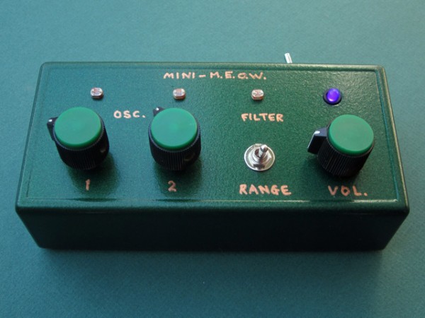

After complicating things, then simplifying things, I've built the Mini-M.E.O.W. based on this circuit.
M.E.O.W. could stand for "Melliloquent Effable Oscillator Weirdness".
Originally I was thinking of making a 5-note keyboard, then settled on something that made more sense, with lead & drone oscillators, and filter controlled via CV or built-in LFO. That was the M.E.O.W. But I decided it wasn't worth the trouble, since the sounds would still be pretty limited and thus I probably wouldn't use it much.
Hence, I made the simpler mini-M.E.O.W., which is pretty much the same circuit I demo'd a while back. I just added a switch to change the capacitor in the oscillator pair to help with different ambient light conditions. The metallic green turned out darker than the spray can indicated, and doesn't quite come out in the photo. The "on" LED is purple.
Short demo video here: http://youtu.be/wrjFjAE10a4
-- James.
The Mini-M.E.O.W. box.
