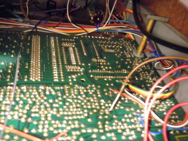

Hi all!
Since I´m in love with the sounds from my minipops 120(yes, the drums with the silly name), I had to find a way to sync it to my modular stuff...
Turns out, it´s very easy to do!
There are the schematics available at this place:
http://www.estecho.com/gear/Korg_Mini-Pops_120.php
In the left upper corner of them you see the "oscillator" which is connected to
some "dividers"...
There you´ll get the CLOCK OUT.
First unplug the power supply!

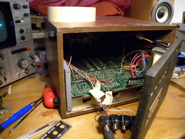

Now open up the rear panel, unscrewing only the four screws that are placed in a square (i did also the THREE, not so clever it turned out). Also carefully remove the 5 jacks from the panel. That´ll look like picture 1.

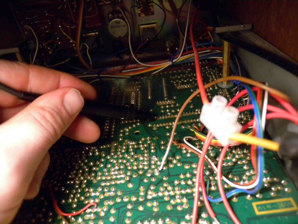

Now you simply solder a wire to the third pin of the first divider chip (see picture 2,3).
Since i disapprove of drilling holes in such a fine machine, i then disconnected the "fade in/out" jack tip-connection (I´ll never use that function from a remote switch) and taped that wire to the ceiling of the box. Now use that jack for routing your clock signal to the outside - done!
There also points for triggering the sounds (output of diode matrix), but as long as my machine´s working that flawless, I´m not going to mess around with stuff.
Cheers!

hey, thank you very very much Very Happy i do it and it's working, in any case on my SQ-10 → MS-20.
it's very simple !!! by cons, I had to remove the "chassis", removing 4 screw under the MP120, and 3 screw from iron chassis in order to get to pin12 on sn611 (divider?) to make welding .
