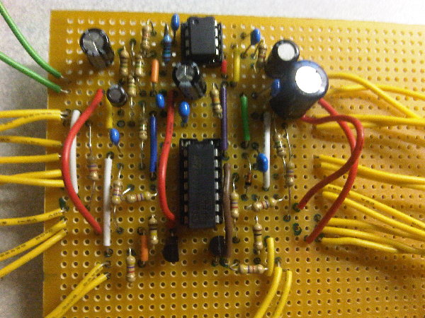

PostPosted: Mon Dec 28, 2009 9:53 am    Post subject: Reply with quote  Mark this post and the followings unread
Thanks for sharing the wsg in stripboard layout cheers
I'm building it...but notice that the bypass caps (c9, c10) are missing.
Can I just solder this caps right next to + and - supply like in the picture?
Sorry I'm no electronics expert Sad
Thanks Very Happy
 Filesize:  47.5 KB
 Viewed:  191 Time(s)
Posts: 4737
Audio files: 51
PostPosted: Wed Dec 30, 2009 6:09 am    Post subject: Reply with quote  Mark this post and the followings unread
Technically, you should put them on the copperside of the board, right underneath each chip. They are for bypassing the chip's supplies and therefore should be located as close as posssible to the chip's supply pins. Really though, in this circuit, it doesn't matter too much. That is the best practice though.

PostPosted: Sun Jan 03, 2010 5:26 am    Post subject: Reply with quote  Mark this post and the followings unread
Thanks.
I put them in the easy way Very Happy
The pcb is finished, moving on to the case Cool

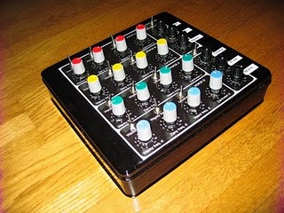

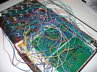

PostPosted: Tue Mar 09, 2010 7:59 am    Post subject: Reply with quote  Mark this post and the followings unread
I've built the WSG (the new version with filter) on eurocard prints.
2 of them.
... and it works...
Sorry if my english isn't correct

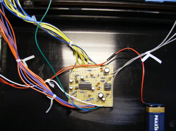

hi there,
First time synth diyer here. Ive been building the WSG using the same stripboard lay-out benuron uses, the improved version from ray's website.
Since it's my first build I took my time and did it slow and rechecked everything twice. But when i switched it on it just produced a very faint fading sound, like something slowly discharging over 5 seconds. I was really dissapointed, a lot of time and care went into building it and I was hoping to be making weird sounds by now. Any thoughts on what it might be?
The things i was confused about on the lay-out:
-The direction of the diodes? did i get it right?
-I added C9 and C10 as described by benuron above, is this correct?
Ive added some pictures, hope it helps... otherwise it's going to be a long night of debugging.

PostPosted: Fri May 28, 2010 6:31 am    Post subject: Reply with quote  Mark this post and the followings unread
DOH!
After rechecking all the resistor value's, panel wiring and a good night of sleep I just found out i ordered and placed the wrong caps. 100 pF and 22 pF just wont do...lol. Well, at least I learned to check the value's of all components before soldering Smile .
My new MKS2 caps in correct value's will be arriving tomorrow, hopefully i didn't damage the IC's and everything is still fine. When I finish this badboy I'll post some pictures.

Oh no! i have also just realised that I have been using the diagram and parts list off the original WSG community page...
is there a parts list that goes with the diagram on the first page?
thanks in advance.
Serin

squash2 wrote:
I thought you were joking about the wedding dress spam thing, but my first account has been de-activated! I know nothing about that, and it is impossible anyone could have got to my computer - now im worried i have some sort of virus :S
(how should i have contacted an admin with out making another account?)
there is an email address ... somewhere ... and no it was no joke .. maybe your password was guessed or something? (such wouldn't be the 1st time here)

What I think you should do squash2 is:
Check the stripboard diagram on page 1 of this thread. Make sure the back of your board is correct. Have you made ALL of the cut marks and in the right place? Are any of the cuts not done properly?
Check the list of components on Page 1. This could be one of your problems, which it looks like you have identified yourself.
Make sure ALL of the components are of the correct value and the correct place. It looks like you have run jumpers further than needed, then run others back. I think if you start deviating from the plan or move things across one hole or shuffle things around, you could run into problems.
Once you have checked all this and are sure it is right, you should check all your soldering. Make sure you haven't bridged any of the stripboard tracks. Look out for dry solder joints.
Make sure your IC's are inserted correctly and there are no legs bent over and not inserted in the sockets. *You may need to replace the IC which got hot. Don't turn the device on though until you check all of the other things, or you may fry another one! Make sure the IC's are the right way around. (Yours look ok)
Check the wiring to the pots. Is it joined to the board in the right places?
Basically, you need to make sure you follow the diagram EXACTLY for the greatest chance of success. Also, do it as NEATLY as possible. The WSG is a great little device! I know you'll love it once it works for you!
Hope this helps. Good luck!

Thanks for the feed back everyone Smile
Basically, what ive decided to do, is just re order the cheap parts, i.e. everything that goes on the circuit board and re use the expensive ones, such as the rot pots etc. I think im also going to get a much better soldering iron, as the one i was using was rediculously big for the job.
Ill let you know how it goes Smile
