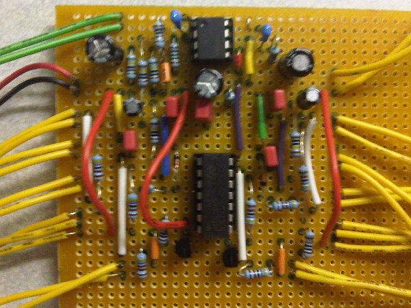

Hi everyone -
I have had a second go, with a new soldering iron, but the result does no more than the first attempt Sad
I have got WIMA caps, the small red blocks, and I THINK they are MKS2 caps, as specified.
What I dont understand though is what -minus- told me on the previous page - he said that some caps are in the wrong place and some are not there at all - is this refering to this layout that benuron posted, with extra capacitors at the bottom?
I have been following the diagram on the FIRST page.
Please could anyone leave any suggestions based on this new picture and these couple of observations -
-Again, the only thing it does is put some sort of effect on the static fuzz
-I am not using CD40106, i am using LM723CN, still DIL 14
- Having the long IC chip in or having it out makes no difference to the audio signal
-I have jumped where the 1M pot in the top left should be as I dont have one for there, there is one more in this version of the schem than the last one.
Thanks alot in advance.

Serin,
The first issue is with the chips. The CD40106 is a completely different chip to the LM723.
The LM723 is a linear voltage regulator (used to make DC power supplies), the 40106 is a hex Schmidt Trigger. You must use a 40106 for this circuit to have any chance of working.
Try picking one up from Maplin or somewhere similar and see how the circuit works then.

Thanks magman,
I have ordered some off a different website and am eager for the chips to arrive!!
I assumed the LM723 would work as I put DIL 14 into the maplin search after trying CD40106 (which came up with no results) and the LM723 is what came up.
Pity maplin dont have it, as i have to pay extra for delivery from another site Sad
oh well, ill post once ive tried the new IC!
Thanks again,
Serin

Good to see that you haven't given up yet! Very Happy Yes, that IC does have to be a 40106. This is certainly the first thing to fix. The caps at the bottom of the board... C15 and C16 on Krunkus' stripboard. I can't see them on your photo. Have a look at benurons or tjookums photos. The caps are there.
Anyway, get the correct IC first. I know all these numbers and terminology can be really confusing at first! I still struggle with it all myself. This was the first thing I built! I remember emailing a scan of my stripboard cuts to Krunkus... I scraped a perfect square break at each point! It was then that Uncle Krunkus told me about drilling the breaks with a 3MM drill bit and a pin vice!! I had no idea! Took me HOURS doing it the way I had!
I have no doubt that you will get something working if you keep asking here on the forum for help! And when you do, the feeling of happiness will be huge!!!!!

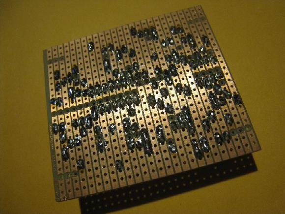

I decided to use the Andrew Sharp layout on the MFOS WSG page and just finished installing all the components and jumpers, getting ready to start on the panel wiring. I really enjoyed the process, and see a number of additional stripboard projects happening in the future. I'm pretty pleased with this, my first stripboard effort, and thought I'd share these intermediate results with the group. Thanks to everyone for the open discussions and sharing your successes and tribulations... it all provided me with a solid background with which to take this first step. Fun stuff.....
<Marv>
