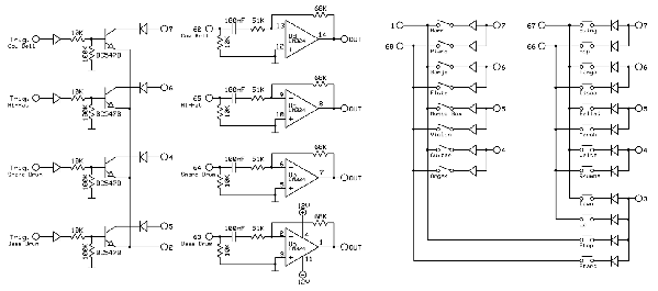

yes I did test it, I actually had it allready tested on breadboard when I posted the schematic, but now it's soldered up aswell. And I did a test
playing the demo and triggering the cowbell (which doesn't seem to be present in any rhythm) with it. Allthough the tempo is correct it doesn't
really seem to be in sync with the rhythm. Still usefull though and I could always make it sync up by adding a pulse delay
I used the space I had left on my perfboard to add trigger inputs and output buffers for the drumsounds. The triggers are made with a transistor
functioning as a switch. The output buffers are made with an inverting opamp to set the levels roughly to +5V/-5V. I added the capacitors so the
output is 0V when the drums aren't triggered. I also drew in the original switches and pushbuttons I'll have to add to get the sounds and rhythms.
I will use toggle switches for the sounds so it's possible to select more sounds at once (I actually haven't tried this with the rhythms yet, hmm).
What's left for the rhythm section is an output mixer. The plan is to make a stereo mixer and hardwire the sounds with different resistor values
to the left and right channels (bassdrum centered, snaredrum more to the left, hi-hat more to the right, maybe something special for the cowbell)
And I was thinking of adding some VCA's but I tried some simple designs without any success. I better not add too much anyway else it'll never
get finished Wink

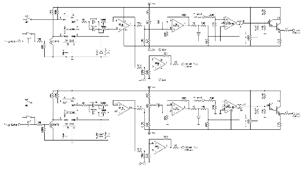

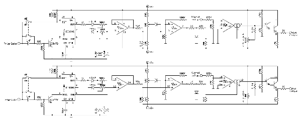

The next thing I added was 2 envelope generators and VCA's. I used the AD/AR design from the Lun-A-Key but with a transistor inverter and a capacitor
on the input to create trigger pulses from a gate signal. I also added a zenerdiode to limit the maximum charge voltage. In triggermode the voltage
will rise to 2/3 of the supply Voltage (8V using a 12V supply), and then discharge. In gate mode it would keep charging to almost 12V without the
zenerdiode, which limits the voltage to just above the treshold level. I didn't convert the voltage to -5V/+5V but only buffered it with a voltage
follower since it is connected directly to the VCA. However I might change this so I can use the AD/AR and VCA's seperately. Rolling Eyes
I also made 2 VCF's based on the EFM Wildcat VCF which I found in the schematics vault (thanks vladosh!).
I used larger filter capacitors, changed some other values and added the 4.7M resistors to the base of the darlington's to keep the level around 0V.
This also tempers the resonance a bit so it doesn't go too wild.

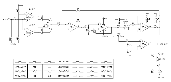

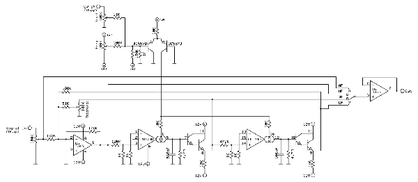

PostPosted: Sat Jun 01, 2013 5:09 pm    Post subject: Reply with quote  Mark this post and the followings unread
I did not add an external CV input for the VCA section but I did add an extra opamp to convert the output of the AD/AR to -5V..+5V. So here's
an updated schematic. (btw I'm using this calculator to get the right resistor values Wink)
I also made 2 gated LFO's. I started out with a standard comparator/integrator combination to produce square and triangle waveforms,
with a pot. to 'morph' between the two. I then added the gated section similar to what I used for my circuit bent Super Concert keyboard.
but this didn't work right away.
The first problem I ran into was that I could only gate the LFO (through the 4M7 resistor attached to the non inverting input of Uc) with a
high signal and not with a low signal. The reason this does work in my super concert keyboard is because that one uses a single supply with
a fake GND for the LFO. So a low signal pulls it below fake GND. To solve this I used a comparator (Ub) that converts the 0/5V gate signal
into -12V/+12V. Since I also needed an inverted signal I added another comparator with the inputs swapped (Ua). (In the super concert
schematic this is done by U4b).
So now the LFO stopped oscillating by making the gate low/high as it should, but the output of Ud, which provides the triangle wave,
would go all the way to -12V/+12V instead of -5V/+5V (which it does when it oscillates). So I added the two 4.7V zener diodes on the
input of Ub to limit the voltage.
But this still didn't completely work. If the LFO is stopped by pulling the input of Uc above GND, the output of Ud rises to +12V and the two 4.7V
zenerdiodes will limit the output voltage to +5V. so far so good. Smile But if you 'start' the LFO again it takes some time before the output of Ud
has dropped below +5V. So the output is stuck before it starts dropping, which means there's a delay between the gate input and the output.
not good Sad So somehow I had to stop Ud from rising /dropping to far.
I first moved Ua into the oscillator circuit. Ua together with the voltage divider on it's input attenuates the squarewave, produced by Uc,
to -5V/+5V. This didn't really work but later turned out to be useful anyway. limiting the in/output of Ud with two zenerdiodes didn't
work either, but I finally got some succes by limiting the voltage across the capacitors. 5.1V zenerdiodes seemed to work at first but the
oscillator stalled at low speeds. So I had to increase the voltage and 6.8V was the lowest voltage I had that worked. If I remember correctly
I needed an even higher voltage without Ua added into the oscillator.
So I didn't get the delay completely removed but it's a lot shorter. And works good enough for me. Very Happy
I drew some waveforms to show the various gated settings. The waveforms on the leftside of the chart correspond with the rotary
switch turned completely CCW.

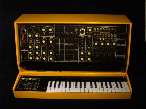

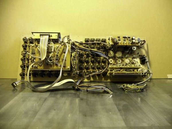

PostPosted: Tue Jul 02, 2013 6:46 am    Post subject: progress Reply with quote  Mark this post and the followings unread
I finally got the pots so was able to wire the whole panel up. And it all worked instantly Laughing Well almost, I had the finetune pot hooked up
backwards Embarassed and it looks like you can't combine the rhythms afterall.
But I only did a very quick test, maybe it has to do with switching at the right time. Anyway I think it looks nice this way and I won't change it to pushbuttons.
I added connectors to the keyboard PCB which is connected with 2 ribbon cables to the frontpanel. The chips are shiftregisters which are going to be
used to have a PIC control the keyboard. Which is the next part I have to do. I know it's going to have midi in and midi out, but I could do all kinds
of neat things (like arpeggios/seguences which can be generated random in any key). I'm thinking of making it in a seperate case connected with
one of those curly cords (I think I have an old computer keyboard with one somewhere). I'll make it so it can slide in underneath the case for storage.
The PSU is also used to power my other synths, so I went with a 80VA toroid.
* there's something wrong with my camera (or I used the wrong setting) so the colors are a bit off.

close up of voice and rhythm section.
 Filesize:  67.69 KB

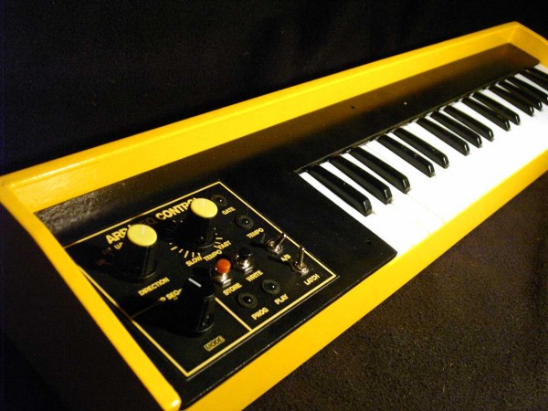

PostPosted: Sat Jul 06, 2013 3:57 pm    Post subject: more progress
Subject description: and a few steps back
..The chips are shiftregisters which are going to be
So that's what i'm doing now. I first had to make a PCB with a couple of shiftregisters (parallel to serial converter) to connect the keyboard to
the PIC. I'm using 8 bit shiftregisters (74HCT165) and with 37 keys I needed at least 5. That would give me 40 inputs, but I choose 6, so I
have 3 + 8 extra inputs free to attach some extra switches for different modes.
Before adding midi and other things I first want to be able to just use the keys to control it. So I wrote a simple program that just sends the info
from the keys straight through. The good news is the keyboard almost works perfectly, except for two keys that seem to be linked together.
But I just opened it up and it's just one small trace I didn't cut Embarassed, so that's an easy fix. However there is something a bit weird going on;
when I play the keyboard it's delayed by one keypress,.. so If I press A, B, C, D I get _, A, B, C. My initial idea was that this might be caused by
the interface with the PIC somehow, but when I trigger the keys directly by shorting the (key)pads with a screwdriver I get the same result.
So far I had been taking the audio from after the envelope generators I added. So I tried the signal coming directly from the oscillators and then
it seems to work as it should. So I guess that somewhere I might have swapped something around, which I should be able to figure out. I also
noticed that I probably swapped some wires on the voice select switches, maybe the rhythms too depending on where I swapped them.
so I'll have to look into that aswell.
Something else, the +5V and especially the +12V regulator get too warm. I guess adding those extra shiftregisters (6 for input, 5 for output) and
PIC to the +5v requires a bit more power then I expected, and since the 12V regulator supplies the current for the 5V regulator it's heating up
quite a bit. While I was testing it even came to a point where I couldn't turn up the VCO speed very far or it started acting weird (scared me
for a second). I guess the voltage had dropped too far but it worked fine again after I switched it off and waited for a few minutes before
switching it back on. So I'll have to add some better cooling to those,.. Rolling Eyes

PostPosted: Sun Jul 07, 2013 11:27 am    Post subject: cool it man Reply with quote  Mark this post and the followings unread
I added some better cooling to the +12V and +5V regulators, works like a charm. The 5V regulator barely get's warm, and the 12V one get's a bit
warm, but it's a nice and mellow warmth Wink. So here are some pics of that, and a photo of the current test setup. Cool
bigger, better heatsink
 Filesize:  71.02 KB
 Viewed:  260 Time(s)
cool regulators
 Filesize:  76.83 KB
 Viewed:  254 Time(s)
current test setup, with keyboard and PIC.
 Filesize:  85.06 KB
 Viewed:  267 Time(s)

I think it has been collecting dust long enough now so I started finishing it up. The PIC is fully programmed although
I haven't tested the midi control yet (midi out works), but it is already present in the code. I played with it a bit,
having some fun with the arpeggiator, and I will post some recordings of that session later.
I'm now working on the keyboard case and then I have to make a case for the synth itself.
keyboard case
 Filesize:  73.06 KB
 Viewed:  196 Time(s)
keyboard case
 Filesize:  60.06 KB
 Viewed:  209 Time(s)
SoundCloud BandCamp AcidTrasH Stickney Synthyards

PostPosted: Sun Jan 11, 2015 3:18 pm    Post subject: Reply with quote  Mark this post and the followings unread
Smile 8 is my favourite

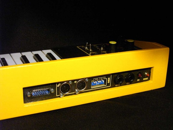

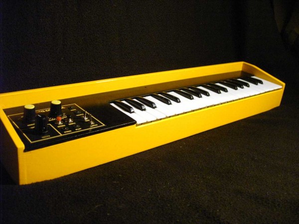

I put some paint on the keyboard Cool
EK2100 keyboard
 Filesize:  80.7 KB
 Viewed:  195 Time(s)
EK2100 keyboard
 Filesize:  91.31 KB
 Viewed:  197 Time(s)
EK2100 keyboard (backside connectors)
 Filesize:  63.08 KB
 Viewed:  194 Time(s)

PostPosted: Thu Feb 05, 2015 1:55 pm    Post subject: Reply with quote  Mark this post and the followings unread
I finished it last night and did a quick test, which I recorded. Very Happy
The first recording has some arp. action the second one is a self playing noodle.
(more photos here )
 Filesize:  87.72 KB
 Viewed:  209 Time(s)
PHOBoS - EK2100 demo (Feb 05, 2015) - Arpiod.mp3
PHOBoS - Arpiod
Download
 Filename:  PHOBoS - EK2100 demo (Feb 05, 2015) - Arpiod.mp3
 Filesize:  4.71 MB
 Downloaded:  367 Time(s)
PHOBoS - EK2100 demo (Feb 05, 2015) - Noodle 2100.mp3
PHOBoS - Noodle 2100
Download
 Filename:  PHOBoS - EK2100 demo (Feb 05, 2015) - Noodle 2100.mp3
 Filesize:  12.16 MB
 Downloaded:  364 Time(s)
