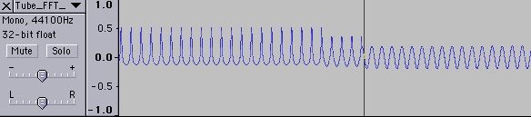

PostPosted: Sat May 03, 2008 3:19 am    Post subject: Reply with quote  Mark this post and the followings unread
I have a good one for you here. As posted in another thread but this time with source code. Tube FFT Warmer sweeps the decaying harmonics from zero to full amplitude three times at ten seconds each time in the output file. The result is a swept tube-like "warming" enhancement to the sound.
The waveforms.
 Filesize:  14.21 KB
 Viewed:  6357 Time(s)
Tube_FFT_Warmer2.ck
The ChucK file that does this test effect.
Download
 Filename:  Tube_FFT_Warmer2.ck
 Filesize:  1.92 KB
 Downloaded:  146 Time(s)
Tube_FFT_Warmer1.mp3
The warmed up sinusoid sound file.
Download
 Filename:  Tube_FFT_Warmer1.mp3
 Filesize:  468.68 KB
 Downloaded:  321 Time(s)
