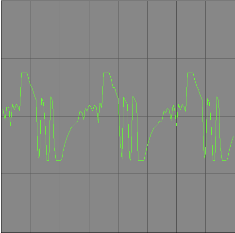

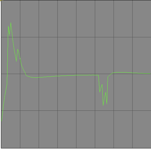

well yes you do normally get square waves...
but with that "CV" input i mentioned you can sneak some curves out of those chips
here is some scope shots of...
the shot that has the peak and then valley has the scope locked on to one cycle - it was a repeating waveform

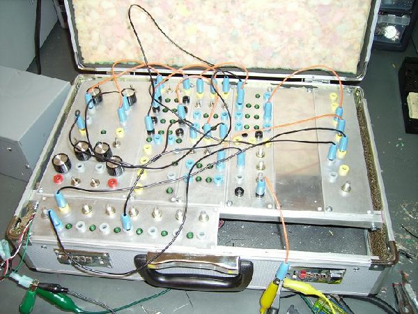

I put together what I imagine is a more 'conventional' Lunetta patch - I'm trying to figure out just what the possibilities are with these circuits and these are really just first steps. I think I have enough modules to play a bit now. I'm really short of patch cords, though - and a bunch of those stacking plugs are pretty tempting.
Anyway - here's just a clip of the pictured patch. Halfway through the recording I moved one plug from the 4024 Clock Divider/Sub Oscillator from -6 octave to -7.
This patch uses the Bugs 40106 Osc's, 8 stage serial Shift Register, 4 stage Shift Register, 4024 clock divider, R/2R Ladder.
Perhaps not quite Lunetta like - I used a simple 555 VCO for the single oscilltor voice you hear.
