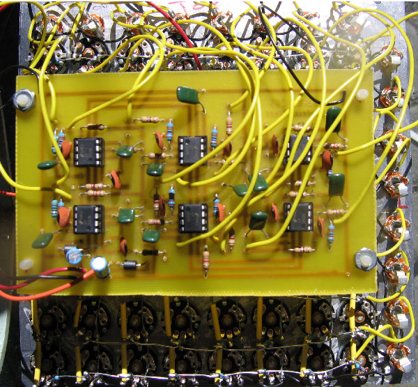

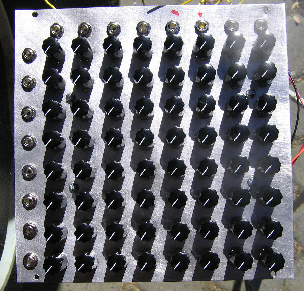

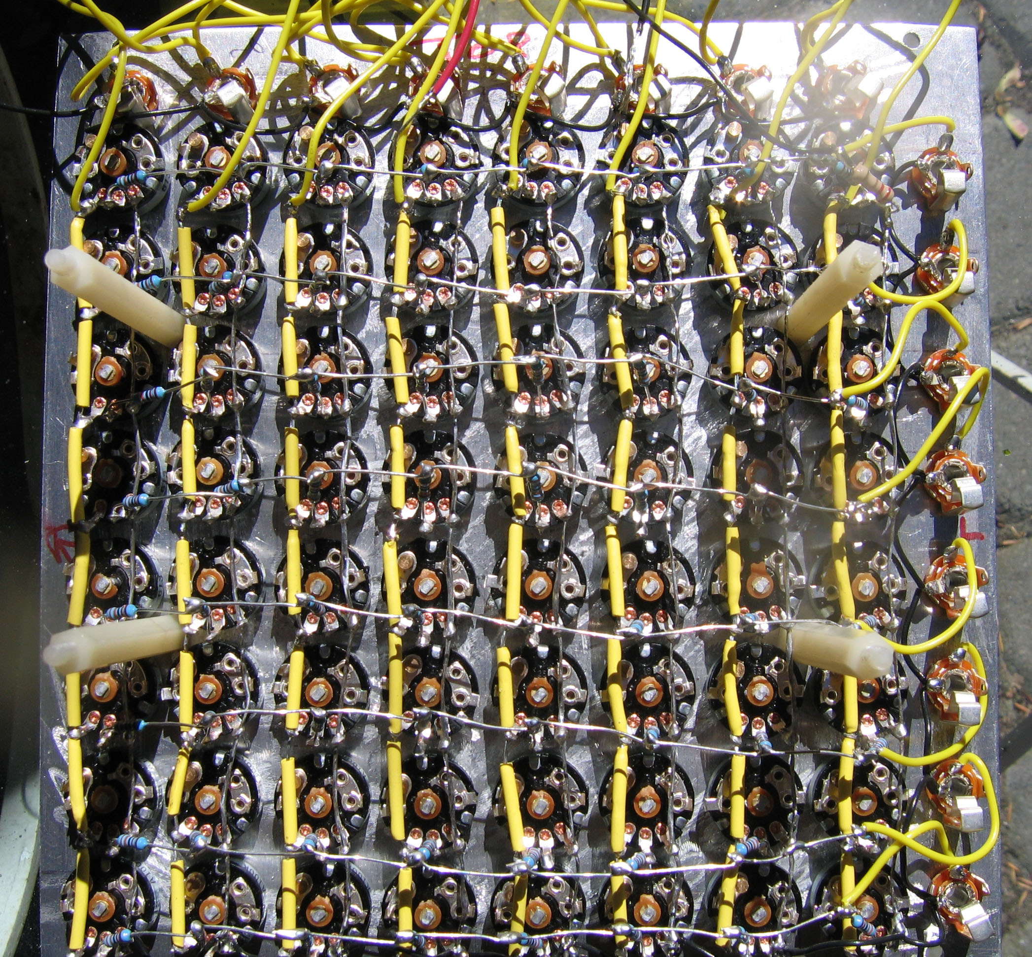

PostPosted: Sat Jun 28, 2008 12:46 pm    Post subject:  Photos Reply with quote  Mark this post and the followings unread
Here's a few pix: Front, back w/ pcb, back, and w/out pcb. PCB layout and samples will follow.

PostPosted: Sat Jun 28, 2008 1:03 pm    Post subject: Reply with quote  Mark this post and the followings unread
Laughing that's a nice bunch of wires for sure!

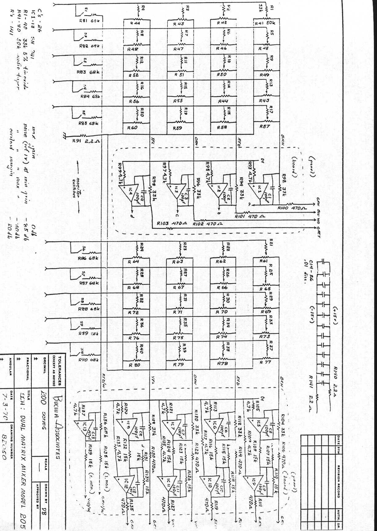

PostPosted: Sun Jun 29, 2008 9:13 am    Post subject: Reply with quote  Mark this post and the followings unread
Hi Unkle Krunkus!
No, I didn't say I would post it. I'd assumed that it was on the net already, but as it turns out... it ain't. Here it is.
R.

PostPosted: Mon Jun 30, 2008 6:38 pm    Post subject: Reply with quote  Mark this post and the followings unread
Hi Krunkus!
The Buchla 205 has two sections that are both 5 input mixers where any of the 5 inputs can be sent to any of 4 outputs. In addition to the 4 outputs, there's an extra 4 outputs that are mixes of both sections.
For the live gig, I will be feeding 8 vcas into each of the matrix inputs and directing them to 6 monitors in the performance space. I will use the 2 additional outputs as effect sends. That's where I'll probably get some wacky feedback going!

PostPosted: Mon Jun 30, 2008 7:16 pm    Post subject: Reply with quote  Mark this post and the followings unread
So how have you adapted that to an 8*8?
