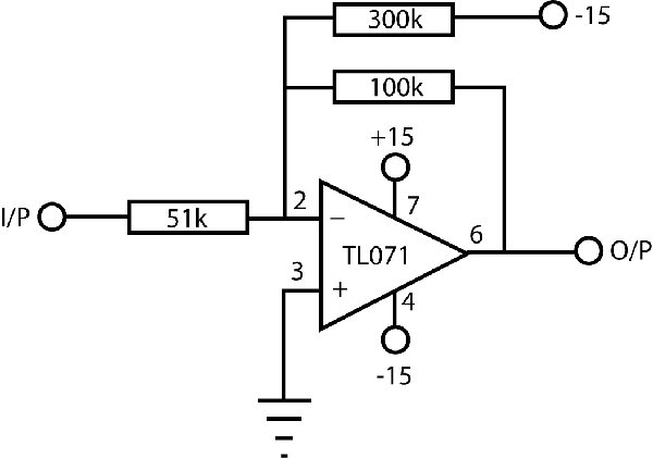

Yay!!! I tested my Dual Oddy VCO just now and it sounds fantastic and tracks great (I used a 2k tempco from MFOS).
I remember reading hear that the outputs of this circuit are 5v p to p, right?
When I put it through my Buchla 291, the signal was very low. I'm guessing the 291 wants 10v p to p.
How do we increase the signal of the Oddy VCO? Is there a resistor that can be replaced or something?
I've been trying to figure out how to do this, as well as centering the output around 0, but unfortunately I'm a bit out of my depth when it comes to these things! I've been reading up about DC offsets and amplification but I'm a bit lost when it comes to implementing. If anyone has any ideas then I'd be really grateful too!
Hi Eric,
I think this is what you want. I've lifted this from Thomas Henry's Build a Better Music Synthesizer - it's from his CEM VCO design. He used it on the Triangle output (which is also 0-5v PP) to convert it to 10v PP centered around zero.
I haven't tested it, but in theory it should be fine.
BTW, I've just taken a look at the 4023 VCF PCB foil I posted... definitely the same version as I've used to build my own VCF's. I wish I could be more help - could you PM some high rez images of your board to me, I'll see what I can do.
Andy.

Andy, thanks so much for that! Being a bit of a beginner, I've had a hard time figuring out how to do that!
If I wanted to use that on the saw output (which is 0-6v), would it just be a case of changing the value of the 100K feedback resistor?
Yes, I'd change the 100k resistor for a 51k and then follow it with a 50k trimmer to allow the voltage to be adjusted back down to 10v PP.
You may find that it's not *exactly* centered around zero, though it'll probably be fine for general use - otherwise I *think* you would need to change the value of the 300k resistor slightly.
