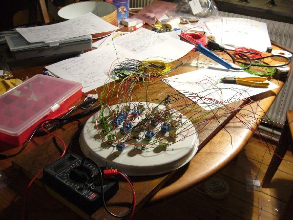

So I've made a second attempt at doing a SoundLab (ordered two PCBs a couple years back), and once again I am enjoying the silence as I hook it up. This time around I noticed that the batteries became to hot to touch, so I checked the resistance between + and - and it's something like 25 kOhm, which I guess is too little. So, a short somewhere I am guessing.
The first question is: will this have broken some component on the board?
Second: any other experience with short circuits in a SoundLab? Is there some position on the board that is more prone than others for shorts?
Third: should I take up knitting instead? (I actually saw this low resistance between + and - early on while doing the VCOs, since I've painstakingly measured the contacts of every component directly after soldering it. My procrastinating brain told me I could deal with this later - the logic of a moron).

Never mind! Very Happy I pulled out the wires from the front panel and resoldered them again, component by component, checking each in my new scope as I finished it. Now I got sound! too much coffee
Everything's not sounding exactly as I thought it would, and the envelope is really really slow, but this is as much of a success as I ever hoped. Wohoo! Very Happy Very Happy

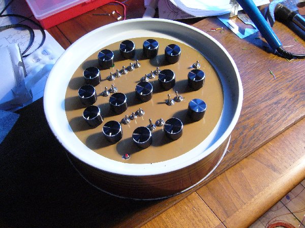

Anyway, I fixed the envelopes - misread 500 Ohms as 500 kOhms (duh!). It's sonic mayhem here! The LFO is doing stuff it probably shouldn't do, but I like it so I'm going to leave it as it is. Only thing left fixing is the noise generator, but I rarely use those anyway...
Attaching some pics of my patented crows nest soldering technique, the finished item (built into my mother's cookie can) and a sample. Can you tell I'm happy I finally managed to pull off (sort of) an electronics project? Very Happy

The silence (and most of all really hot batteries) was solved by desoldering all the wires from the lid on the board, and the resoldering them more slowly component by component. So I started with the wires for the batteries and the VCO1. When I had those on, I hooked the scope to the output from VCO1, turned the thing on and looked at the wwaveform, which looked like an ok sawtooth with a little spike at the top.
Then I did the VCO2, and checked that in the scope, then the filter, EG, Noise, LFO and the rest. All the time feeling the batteries to see if they were going hot, which they never did. After a bit of headscratching and some small fix I had the thing making sound.
I still a bit confused about the EG. Ray says in his specific troubleshooting tips that I should se 8 or 9 volts at pin 1 of C2 and the ground, but I only see like 1 volt. At first I thought that was why the envelopes were so slow, but I traced that to the resistor mentioned earlier - it's still a low voltage there, but it works just like I would think it should: a clear envelope ramp wherever I try it out (VCAm VCO etc), with reasonable values for time and amplitude.
