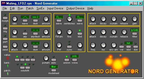

... To answer your question about disabling the Expression Pedal completely, unfortunately you can't. There's 6 options: Off, LFO 1 Amount, LFO 2 Amount, Filter Cutoff Frequency, FM Amount and Oscillator 2 Pitch. When set to Off, the Expression Pedal duplicates the Mod Wheel. So in actual fact, Off does not mean off.
I use a work around, not very nice, but when not using LFO2 (which isn't that important if not set to the Arpeggiator) I press [2xArp] and LFO2 is disabled. After [Shift+7xSpecial > E.of] I scroll to [E. 2] This means the Pedal controls the LFO Amount/Arp Range, which is disabled...
... I would only open it though with directions from someone who is familiar with it. Maybe Wout could help me with that. ...

No! What can I do with it? Just a little vibrato using Osc1+Osc2? Tremelo and Filter? In all three settings you won't notice one value more or less...
The Arpeggiator is something else, only, when the Pedal is assigned to the Arp Range, the Range itself has rather large zones, so a little more or less... Not audible, for sure Very Happy
I think it's only annoying when using the [Shift+LFO1-wave form] setting, where the values in the LCD screen will jump all the time...
So I want to be sure it's the Pedal or not...

Having trouble disabling LFO 2. I pressed Arp twice and LFO 2 is still enabled...
Wout Blommers
Joined: Sep 07, 2003
Posts: 4521
Audio files: 123
G2 patch files: 12
PostPosted: Tue May 05, 2009 8:06 pm    Post subject: Reply with quote  Mark this post and the followings unread
Are all the LED's going out in LFO2?
At my NordLead2 it works perfectly.
Can you disable the ModEnv, by pressing the destination button several times until the LED's are dead?
Wout
ilmolto
Joined: Apr 29, 2009
Posts: 26
PostPosted: Tue May 05, 2009 8:32 pm    Post subject: Reply with quote  Mark this post and the followings unread
No Sad
Yes Smile
Wout Blommers
Posts: 4521
Audio files: 123
G2 patch files: 12
PostPosted: Wed May 06, 2009 1:15 am    Post subject: Reply with quote  Mark this post and the followings unread
Maybe there is a difference in software between the NordLead2 and the NordLead2X...
I send you the SysEx file of a Program in the setting 'Muted LFO2'. In the picture you can see there is no destination in LFO2, so in the ModEnv. Download this file to your synth (I assume you are able to do this, I mean, using the right tools Wink) and look what happens. I'm curious...
If the Arpeggiator is already activated (LED) I press the Arp/LFO mode button only once, of course.
In the audio file the sound starts with a heavy vibrato by LFO2, switch to Arpeggiator and the second hit on the mode button stops the sound. Playing again there is no LFO2 anymore: no vibrato nor Arpeggiator...
Wout
A picture of the NordGenerator interface
 Filesize:  136.09 KB
 Viewed:  16759 Time(s)
Muting_LFO2.syx
The SysEx file
Download
 Filename:  Muting_LFO2.syx
 Filesize:  139 Bytes
 Downloaded:  139 Time(s)
Muting_LFO2.mp3
The audio file
Download
 Filename:  Muting_LFO2.mp3
 Filesize:  70.74 KB
 Downloaded:  449 Time(s)

I loaded the patch to my synth and just as you said, LFO 2 is bypassed. There is no LED lit at all, and if I tweak the LFO 2 Amount knob, nothing happens. I then enabled LFO 2 and tried to disable it, but it won't let me. Nice sounding patch though Wink
