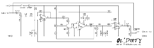

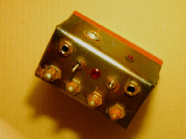

Ol' Dirty started out as a feedback experiment with an LM386 which ended up as a
dirty fuzz/distortion effect. No calculations where involved in the design of the circuit, just some experimental breadboarding.
I added the light because it just happened to lay on my table (left over from my dancing santa) and I don't think it really effects the sound but it looks great.
The old steel box I used is something I had welded a very looong time ago, and I used nuts as knobs.
more information, photos and maybe more samples will be added to my website, but for know here's the schematic, a picture and a sample. (some of you will probably recognize the tune Wink)
of course feel free to ask any questions,..
edit: I noticed that I had posted the (old) schematic that didn't have the switches in it. So I changed it to the version with switches.

here's some more info:
The circuit has an input level control pot. followed by an inverting amp (U1). And an inverting output amp (U3) which mixes the original sound with the distorted sound, followed by a volume control pot. In between these two amps sits the main distortion/fuzz/feedback circuit build around the LM386 (U2). The 100K pot. controls the feedback level and you can set it from little distortion, bursts of oscillation noise, up to a point where the LM386 goes in to complete self oscillation. The 4K7 pot is the gain control and it controls the amount of fuzzyness. The diodes are used for hard clipping to create the fuzzy sound and they also make sure that the ouput level doesn't get too high.

Hey PHOBoS,
That looks beautiful! How did you attach the knobs to the pot shafts?
Regards,
Joe
www.droolbrothers.com
http://www.youtube.com/watch?v=p-BUeD0zAjw
Posts: 5581
Audio files: 705
PostPosted: Wed Mar 17, 2010 10:01 am    Post subject: attaching knobs Reply with quote  Mark this post and the followings unread
thnx Joe.
I tapped M6 thread on the plastic shafts, put a bit of glue (2 component epoxy) on the inside of the knobs and then just screwed them on.

i guess this isn't just for line level input so i could also put in say a bass or guitar?
Well, unfortunaly i don't have a guitar myself so I can't test it. Usually guitar circuits have a higher input resistance (about 1M) and I think a guitar level is also very low so you need more gain. Therefore you would probably have to adjust the input circuit a bit. (you could also put an extra opamp before the input, or you could try this circuit)
I don't know if there's a volume control on the guitar but if there is the following might work: discard the 4.7uF cap. and 47K pot, change the 1uF to a 100nF and connect the input with a 1M resistor to GND. Change the 47K (connected to pin 2 of U1) to 220K and the 100K (connected between pin 2 & 6 of U1) to 1M. Of course you just have to test it for yourself to see what works, maybe you don't even have to change anything at all. Rolling Eyes
if i like to waive the lamp can i just leave it out together with the 10ohms resistor?
Well that's what i thought, so I just tried it to be sure and it does make a big difference. I did some more experimenting and you could replace the '10ohm + lamp' with a 22ohms resister (0.5W or maybe 1W) but it doesn't sound the same. So I would suggest using a lamp, which also functions as a very nice indicator.
I just fried the original lamp while I was testing Sad, but I do have some similair lamps. They are not exactly the same so the sound is slightly different now. The new lamp came from a 3V scanradio/flashlight. Since I don't have anymore data of it, I measured the current at 3V and it's about 200mA. I think you need something like this: http://www.conrad.nl/goto.php?artikel=727164 .
If you're not discouraged and do decide to build it I would love to see/hear the result! Cool
