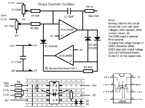

Another installment in my minimal modular series. This is a very simple sawtooth VCO. Barely more than half a dozen components and about one square inch of stripboard.
Designed to be easy to build, easy to understand, educational and fun. Runs fine on a variety of voltages (including battery), from +/-4.5V to +/-12V. +/-15V should be fine too, but I haven't tried it. None of the component values are too critical, so if you're building it by scrounging parts, pretty much any dual opamp should work, pretty much any diodes should work and cap and resistor values can be 50% either way without a problem.
Fun feature - touch pins 2 and 8 at the same time and the VCO will click like a geiger counter from the current through your body Smile
Tracking is more or less linear (V/Hz) with a range of about four octaves (two octaves either side of middle C). You can tweak the range either by changing C1 or R1 and R2. Not super accurate towards either end of the range, but good enough for making fun noises and in that central couple of octaves quite capable of being played melodically via a ribbon controller like this one http://electro-music.com/forum/topic-32651.html

If you want the output voltage level of this to match my other VCO you should use 1N4148 diodes for D2 and D3, and increase C1 to 22nF.
With red/yellow/green LEDs there it outputs a somewhat higher voltage, but is still okay for running into most audio gear. I used yellow LEDs in mine.
With blue/white LEDs it would output a higher voltage again and you would need to be careful about feeding its output directly into other audio gear (ie other than modular synth stuff). With blue/white LEDs you would probably also want to reduce C1 to 5.6nF or similar.

breadboarded it up super quickly
turned it on... and it worked first time
the circuit is very forgiving on values as he said
i switch the cap a couple of times to make it run in LFO and supersonic territories
right now the oscillator is giving me some subtle drifts which makes for a really cool effect when you use this VCO to FM a different VCO... lots of slowly morphing modulations!
now i wont to break out a quad chip and set up two of these above audio and see what unstable heterodyning fun can be had
thanks for posting this, it of course isnt a stable VCO but the instabilty is a great "feature" that makes this a great modulation source for other more "proper" VCOs

How come there is a +9v, a -9v, and a 0v ground? I'm not really sure how this would work

I have had some feedback from someone who breadboarded one of these with a TL082 and had trouble with latch-up (it worked fine when they swapped in an LM358). It could have been specific to their situation, but be warned that TL0xx opamps may not be ideal for this circuit.

One issue though, when i run the output to an amplifier with high gain, the sound comes through perfect, but when i switch it to a clean channel I get really odd behavior.
When tuning the frequency, especially when done moderately fast, i get this weird 'skipping' sound. In other words, it goes from a smooth, solid wave to a choppy intermittent wave (not waveform, but amplification).
Anyone experienced this or have any ideas?
I used 4148's for all diodes and schematic values except for changing C1 to 22nf and C2 to 100nf.

It might be this circuit need buffering/amplification, may be try different opamp, or something really simple, though I am noob, so don't rely much on my thoughts.

I've encountered some problems with the osc:
1. It is unstable in its scaling [or tracking, frequency instability was expected] (but I used ceramic disc caps, this might be the problem), but i use some software, which calculates ocs frequency and builds custom graph to play it. How to cure this problem (But I think its the caps) ?
2. When I connect osc output into CGS DC mixer, turning its corresponding level causes osc to change its pitch. Maybe output resistor (1k) has something to do with it? Or its capacitor in the osc? Also i used 358 chip for mixing, maybe higher quality opamp will cure it?
By the way i've used 104 (which is 100nf), and its a bit low. But i still get 3,5 octaves. If I put 47 nF it'l be higher an octave, right?

Mine is running on 15v with a TL082.... it doesnt track correctly though.
I used a 39k resistor instead of the 47k maybe this is the reason?
Also, would it be easy to add a Potentiometer for Frequency? If I replaced the 2 68k resistors with a dual gang pot maybe this would do the trick?

it already has a freq pot. two pots are shown; one can be wired as a CV attenuator and the other one can just be hard wired to V+ on the CV end and you have a freq pot.

Just confirming I have this circuit working with a LM358 on +/- 4.5V! Creating a virtual ground with the junction of two 100K resistors between + and - of a 9V supply.
