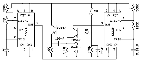

Testing Dr. Steve's 555 Circuit |
JovianPyx wrote: | I noticed that too - about the pin 3 to pin 3 connection... Also, it's not clear to me where power + is connected. Is it on the upper "bus" that connects the pins 8? |
yes, power + is connected to the topline in the schematic (which is connected to pin 8 )
Quote: | I see that in your second schmatic (PHOBoS) you have eliminated the right 555 pin 3 connection to the other pin 3 - yet in both of Steve's drawings, they are connected together. This connection would also appear to provide self mutilation of the right 555 timer. |
Since the second 555 got hot and it just doesn't make sense to me, I
removed that connection, It didn't really produce any usefull noise in this
configuration .
Quote: | It might be interesting to use a high input impedance opamp to get a signal from the timing capacitor(s). |
yes, that will give a nice sawtooth/triangle , I've actually used that with
transistors instead of opamps for fading LED's and producing sounds.
continuing from my previous post
I got some sound of it but only after removing the 220uF Cap,. (maybe
this is because I use BC547 of transistors)
So with the same components I came up with something that does
what I think the original circuit is intended to do. When the switch is closed
the 220uF cap is quickly charged which then (through the transitors) turns
the sound on. when the switch is opened the cap slowly discharges and
the sound slowly fades out again.
I changed the 4.7uF cap to 1uF since I like the sounds it produces at
higher LFO frequencies. I reduced the 220uF cap to 22uf for shorter
decays and I also made a slight change to get a line signal so I can
connect it to an amp.
posted below is the schematic and some sound samples.
(I'm currently using LDR's in series with the frequency pots and let the
setting sun control it. Excerpts will probably be uploaded later)

Posted: Sat Jan 15, 2011 9:54 am Post subject:
Testing Dr. Steve's 555 Circuit Subject description: CV control |
Next test: CV control.
Using a vactrol (LDR-LED combo) in series with the second 555 frequency
pot I was able to use a sequencer to change the frequencies.
I also made some further adjustments to the circuit.
- A couple of different caps to choose a different decay time.
(this was also suggested in Dr. Steve's second schematic).
- An extra cap to choose a higher frequency for the first 555.
- Resistors in series with the frequency pots so I can use the full range.
- A LED and an extra resistor to get rid of the soft noise when the circuit is
not being triggered. (This LED also functions as a very nice indicator)
- A simple trigger circuit connected parallel to the Trigger switch.
(before I just hooked up the Treequencer instead of the switch)
Posted below is the schematic and a recording done by using a sequencer
for both CV control and triggering the circuit. (and delay for the nice phasing)

Posted: Sat Jan 15, 2011 10:00 am Post subject:
The LED looks like it's drawn backwards... _________________ FPGA, dsPIC and Fatman Synth Stuff

Posted: Sat Jan 15, 2011 10:31 am Post subject:
I figgered that would be the answer, but I had to make sure... very odd... That means the LED conducts only when pin 3 of the right 555 is at ground potential, so the + end of the circuit is somewhere else. I see two candidates, the trigger switch through the 2.2k through the base-collector diode (which might not be a good thing for the transisitor)
OR
possibly from + to the collector of left transistor through it's collector-base diode and then avalanching the emitter base junction of the right transistor (????)... Very odd indeed. _________________ FPGA, dsPIC and Fatman Synth Stuff
Time flies like a banana. Fruit flies when you're having fun. BTW, Do these genes make my ass look fat? corruptio optimi pessima
Joined: Jan 14, 2010 Posts: 5581 Location: Moon Base
Audio files: 705
Posted: Sat Jan 15, 2011 11:41 am Post subject:
JovianPyx wrote: | ..,the trigger switch through the 2.2k through the base-collector diode (which might not be a good thing for the transisitor |
I think this could be the right answer. I just took out the left transistor and
100K resistor (so the Emitter of the first transistor is floating) and the LED
responds the same. Don't know if the transistor likes it,. but it works (for now ) _________________ "My perf, it's full of holes!"

The caps on the multi-switch might also be able to supply the + side of the circuit while they are charged. I'd bet the LED might change brightness when the cap value is changed.

JovianPyx wrote: | The caps on the multi-switch might also be able to supply the + side of the circuit while they are charged. I'd bet the LED might change brightness when the cap value is changed. |
well the LED reacts as follows: it flashes with the frequency of the first 555
between bright and dim and fades as the cap discharges (and the sound dies
out). Funny thing if I short the LED the sound barely changes (just doesn't die
out completely) _________________ "My perf, it's full of holes!"
