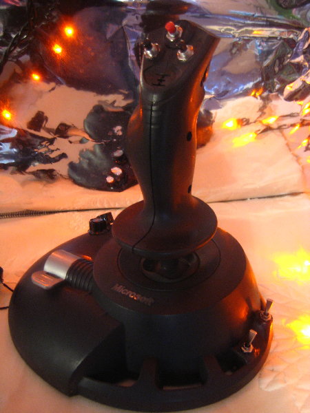

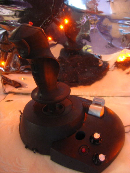

This is the first completed Prototype of a Synth Inventor and i have been working on. Inventor designed the circuit, and i concentrated on the interface.
Intuitive control of Music Making Machines has always been my priority. The smoother the interaction between man and machine, the easier it is to express feeling. Stopping to scroll through menus or turning lots of knobs sometimes interrupts the creative process. Not to mention the learning curve.
The Joystick is familiar to everyone, and everyone know how to use it. Push a button, something happens, push up on the stick, and there's an "up" action. This synth is no different.
--Stick controls -Pitch
--Grey Lever controls -Resonance
--2 Knobs on Base controls- Tempo and Tone
--Trigger Buttons on Stick control Various Modulation/Sequences and in the next version, Effects
--LED shows tempo
--Audio In Jack
--Audio Out Jack (in place of the original cord)
--Runs on 9Volt with plans to switch to rechargeable
--Entirely Portable and Self Contained
Inventor can explain the circuit, but i think he's already written about it here.
This is my first hand built synth, and i am Hooked (but very exhausted) shakng2 Got so busy, i forgot about Live48 (Yikes!).
Many Thanx for Inventor's Patience.
Here's pictures of it, and an MP3 of the first time i played it.
What do you guy/girls think?

1:11, I think you are a true visionary. It's such a simple concept, yet it does so much for the electronics. Rather than "building a box", which is largely what I wanted to do, you've intuitivized the whole control experience for the customer. And I'll mention one thing you told me: when you showed it to a test audience of college students, they went nuts over the thing! Well done.
As to the circuitry, only those who know me well will have pieced together the circuit, but everyone pretty much knows i'm all about the BS and KS circuits that make up this design. Now, actually it does not sound as good as the day it left the factory of my living room, I suspect that the loop filter is adjusted too small in time constant or something like that because it's very digital and glitchy compared to the normal KS sounds that I get. But that's OK, we can refine it or leave it as-is if folks like that 8-bit-ness that it has, slightly digitalized.
For a sample of something more along the lines of what can be accomplished in this product, see this thread:
http://electro-music.com/forum/topic-45997-25.html
And scroll down to my set. That's got a tripple KS which is more than we need for this project, but it shows another flavor of what can be accomplished in a game controller like this.
I also envision all kinds of synth sound packages as other product options for the consumers to enjoy.
In summary, I'll say that the only thing I don't like about working with 1:11 is having to keep my big mouth shut because I'm just filled with excitement and joy at all that is being accomplished and the potential of our ideas working together. So I'll raise a coffee toast to my new friend and business partner, 1:11, may we both enjoy the process and make the world a better place in some small way.
Les

How It Sounds
There's 2 MP3's posted above. Inventors is above, and mine is below the pictures. But let me try to put into words......
It seems to act like there are 2 modes, like when the circuit has more power going through it, the sound becomes heavy and saturated (much like the MS Series from Korg).
Then when there seems to be less of power running through, it becomes the opposite.....like an open air ringing moster echo thing.
i can't really describe that side...but it's rather unique in nature. A metallic, airy, echoey modulated bizzareness. This synth would be perfect for Monster Movies (and for my music)!!
The synth will switch between these 2 modes, and can do so quickly, creating strange pulses. You can hold on to either of these two states indirectly from the stick.
If you push forward to raise the pitch, the synth "pulses" into saturation, and becomes metallic. If you keep your pitch movements slight, you can hold on to the resonance and ride it for awhile.
Dropping the stick down quickly, you are able to have the same effect but at lower pitch.
To have the airy echoey metallic effect, you just let the stick go natural and wait for it to happen. Giving the joystick slight movements from center, you can ride that.
i prefer the heavy saturated effect. It sounds thick, gritty, and the triggers seem to work better.
The buttons are set to trigger various values in the Boolean Sequencer. i call em the "Bounce Buttons".
You can also coax a feedback ringing sound, a feedback squeal, that can be controlled by the stick. To To turn it off, or adjust how much squeel, you move the large grey lever on the base of the joystick.
Inventor has done a great job with this interesting circuit!! This synth is unique. While you're NOT going to be able to use it to make Glitzy Pop Hits, this synth is Perfect for what i like. This synth has it's OWN character that's unlike any other.
What i provided on MP3 in the first post, is the heavy saturation side i was talking about.
Inventor has demonstrated the other "side" of the sounds as part of his Shows/and above.

What a cool project! Smile Like many brilliant things, it seems so obvious now that you've shown it.

Ok, figured out how to control 2 osc's easily.
Most of these sticks have a hatswitch/secondary stick on top.
THIS will control the second Osc!!
