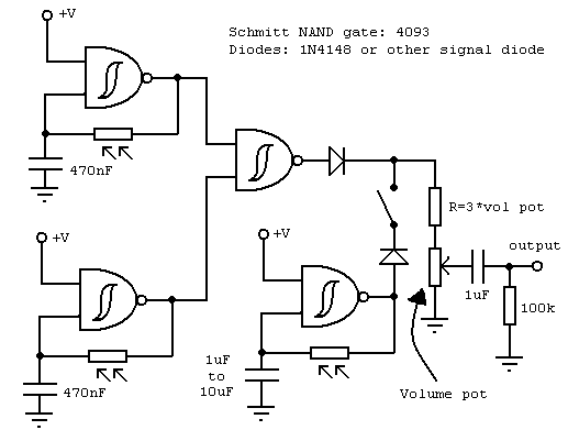

This is a really simple device, only using a 4093 chip and some diodes, but it makes a hell of a lot of fun sounds Very Happy
The key is heterodyning via one of the NAND gates.
Previous sound machines I have seen made with with a 4093 chip use each oscillator to gate the next. This is good for a start however, using that method you miss out on a lot of interesting phasing and timbral effects. For example if a 4093 oscillator is gated with a higher frequency than it is oscillating at, then only the gate frequency gets through to the output. The gate must be less than half the frequency of the oscillator which it is gating in order for it to activate/de-activate the oscillator and still allow it a burst of pulses between off/low periods.
I found that (for me anyways) it's much more interesting to combine two oscillators via one of the other two-input NAND gates on the chip, just listen to the sample! There is much more spacey and rich sound than you get from a chain of oscillators gating each other.
The diodes in the schematic act as an OR gate and the oscillator connected via the switch is an LFO, but it also goes into the audio range. This arrangement is used to gate the signal from the central NAND gate, giving you the bleepy sounds you hear at the very start of the sound sample and intermittently throughout it aswell.
I'll get some photos of the finished device soon, I made it pretty Wink
The output stage is the pulldown resistor for the diode OR gate, it may be an idea to keep the volume pot below 100k, the resistor above the volume pot is to lower the voltage to optimize it for use with an amplifier expecting a very low voltage- like a g

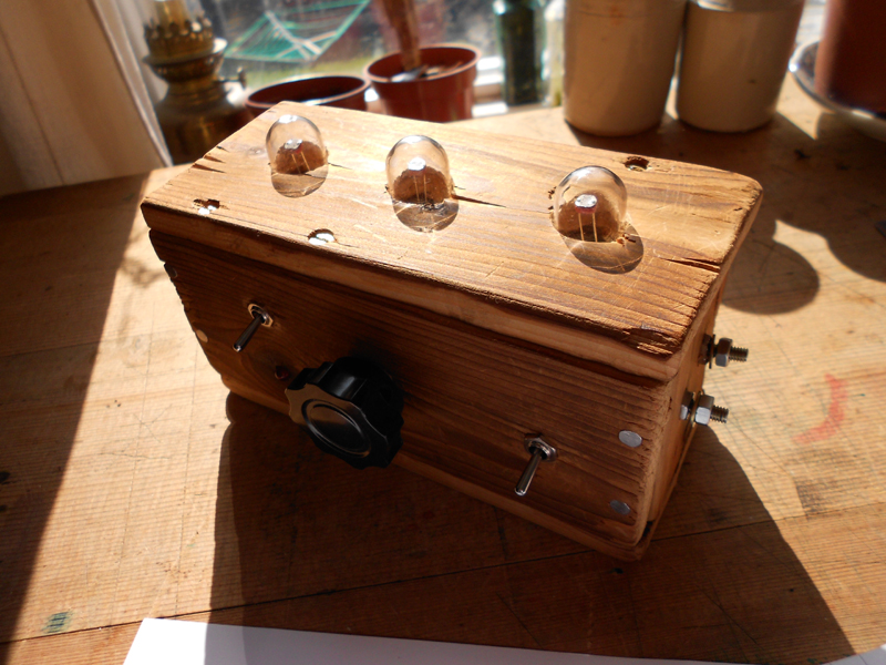

Photos!
EDIT: and videos!

Sounds and looks nice, and the schema is simple too!
Are those test tubes? What's the glass over your LDRs?
JingleJoe
Joined: Nov 10, 2011
Posts: 789
Location: Lancashire, England
PostPosted: Mon Mar 26, 2012 11:08 am    Post subject: Reply with quote  Mark this post and the followings unread
Yup Smile I cut some test tubes in half with the hot-water bottle cutting method to construct those hyper-proximity field deflectors, preventing damage to the light sensors and looking snazzy too! Very Happy

I have previously used these LED lenses but I think your test tubes look very nice!
And I just learned a new method to cut glass... thanks!

A note on construction of the LDR holders:
As backing I used card painted black and cut larger than the tube diameter, I made two small holes for the LDR leads, then hot glued the LDR in place.
In hindsight I would have liked to crimp the leads to the card with copper wire or staples as when soldering, the hot glue melts. As long as you do one lead at a time, with a delay to allow the glue to set again, then it works okay.
I glued the tubes in place at the back/inside side with a liberal amount of epoxy which allowed the LDRs mounted on card to be affixed by epoxy aswell.
