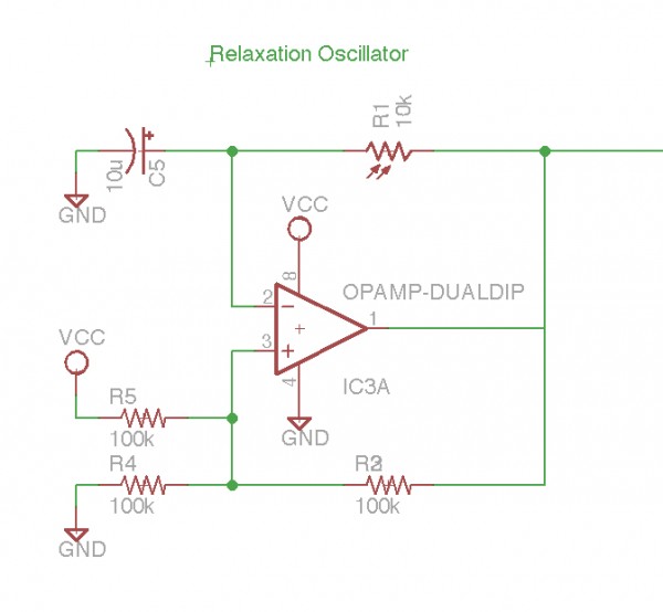

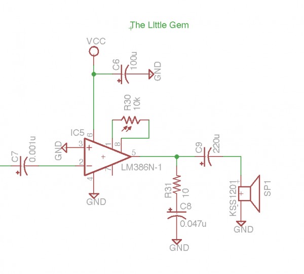

PostPosted: Mon Apr 02, 2012 11:58 pm    Post subject: Reply with quote  Mark this post and the followings unread
ask and ye shall receive, drapdap! Here are close-ups of the current, simplified design. I found some problems with my previous design so I scrapped it and created this simpler one. The design works as follows:
1. Relaxation Oscillator
This is a classic square wave oscillator whose frequency is controlled by the light incident on the CDS cell. The tempo will increase with decreasing light.

4. The Little Gem
This is the simplest of the LM386 speaker drivers. The speaker it drives is a special cone-less device that turns whatever you mount it to into a speaker, in this case - the case!
As mentioned previously due to the solar power cell, CDS cells for control, and special speaker, the entire music box can be mounted in a clear Sparkfun case and selaed to become a stand-alone fully solar music box.
Critiques and suggestions are very welcome!
Les

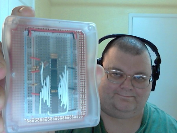

PostPosted: Wed Apr 18, 2012 8:56 pm    Post subject: Reply with quote  Mark this post and the followings unread
OK folks, here is the constructed prototype minus the output stage. I have made a few design changes, but first let's talk about the physical construction.
The box is a Sparkfun clear project case, which i truly enjoy working with (on two projects now). The red board is a printed through-hole prototyping board which mounts in the case with perfect alignment, dividing it into a top and bottom section. I am not using the board to solder parts onto, but rather as a structural element. Adhering to the top of the board is a small breadboard that fits nicely with chips, resistors, and wires in it (no caps in inventory yet). On the flip side (not shown) is just barely enough room for a 4.5V solar cell designed for Sparkfun.
So in the physical situation we have a nice tightly packed arrangement showcasing a breadboard with chips running down the middle and the noticeable white wires on the sides. The use of the breadboard instead of soldering into the protoboard allows me to easily make design changes, which I have done a few times.
Electrically we have power from the solar cell with intentionally zero power conditioning circuitry such as bypass caps (might add those later) for maximum weirdness in the sound. The 8 pin opamp chip at the top has a relaxation oscillator with LDR (CdS cell) frequency control on the right side and an incompleted output amp on the left (more later on that). Then we have my old friend the CD4040 counter with a 12 bit output + clock in is 13 bits of counter bus, or 8192 step sequence. The third chip (on the bottom of the photo) is a CD4531 parity encoder chip which is pretty much just a giant 12 bit XOR dealie with a separate XOR input for odd/even parity.
Rather than wire the parity chip as shown above in the schematic, with bit 0 goint to bit 0 and so on, i put bit 12 (the MSB, or most significant bit) on the even/odd parity control and assigned all the other bits including clock to the remaining 12 inputs according to physical proximity on the board. This makes the board neat and clean instead of the tangled wire mess it would have been, and also makes for a different sound than the pure parity would. This is because there are upper bits in lower places and lower bits in upper places, resulting in a scramble of the even/odd parity function which affects only the upper 1/3 of the bits as near as I can tell from the schematic.
Anyway so we have a boolean sequencer with light-dependet frequency control (brighter slower, dimmer faster) and a funky XOR output of one bit from all 13 input bits. This will go into the modified twin-tee bass drum analog section powered by the left half of the opamp chip. More on the twin-tee modification in the next post since this post is getting long.
Finally, I have decided not to use the speaker transducer thingie to vibrate the case for sound, and instead to have a 3.5mm (1/8") jack for headphone, computer, or mixer output. That's it so far, read on for info about the analog section.
Les

Here is a photo of the completed Solar Music Box.

I played around with the device and modified the circuit somewhat today. It definitely needs the light in the shade of a sunny day to operate. It's kind of like an optical Cracklebox in a way, though not quite as harsh. I can get sounds like motorcycle engine revving in direct sunlight and birds chirping in low light condictions. I will record a jam session with it tomorrow when the light is in my room by the computer through the window.
