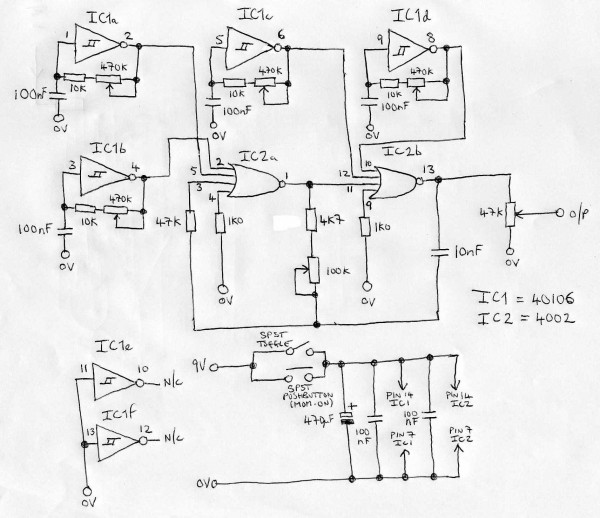

Here's a very simple idea that I've just tried using a 4093 and half of an 4002. It seems to make quite interesting noises... None of the component values are set in stone. You could try varying the values.
Bit of a short post as I need to rush off now.
Gary
AMENDED
I did that in such a rush that I left a couple of details out. I've now added these in red.

I've been playing a bit further with the idea, to try to use the other half of the 4002. If you put the same inputs into IC2b as IC2a, you will get the same signal out (a bit boring), so I've just used 2 of the oscillator outputs as IC2b inputs and left the other two at 0V. For a 4-input NOR gate, you only get a high output when all 4 inputs are low, so don't connect them to 9V or else nothing will happen! I've then used 2 pots and 2 diodes to mix the signals from the outputs of IC2a and IC2b. The diodes were added as without them, if you turned one output to fully off, the second one also cut out. The 2 outputs do still affect each other, but in more subtle ways. I could also have used 3 oscillator inputs plus one pin to 0V on both NOR gates (but choosing different combinations of 3 from 4 on each, if you see what I mean). If you have 6 oscillators from a 40106, the possibilities get even more interesting (e.g. Oscillators 1, 2 & 3 plus 1 input to 0V on IC2a and oscillators 4, 5 & 6 plus one input to 0V on IC2b). This may possibly give better results.
I've also increased the power supply capacitor from 100uf to 470uf and added a couple of switches to the 9V supply input. With the toggle (or slide) switch closed, the circuits works as before. With it open, you can press the pushbutton for a short period (turning the circuit on) and then release it (turning it off) and then you get interesting decaying effects. That's why I put a bigger capacitor in, as they last longer, the bigger the capacitor value is.
Anyway, it's still very rough at the moment, so there's definitely room for improvement. I'll do a recording tomorrow and post the results (I'm now very tempted to try the 40106 idea above, as it may have more potential).
ANOTHER AMENDMENT
Forget the diodes - use capacitors. They give better results.

I've not been too impressed by the results of my mixing experiements, so I haven't posted any more sounds yet. I can confirm that the first circuit does work just as well with 40106 oscillators. Remember that any of the unused inverter inputs should be connected to 0V (e.g. pins 11 and 13 if you use the first four inverters as oscillators). If I come up with something that does sound impressive, I'll let you know what I've done.
Gary |

The circuit (first one) you came up with is nice, but (and I didn't want to mention it ) it's the same as when you
would use some diodes to mix the signals together, except that the result is inverted (which you won't hear) and maybe
there is a difference in amplitude.
The second one adds a bit extra with the level control,. but probably not a whole lot. Of course there's nothing wrong
with it, but using diodes instead of the NOR's is probably easier.

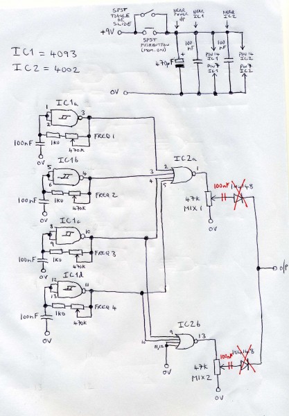

Hmmm. Not sure that it does anything too different, but here are a couple of mp3s and the schematic I tried out. The inputs of the 4002 are shown in the kind of random way I connected them. It shouldn't make any difference which round they are. The second file uses the pushbutton followed by decay.
See what you think,
Gary

analog_backlash wrote: | Hmmm. Not sure that it does anything too different, but here are a couple of mp3s and the schematic I tried out. The inputs of the 4002 are shown in the kind of random way I connected them. It shouldn't make any difference which round they are. The second file uses the pushbutton followed by decay.
See what you think,
Gary |

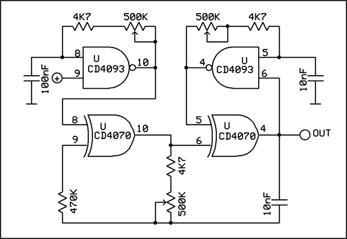

Is it different sounding then other multioscillator circuits, hmm probably not too much. But it works and you got
some nice sounds out of it
I didn't have any 4002's, and no 4001 either. So I used an XOR instead .
It works different than a NOR of course, but I wanted to try it anyway. I did get some stepped (APC like) sounds
out of it, and it behaves a bit weird. The breaking up is not a bad pot it just does that
so here's the schematic and a demo.
