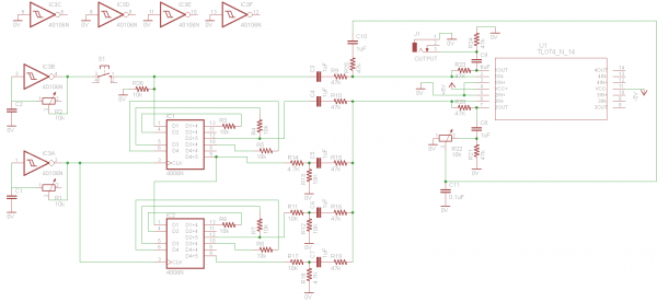

I had this idea for a while, but just got around to testing it out tonight. I used two 4006 shift registers to create a digital delay line. It works well with lunetta devices because it can only output square waves, but you can try it with other sound sources if you want. It might sound a little odd though - like the delay is being overdriven.
The attached sound demo starts with just the source waveform, and then I turn up the level of the reverb. Then I play with the pitch of the source. Lastly, I adjust the rate of the delay.
Here is the basic run-down of how it works.
A clock drives two 4006 shift registers. The rate of the clock is essentially the delay rate, but at the same time it is also the sample rate so things can sound a little odd at times.
The shift registers are all set up in series so the output of one goes to the input of the next. This creates a long delay line that spans 36 steps across the two chips.
The input of the first shift register is the sound source input. In my schematic, it is a 40106 oscillator with a momentary switch. That can be replaced with any sound source that goes above the chip's input threshold. Note the need for a pull-down resistor at the input.
I then tap the shift register outputs at four different points. The earliest point has no divider, and the rest have an increased voltage division as they go down the register chain. This makes the first tap point the loudest, and the last tap point the quietest.
All four tap points are mixed with a TL074.
The mixed delayed sounds are sent through a voltage divider volume pot and mixed with the source sound. Adjust the pot controls the level of the reverb.
I also added a 0.1uF cap to ground after the level pot to remove some of the harshness in the reverb sound. This is entirely optional. I like my reverb a little bit warm. I found it makes it sound more like it passed through an actual space, and masks the fact that it is just a repeating square wave of decreasing volume.

PostPosted: Mon Feb 25, 2013 6:37 pm    Post subject: Reply with quote  Mark this post and the followings unread
redrawn the schematic a bit (and removed the 10K resistors between in- and outputs of the 4006) Cool

Posts: 3652
Audio files: 550
PostPosted: Mon Feb 25, 2013 6:52 pm    Post subject: Reply with quote  Mark this post and the followings unread
Looking at the schematic again now and I think you can remove the two 1uF caps between the opamps, because you're using
a dual supply with a real GND. And you can remove the 47k resistor to GND aswell.
