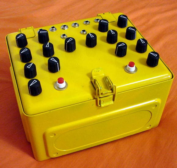

finally i got it in a decent case...
so here are some pic´s of my Dual DS7 clones - -
just need to ad labels to knobs
sound samples are soon here also
daniel

PostPosted: Tue May 30, 2006 10:18 pm    Post subject: Reply with quote  Mark this post and the followings unread
Uncle Krunkus wrote:
I'm thinking I might have a go at one of these DS7s myself!!
on stripboard maybe ? that would be so cool. I'm a fan of your boards.
talking about girlfriends - after i build the DS7 my girl wanted to build the noise source for it - and she did a great job. now she wants to build the DS7 Smile ... soon we need two soldering stations ...
here is a blurry pic of Ray's Multi Noise and Random Gate/Trigger Generator
