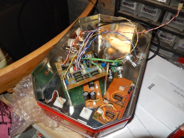

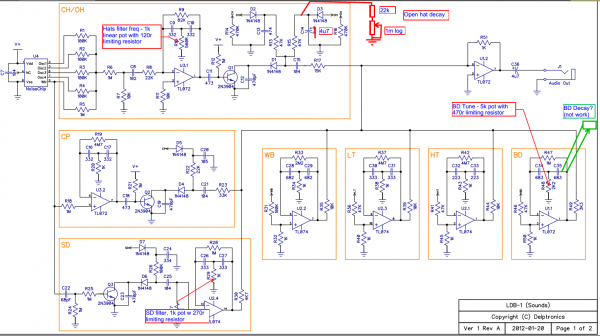

So i finished up my LDB1 drum machine, and am now getting into some mods.
Richard c64 has been kind enough to give me some pointers, but thought id share what id got for discussion.
Ive attached a schematic showing what 'works'. EDIT updated to v2
edit:dont fit the '1u' cap, it doesnt work and kills the voice
OH decay is straightforward, and is as richard c64 has described in detail before (electro-music.com/forum/topic-55928.html). The same could be done for the closed, but wires and space are getting ridiculous so ive omitted.
The hihat filter works reall nicely, used a 1k pot. Would prefer a bit more range, but...
A lot of these circuits seem quite unstable, by virtue of their simplicity.
I tried to repeat the filter on the CL and SN, but they didnt work. Seemed to just oscillate. I tried the simple 'double the original value' for the pot, but have since tried a 1k* pot, which seems to work a lot better, albeit reduced range.
The Kick pitch is determined by r48, and doubling this to a 5k pot worked really nicely. But again, using 2k pots on the LT HT and WB didnt work. Maybe my 2k pots are ropey Laughing need to try 1k* pots later.
Another odd thing is there is some significant background noise/hum. guessing its either the wiring, or the 'wrong' value resistors.

C12 is a mighty strange place to affect OH decay, Ben. Why there, and not at the E.G. formed by C14, and D3?

whoops. you're quite right, that's where it is .
Schematic is wrong. Doh
Ill update it when i can.

I have fixed the schematic based on richard's correction.
Thanks.

ok, well major improvement in signal to noise. i replaced an opamp, whcih i actually now suspect wasnt seated correctly, and increased the size of the PSU decoupling caps, and the noise is loads better!
Also got Thomas Henry's impact sound generator working for the snare, which really adds a nice snap to the start. thank you very much mr Henry! cant post the schematics but theyre in the drum cookbook, which is well worth the money imo.
edit theyre the ones in the bass++ - a good read incidentally.
Have also got a tunable woodblock filter working. Replace r34 with a 1k pot, or a 2k with 2k in parallel. Just a 2k resonates.
And variable closed hat decay, changed c13 to 2u2 with the same pot configuration as the open hat.

One thing that is really confusing me is the grounding situation. From a standard 9v source, Mickey uses a TLE2426 rail splitter, which makes a 'virtual' ground halfway between V+ and 'ground' (Mickey calls 'ground' V-).
So the audio output is referenced to the virtual ground, so presumably oscillates +/-4.5v. So when i connect it to the output, isn't that referenced to 'ground' (i.e. V- in mickey' terms). Is that a dc offset of 4.5v?
So when i connect my little distortion pcb which just has V+ and ground connections, i.e. 9v, do i connect this to V+ and 'virtual ground', or V+ and V-? The dist pcb just creates a 'virtual' (wrong term i know) ground using a resistor divider like typical single supply opamp circuits.
But then all the 'ground' are floating anyway, as its powered from a (regulated) wall wart.
Any help figuring this out would be greatly appreciated. Its confusing the heck out of me!

I....er.....yeah.
Laughing
it was only going to be a temporary enclosure while i figured out all the mods. now im wondering if it is worth rewiring all those switches yet again....
Smile
 Filesize:  210.46 KB
 Viewed:  116 Time(s)
 Filesize:  191.08 KB
 Viewed:  107 Time(s)
 Filesize:  249.42 KB
 Viewed:  108 Time(s)

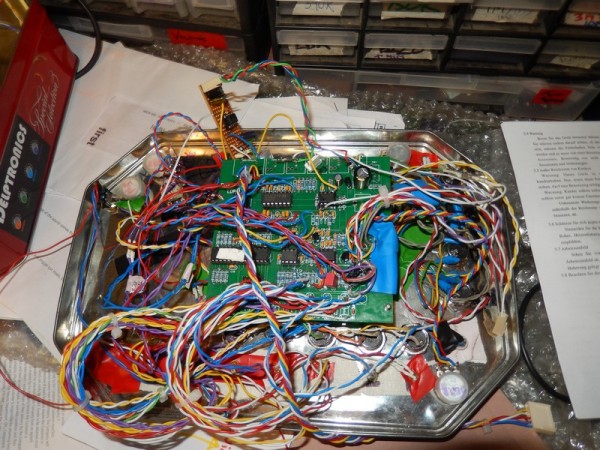

OK, well one of those nights Mad
Realised id wired up the mixer completely wrong (+ input to opamp instead of negative).
Broke several wires moving the pcbs around
Finished up the HC2 but 3 of the voltages are wrong
So lots of frustration for no gain.
I really make the most work for myself with these projects. Sometimes im so jealous of the eurorack kits with no wiring.
But im stubborn enough to keep going Laughing will be the best little drum machine, built to my needs.
Excuse the monologue!

[grunt]
My suggestion for Bass Decay was based on the Resonance control of the WSG filter, which puts a pot in series with the cap at the ( - ) input of the op amp. (C34 in the LDB.) Although I'm not sure it makes a difference, if I said to put it in series with C35, I apologize.
Another possibility is to put a cap -- as much as 1uF -- in series with a pot in parallel with R47. The range of Decay may turn out to be small, and there'll likely be interaction with the Tune pot.
The sample above sounds real good, Ben.

Hey richard
Thanks for replying again!
Still not used to smiley spock!
Yes, i was trying with a pot between C35 and the output of the opamp - not a bother. Assuming i did it right, it really didn't work - just got constant filtered white noise.
I figured out my mistake finally by looking at the filter on your 110 page again - R11 is resonance. I have some 2m pots so was going to try to swap R47 with that (and add a limiting resistor). But also have another option to try now.
Many thanks! Decay on the BD (and maybe toms) was my last 'mod' desire, rather than just chucking in more pcbs and more wires Laughing
Work and family are all a bit hectic now, but i will give these a shot when i can.
Many thanks, Ben
I missed this first time round. Please dont apologise! Youve been more than helpful ever since i started building !
I actually double checked the examples you sent and they do seem to suggest either side would work.
Ive wired up the pot and cap in parallel now so just off to test. Also figured out why id blown the tle which is nice. wiring it up like the data sheet seems to work much better Laughing
Cheers, all the best.

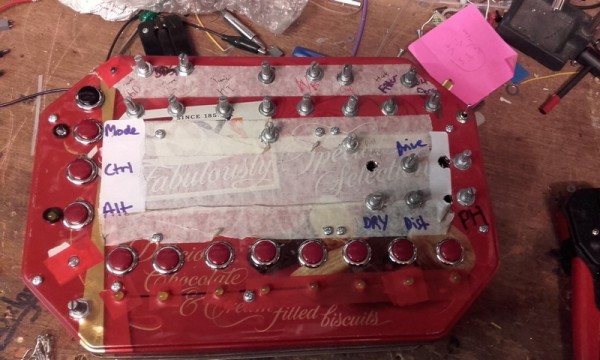

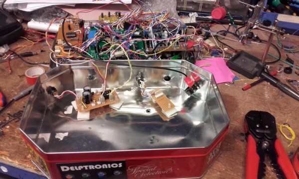

Alas, didn't get a chance to try last night, but did take a couple of quick phone snaps.
Im quite proud of the ways its been installed - all pcbs and pots on the 'front panel' and the other gubbins in the tin, so easily separated. Relatively easily, that is. It seems to be a trade off between too many wires, and no room for manoeuvre.
Bank holiday weekend this weekend!

OK. So bank holiday turned into a bit of a family/boozey holiday, so not much progress.
Blew up a 330uf cap installed the wrong way, fecking loud! Most impressive noise ive got recently Laughing
Digital noise from the clap PCB works as an alternative noise source, but is quieter, think i can boost with a couple of resistors (non-inv buffer). Might try it on a pot as well.
The decay mod above (pot+cap) kind of worked, it affected the pitch a lot; and didnt seem to go much longer, only shorter. Hard to hear on my crappy speakers tho. Cant hear much in the low range, so will try to record. Getting the basic tone to go longer, with the same mods would be fine.
Ken's drive mod didnt seem to do a great deal. Maybe try 3x diodes in series, or abandon.
But the main issue ive not got is hum, seems to be grounding related. aS I feared Mad Mad
Trying to cobble together these 'fake' ground circuits is proving troublesome.
The LDB1 uses a TLE2426 rail splitter, which works fine for itself. Ive modded it far beyond its intentions so cant complain. As im trying to add additional opamps, i thought Id add an additional tle for that, as it only has a 20ma current output. But i need to connect the grounds together to make the hum disappear/reduce. As they're based on the same 9v supply, i thought the ground(s) would be the same. Connecting these shouldn't be an issue. BUT;
The handclap is then based on the ground being created by a 5.1v zener! (asymmetrical) Yet another ground! If i connect all these together, somethings going to go wrong (?) two at 4.5v and one at 5.1v.
But surely im only connecting via patch leads internally, as opposed to external patch cables? as in if it works in the real world, it shoudl be ok wored internally.
I could remove the zener and the other resistor and use the other grounds as the ground, i guess.
As it stands the clap wont mix into the LDB1s mix in, at U1 pin 6.
Can i ask a couple of super basic queries while im here;
Ive assumed that the output of the mixer (u1 pin 7) is a 'buffered' output, so i can connect multiple outputs? I have 3 wires coming out now, after c37, feeding the mixer (dry), phaser and distortion. Do i need to buffer these further?
Also, ive only used a single wire from the output, should i use screened signal + screen cables? I was trying to avoid connecting the grounds... if so, grounds at both ends or just one?
Are stripboard mixers and that amount of wires always going to be intrinsically noisy? So hard to tell if 'normal' or wrong.
So still a long way to got.
Many thanks
Ben
