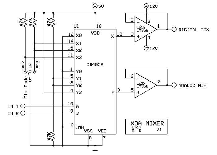

Posts: 5868
PostPosted: Sun Apr 08, 2018 4:01 pm    Post subject: Reply with quote  Mark this post and the followings unread
welcome party!
It depends a bit on how you are using it but you can probably get away with a passive resistor mixer for your purpose.
Diodes do indeed work too but give a different sound. You can also use different logic gates to mix the signals together.
(using diodes is the equivalent of an OR gate, although can also be used as an AND gate) You could use the XOA mixer for this.
you can find more info about it here.
note that you don't need the dual supply for the opamps and you could use the same supply as for the APC's. Ideally you'd
use rail-to-rail opamps for this but since these are digital signals it probably doesn't matter much. If you want to connect it
directly to an input of a mixer/amplifier it would be good to add some
attenuators between the multiplexer (U1) and the opamps.
