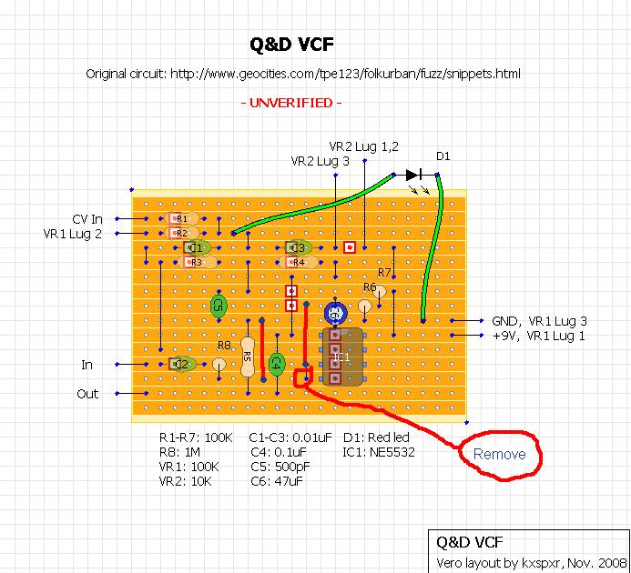

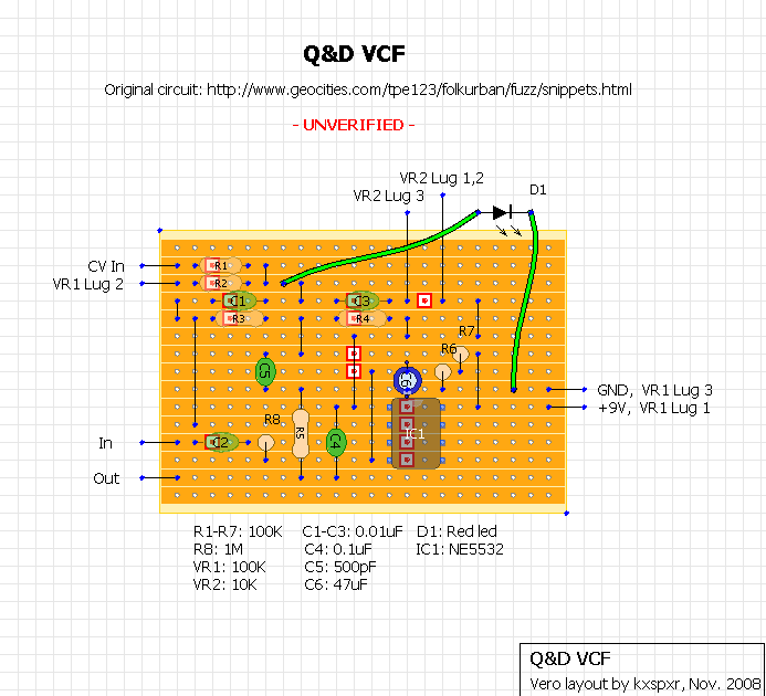

Hi all,
I made a vero layout of the Q&D voltage controlled filter which can be found here: http://www.geocities.com/tpe123/folkurban/fuzz/snippets.html
- scroll down approx. to the middle and it's the first one of the filters.
However, it's not working. By "not working" I mean there is no response to turning either pot. When I turn it on, the input is gained a bit though. I used a 1M pot on the input. Just didn't include it on the layout.
I have stared myself blind and I can't seem to find the error. Anyone got a better eye than me? Any help is deeply appreciated!
We've all been there...
I haven't gone through everything - the schematic has no component or pin numbers, which makes it a bit tedious to relate to the vero. Perhaps you have a schematic that is numbered like the vero?
However, the first things I see is that VR2 lugs 1,2 are connected to R3, R4 and C5, i.e. it's connected to one more resistor than shown in the schematic. And, R4 seems to be shorted out by the link 4 holes to the left of it.
DJ

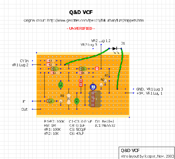

Arggh! Why didn't I see that? R4 is shorted on the layput but not on my "real" board. Sorry about that. I have modified the layout a bit and decided to resolder the whole thing.
Before I do that, perhaps somone will have a look at the layout? I included the schematic with matching component numbers.
Good - that's much better - still miss the pin numbering on the NE5532 though Smile

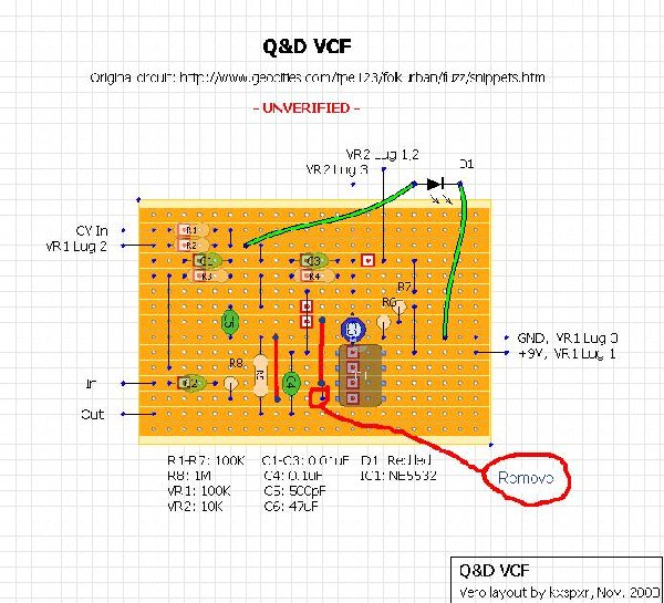

The next thing I can see is that the link connected from C6 to pin 4 of the NE5532 should really be connected to pin 3 of the NE5532. That is a bias voltage which is meant to keep the +input midway between GND and VCC, i.e at 4.5V. Then pin 4 of NE5532 needs to connect to GND.
I have attached a modified layout, with two red links, and a comment to remove the old link between C6 and pin 4.
Remember, I may be wrong, and there could be something else... Wink
DJ

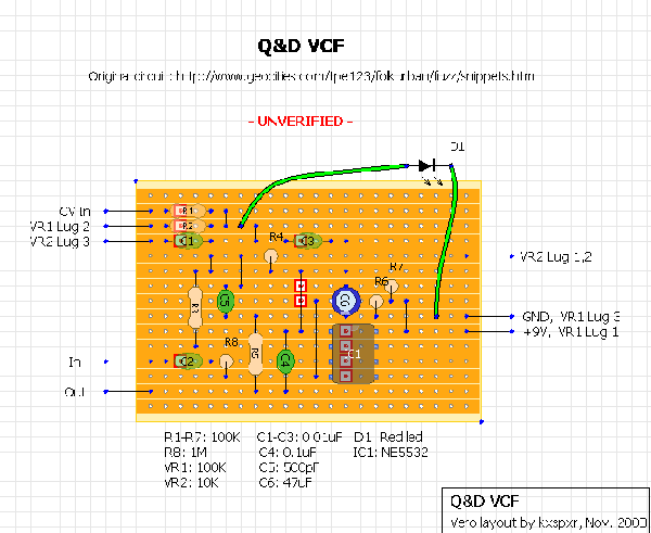

Thanks a bunch! I thought the bias was supposed to connect to GND of the chip (pin 4), making it a virtual ground. But it makes pretty good sense that it should connect to the + input of the opamp (pin 3). The headroom will be greater if I power it with two 9V batteries and omit the voltage divider section on the powersupply, right? I'm still learning..
Sorry, forgot to include 5532 pinout -here it is along with a corrected layout. Again, thanks a lot for your help! It all makes perfect sense now.
That's right! Taking GND and the bias voltage from between the two 9V batteries. You still need the current limiting series resistor on the bias voltage. So, using a dual rail power supply we'd get :
Code:
    +------ +V (to NE5532 Vcc+ and VR1 lug 1)
    -   +--[R8]-- bias voltage to NE5532 1in+
    +---+-- GND
    +------ -V (to NE5532 Vcc-)
There's lots of fun little circuits on that link in your first posting - DIY'ers take notice. Let us know how it sounds when you have it working then Smile
DJ

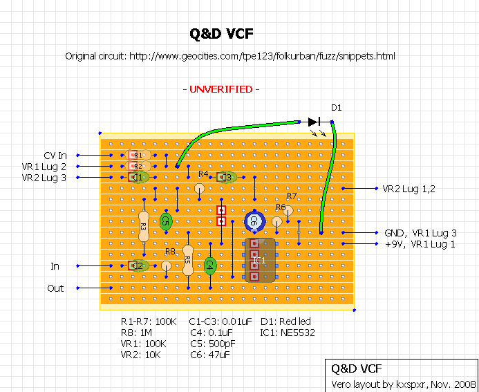

I am just about to solder it from the corrected design. As far as I can see, R8 should not connect to ground but instead to half the supply voltage instead. Connecting it to ground as shown on the layout makes a hipass with a cutoff of 100hz on the input. I don't want that, so I will omit the jumper from bias to pin 3 and connect R8 there instead. That would be right according to the schematic, right? As far as I understand, connecting R8 to the bias will give a current of 4.5uA on pin 3, provided a 9v power supply. My questions are (if I understand this correct) why do I need R8 and how do I choose an appropriate value for it?
I'll post my results as soon as I have them.

It works and is sounds quite neat. I only tried feeding it with a square wave. It's well worth the effort. I have updated the layout. This is the *right* one Smile
The led doesn't light up when I turn VR1. It doesn't seem to affect the overall performance of the circuit, however. I suppose it's because of R2. I used an ordinary cheap red led. Not super bright or anything fancy.
Ah, yes! I forgot that, but you caught it so now you're in control thumleft
Great - There's nothing like rolling your own!
Yes. With VR1 at the fully positive position, R1 and R2 will be in parallel and their total resistance is:
1/(1/R1+1/R2) = 50000ohm
so the maximum current through the LED is limited to :
9/50000 = 0.18mA
That's not enough current for the LED to produce much light.
However, the LEDs function in this circuit is not to produce light, but to limit the range of the frequency controlling voltage. A typical LED has a forward voltage drop of ca. 2V (varies with colour and type). That results in the voltage at the node where R1,R2,LED,C1,C2 meets always being at least 2V above ground. What you get from adjusting VR1 is a variable current source. (Please correct me someone, if I'm wrong!)
Edit: Aha! I see richardc64 was quicker than me Very Happy
Edit2: typo
Edit3: typo again Embarassed
DJ
