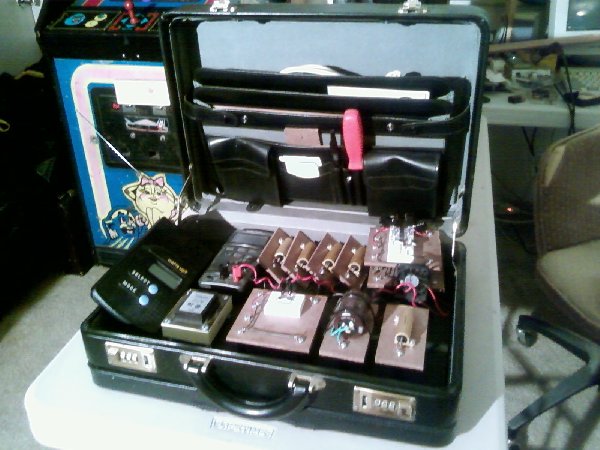

Here is a photo of the prototype that I made. I took a piece of wood composite board, I forget what it's called, but it's natual medium brown in color as in the photo. I made a briefcase insert out of it with some standoffs, then I drilled it for mounting all the parts.
To the left is the Wattmeter for measuring input power from the wall socket and the voltmeter that measures output voltage. To the lower left is the input transformer, the invention in a plug module, and a filter cap and load resistor on plug modules. I did the modular connections with banana jacks for a retro style and good connections. Along the top are some other modules that plug into the circuit.
I did a basic test where I put in a power supply diode and calculate its efficiency and then swap it out for the new circuit and again calculate. The new circuit is 7% more efficient than the old diode, if I recall correctly.
Actually the prototype is not ideal, it's just a demo and there's loss in the wires and the connections and such the way i made it, so the total efficiency is not that great, but what matters is the delta between the two rectifiers as far as I know.
Although the circuits may not be novel, I had fun thinking them up and proving that they work so I guess it was worth doing. I may post some schematics soon, so watch for new posts...

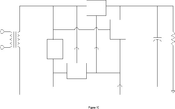

We can define the problem and get all cozy and familiar with it by looking at the familiar diagrams shown in the attached image. On top is Figure 8, the Half-Wave rectified linear power supply, and below is Figure 9, the Full-Wave rectified version.
There is one slight twist, however, the diodes have been replaced by a three-terminal block diagram symbol. That's the thing that has always been a power diode in the past. The difference is that I added a ground connection and called that three-terminal thingie a "diode replacement".
Studying the circuit for losses, we know there will be some losses due to transformer leakage and parasitics and some loss in the capacitor series resistance, but most of it is in the diode (besides the load, of course). Wouldn't it be nice if we could just plug in something and magically erase most of the diode power dissipation?
Well, we can. And I'll show you the circuit in the next post.

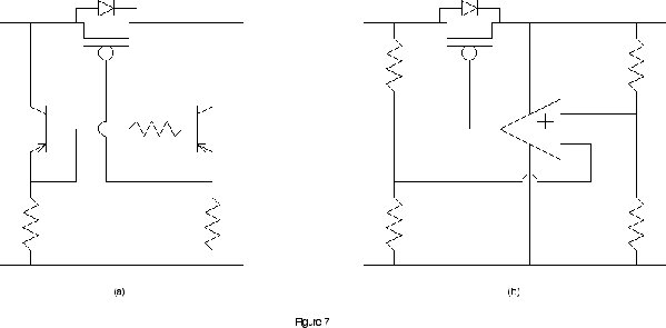

OK, here's where I show you the fun stuff. Take a look at the schematic images below in Figure 7 (a) and Figure 7 (b). The transistor-based circuit is in (a) and the comparator-based circuit is in (b). You plug either circuit in for the ideal diode block diagram of the previous post and it performs the diode's rectification function with much lower loss.
Of course, it's a different beast so it has different requirements, characteristics, and performance. The MOSFET has to be one of those "new" ultra-low on-resistance MOSFETs such as a good HexFET from International Rectifier. Also it's not too happy delivering anything below a +/- 5 V output, and it's really at its best with +/- 12 V. Then again, manufacturers are making power MOSFETs with lower gate voltages nowadays so I don't know but that may help this situation.
The way the transistor circuit works is the left transistor provides a diode drop to balance the diode drop of the right transistor, so when the input and output voltages are equal there is no current flow in the base resistor so the right transistor is shut off. This permits the pulldown resistor to pull the gate voltage down to zero, turning the MOSFET on. If the input voltage is greater than the output voltage, the base current of the right transistor flows into the transistor, shutting it off and allowing current to flow from left to right, pulling up the load voltage. If the input voltage is less than the output voltage, we want the MOSFET off, and we get that because a reverse current forms in the base resistor, turning on the right transistor which then shuts off the MOSFET. Alternatively one can think of that state as having the MOSFET be diode-connected in the reverse direction.
The way the comparator circuit works is more obvious to me at least. You want to compare the input and output voltages, so just compare them. The trick is, the way other patents did this was to create a separate little DC supply rail for the comparator. That's crude yet effective, but even better is the circuit of Figure 7 (b) since the comparator simply runs off of the output DC signal. The only trick is we have to divide down the compared signals to get them within the input range of the comparator, but that's easily done with resistors. Also, not shown is the hysteresis that I found was necessary when building the circuit.
These circuits will work in the steady-state condition but what about during start-up? At start up, the circuit in (b) has 0 V supply voltage on the comparator, so the comparator cannot drive the gate voltage reliably. We need some start-up circuitry to get things going. To do that, I just put a resistor to ground from the gate of the MOSFET in (b), pulling the gate down so the MOSFET is on when the comparator is out of commission. In both cases, the substrate diode exists to act as a standard diode during low-voltage start up.
The circuits aren't perfect, they do have resistors so there is some slight loss there. The MOSFETs are typically 12 V gate-drive parts, or at least the ones I was able to get a year ago, so they have greater on resistance when driven at 5V. But counterbalancing that is some good news: we can parallel these MOSFETs. They don't take much space so we can put a bunch of them on the circuit board if we want. They work just fine in parallel and their resistance will reduce to Req = Ron / N, where N is the number in parallel. Later I will discuss a situation where we put two MOSFETs in series and take a 2X hit on dissipation in order to gain functionality.
I don't know if the circuit described in this post is novel, but I created it about two or three years ago and it might have been novel at that point, not sure. Anyways it's probably been discovered by industry because it's so beneficial to power supply efficiency, and the trend of replacing diodes with MOSFETs is well known. Whatever.

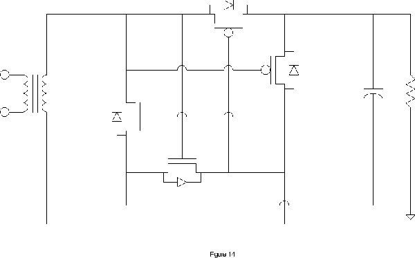

The previous circuits are useful enough, but what if we want regulation of the output voltage? Well, for that we need a reference, an adjustment, the output voltage and the input voltage. The circuit topology for one such example is shown in the attached image, Figure 11.
The four inputs are connected to open-collector comparators appropriately and the circuit works well. That is, including a few mods which I forget what they are, but they involve start up and hysteresis. Anyway, you can tinker with the circuit in Figure 11, but there is one limitation. The cannot drop lower than one diode drop below the input voltage. This is because of the substrate diode conduction in that situation.
To solve this problem, we can just connect two MOSFETs back-to-back as shown in Figure 12. Just put those two in place of the one shown in Figure 11 and the regulation voltage can drop below the input voltage.
