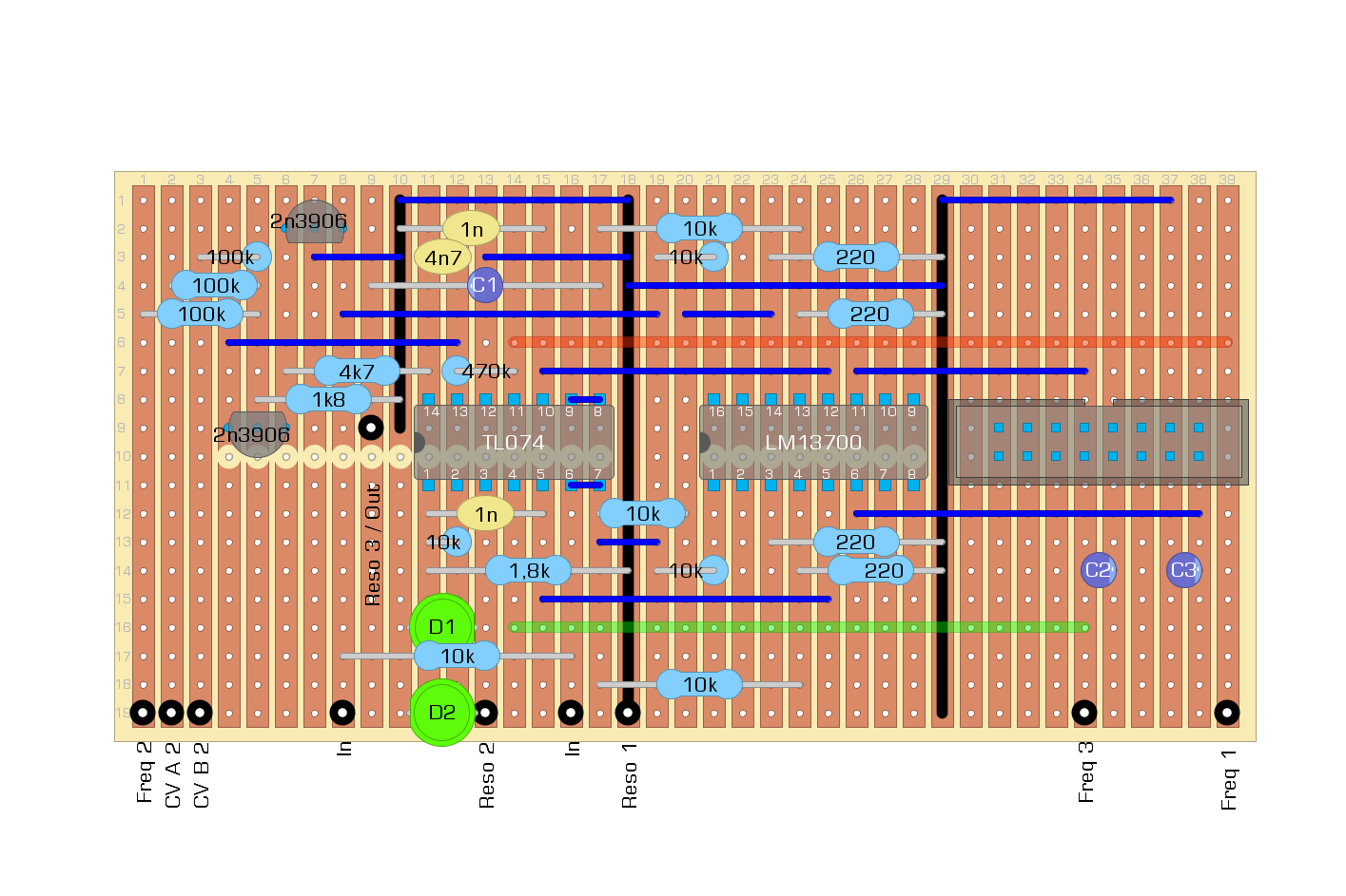

Hey, thanks for your reply!
I drew up my own layout from the original Schmitz-schematic (i generally like this more than jsut copying the stripboard layouts floating around so I can follow what I'm actually doing). I'll attach it below!
And yes, you're right: there seems not really much going on when tweaking the resonance knob. I already swapped the orenientation of both LEDS but it didn't seem to have an effect at all (makes sense, since they're supposed to be wired in parallel thus making not a difference in which comes first...).
There might be minor mistakes in the layout but I eventually solved them while buidling/ troubleshooting. Except the resonance part everything should be correct in the actual realisation.

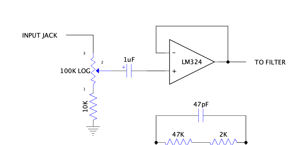

PostPosted: Mon Mar 29, 2021 1:32 am    Post subject: Reply with quote  Mark this post and the followings unread
Ok, scanning over it this morning on my phone I didn't pick up any glaring errors, but...
The first thing I noticed is a lack of power filtering. I don't know how critical it is for this circuit, but generally having a pair of caps (10u-47u) strapped across your power rails where they connect to the board is good practice. You should probably have decoupling caps (100n?) where power meets your chips for both rails.
Also, on my clone, I have slightly different values around the resonance amp. I actually have less gain there than you should, so I don't think that's the problem. When I hit mine with loads of signal, though, it won't squeal no matter what I do. Have you tried leaving the input disconnected and turning the resonance all the way up? I have a pot with a voltage follower in front of mine to make the input adjustable (see attachment)... with the original values used (100k from input to OTA and 220r to ground), it squealed like crazy but the signal level was too low. I think now I have a 4k7 resistor there (where you have 10k), and for the last 1/3rd of the the pot travel the input signal overpowers the resonance quite a bit. It is audible that I'm adjusting the resonance pot, but it's nothing close to self oscillation.

PERFORMANCE
Joined: Jun 11, 2020
Posts: 36
PostPosted: Mon Mar 29, 2021 2:13 am    Post subject: Reply with quote  Mark this post and the followings unread
Hey! Yes, I should really do that, I did on most of the other builds but didn‘t on this one for no reason - easy fix, though!
Regarding self oscillation: that‘s a thing I wondered about as well. It doesn‘t self oscillate but I‘ll switch a couple of resistors tonight and see what it does to the circuit.
Also thanks for recommending the input buffer - I‘ll simulate that with an attenuater!

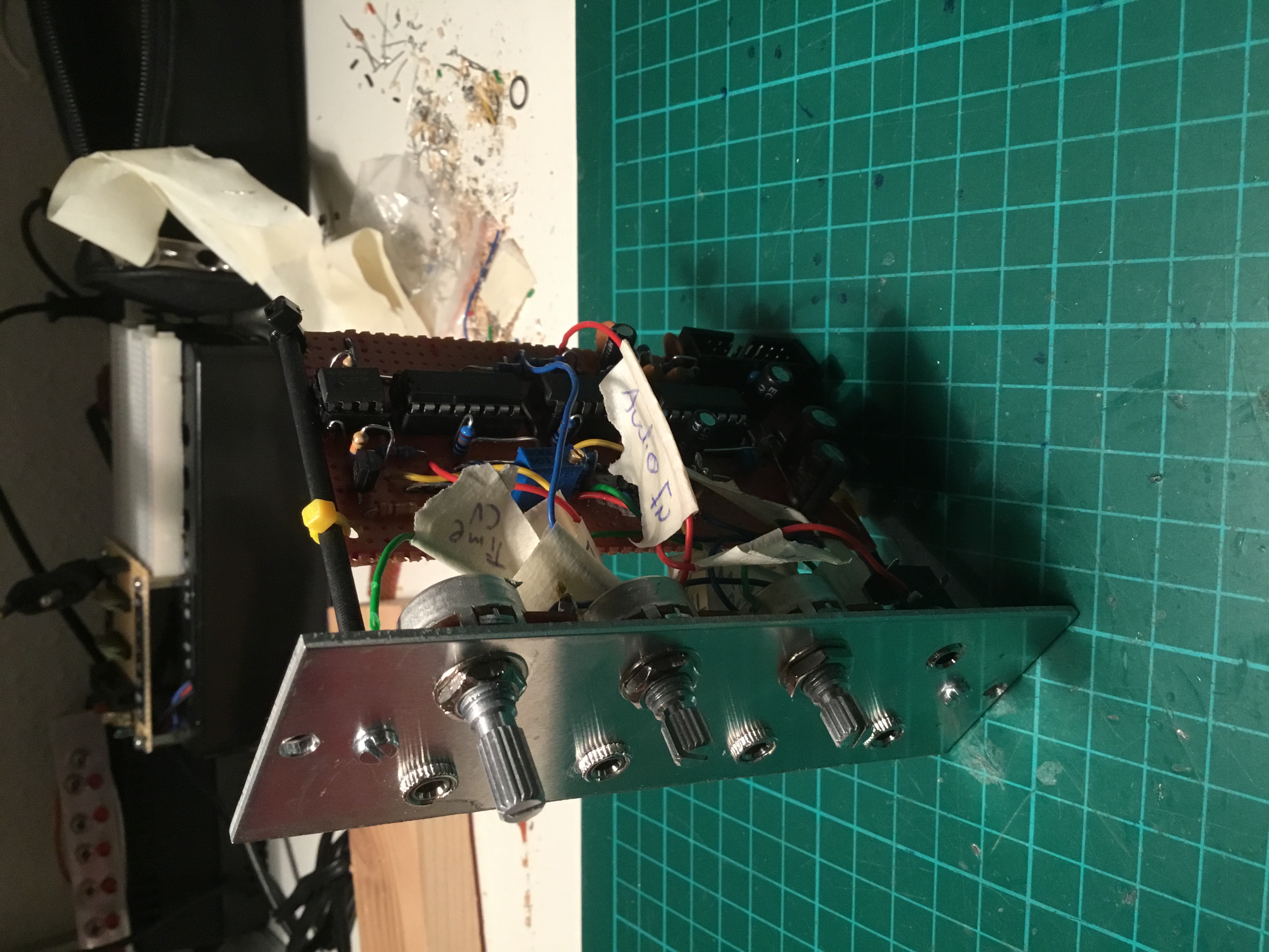

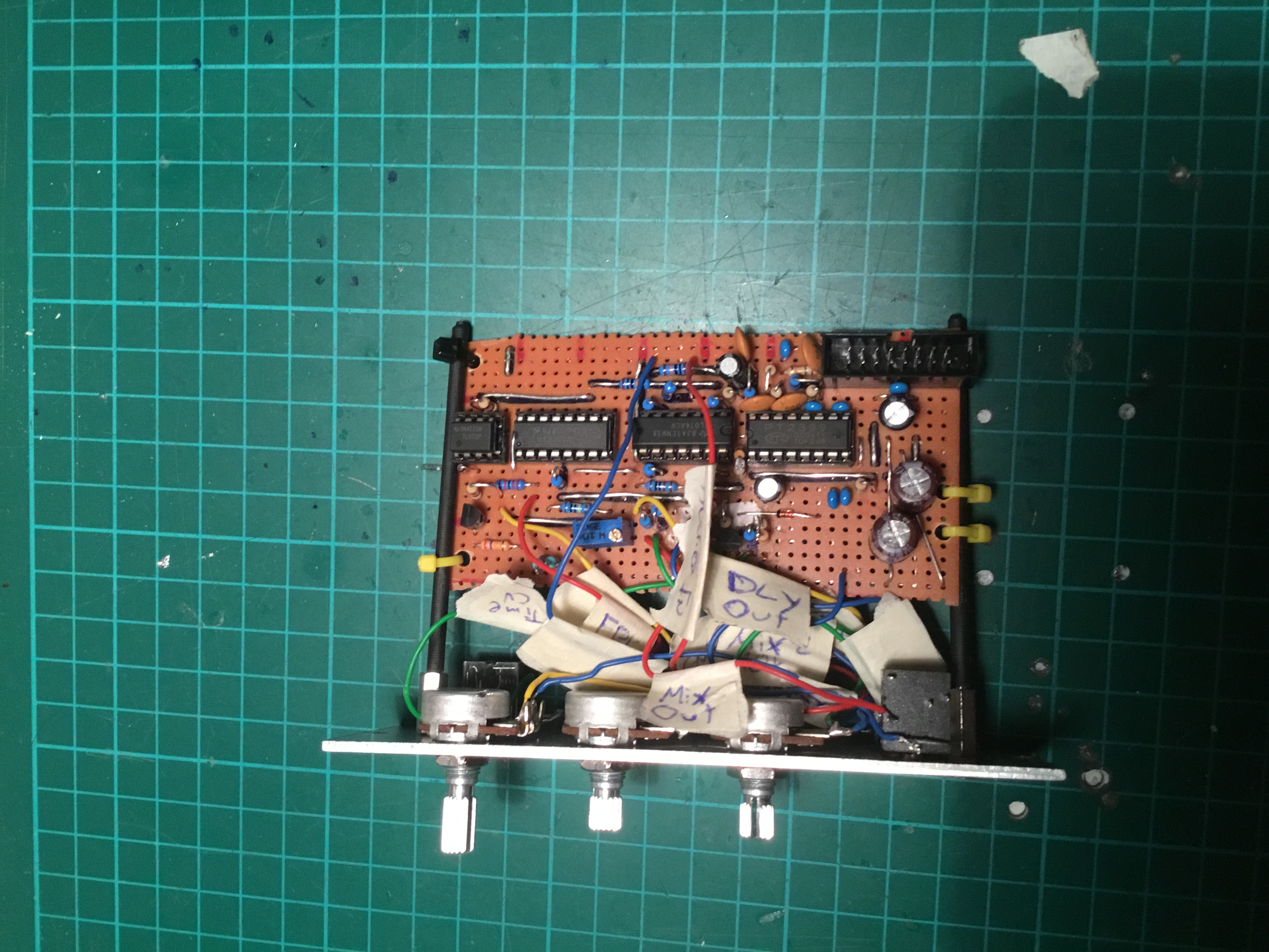

Hey!
Just wanted to show you my way of mounting PCBs - I think it's quite convenient and easy but is easy to dismantle.
These are M3 threaded rods screwed into M3 standoff bolts (counter fixed by M3 screws from the front panel). The rods themselves are covered in heat shrinking tube and the boars are attached onto the rods via zip ties. Great! It's really cheap but very clean and works great.
The module is a Scott Bernardi VC delay - it's not working yet but I've already traced a couple of (very dumb) mistakes I will hopefully solve soon.
