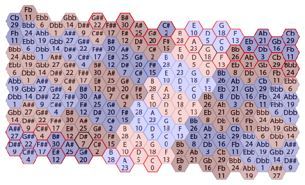

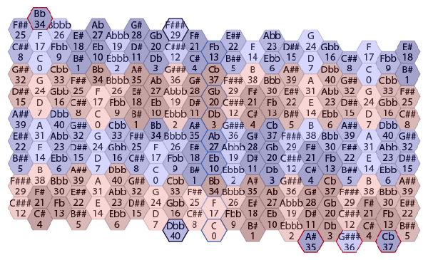

I've been working out key mappings of various scales to special keyboards, to decide how much they might help with the kind of microtonal work I'm getting into.
31 and 41 equal temperament both fit into the Hunt system (Tonal Plexus) which has built-in automatic pitch-bend retuning of your synth. Although the key colour coding is designed for 41 only.
Now for the Axis hexagonal keyboards. The whole point of this layout is that it's isomorphic - you can transpose by playing the same thing in a different place on the keyboard. You don't need to change your finger positions as on a piano to reach different sets of black and white notes.
I tried to find isomorphic mappings of 31 & 41et for this keyboard. Starting from C at the bottom middle; fifths going upwards; minor thirds up & left; major thirds up & right. But in both cases you don't get every note in every octave.
I've drawn it all out. The red & blue bands show the octaves and the light/dark code is for natural, sharp/flat, double sharp/flat etc. No octave band ever gets a complete set of all 31 or 41 notes!
Have I proved that it's impossible, or is someone going to find a hideous mistake in my working out? scratch

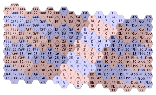

I found a different set of intervals for the 3 keyboard axes and tried those. Up = fifths; up & left = seconds; up & right = fourths...
41et is still unuseable like this.
31et seems to be fine now. Everything has sloped over a bit. The unbroken range goes from a D# (bottom left-ish) to a G (top right-ish) giving over 4 octaves. There are some notes above and below that range, which I've drawn round in red, but they're going to be very hard to use because of the gaps in the scale near the corners of the keyboard.
Some octaves have 5 or 6 notes appearing more than once, so it might be possible to get a couple more notes than 31 per octave without losing the isomorphic layout. But definitely not 41...

Not every mapping covers all notes. In your first you are skipping 18 and 10 steps which are both even, so you won't have any keys that are an odd number of steps from your starting point.
I can see you chose that to maintain the 5ths and thirds, and so that's what you got - a subset of the tuning that maintains those intervals in the mapping. Obviously, by retaining 5ths and thirds in the same positions, you are stuffing 31 or 41 notes into the same physical space as was 12 before and that just isn't physically possible.
The 5ths and 3rds arrangement kind of sucks anyway though.
There are dozens of mappings that work well for either of those tunings, and for any tuning for that matter.
Just pick one and work with it. That's what I do. In other words, pick any old mapping, starting with ones that cover all the keys. Then play with it and see where all the intervals are. Doing this, I find there are really no bad mappings with any given scale. There are only different arrangements.
Some mappings work well for some things, others for others. One consideration might be where the chromatic scale falls out of the mix, if that is a consideration for a piece.
As far as which keyboard, I like a velocity response, so I got the Axis. The Opal is another good choice. For a larger layout with more keys and velocity sensitivity as well, there are the Starr Microzones. He makes some square grid ones called Z-boards but the two hexagonal ones are the way to go, with either 288 keys on the U-648 or 810 keys on the U-990, depending on budget. One really cool feature about Microzones is the keys can be popped out and rearranged so you can have your own visual patterns appropriate to the particular tuning.

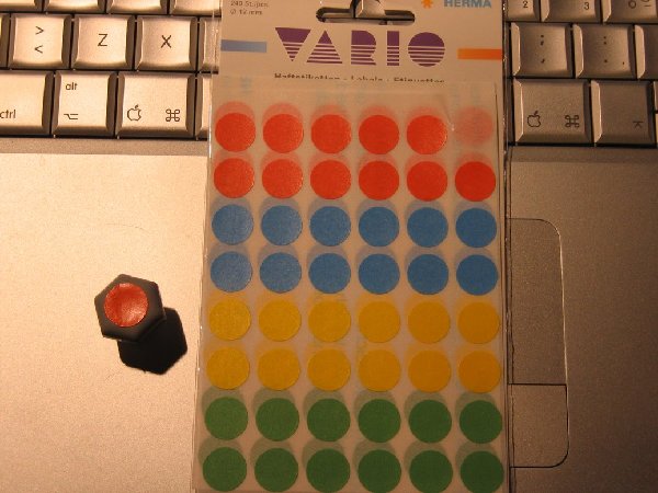

well...there ia a simpler solution I have already investigated Wink that's an hexagonal key with a round sticker I attached on it.
You can use stickers to visually mark pitches. Once you change tuning you can re-arrange the stickers Wink

I thought the easily removable keys thing was pretty cool. There had been an early Microzone prototype that used something like sticky tape and that had been criticized by one microtonalist who saw it. I asked Harvey about it and he said that was a long time ago and they now are in little rubberized recessions so you can just pop them in and out. Sounds pretty cool.
With the stickers and fixed keys, one would have to be peeling those stickers on and off all the time, and also the stickers would clash with the underlying color scheme of the fixed keys. That is unless someone did something totally crazy like have a custom build that was a solid color of keys so that the only color variations were from the stickers, but that sure seems like it would be a lot of trouble and then they'd have this single color instrument that would be kind of like one of those solid color jigsaw puzzles - something for only the most hard core of persons.

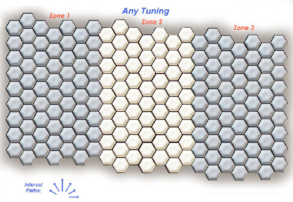

...That is unless someone did something totally crazy like have a custom build that was a solid color of keys so that the only color variations were from the stickers
that's exactly what I told Peter Davies to do with my Chameleon Shocked

...With the stickers and fixed keys, one would have to be peeling those stickers on and off all the time...
that is actually a good thing Shocked because I intend to "stick" to a particular tuning for a long time Wink
Surprised ...I thought there must be something right under my nose that I hadn't noticed! Makes perfect sense now.
The makers of Axis were selling that as a feature - I thought it might make basic tonality easier. Never actually played the keyboard though, so I don't know how useful it really is.
In the end I did find a way to get all 41 notes (isomorphic) onto the Axis or Opal keyboard. The vertical axis is now in 4ths, not 5ths. The other two axes are only 1 step apart, which reduces the diagonal slope so you only get 4 orphaned notes in the corners. The range is about 3.75 octaves.
Both of the successful mappings here use more than 128 notes, so you need a TBX tuning box, or anything that can map a scale across more than one midi channel.
The ultimate colour coding would be to have a combined red, green & blue LED behind each key, so you can set any key to any colour! Dread to think what it would do to the price though. Shocked Shocked Surprised Sad
Also with scales this big, I'm beginning to wonder whether the notes you need to play together to make a chord, are now getting so far apart that there's less of an advantage to the isomorphic layout anyway...
