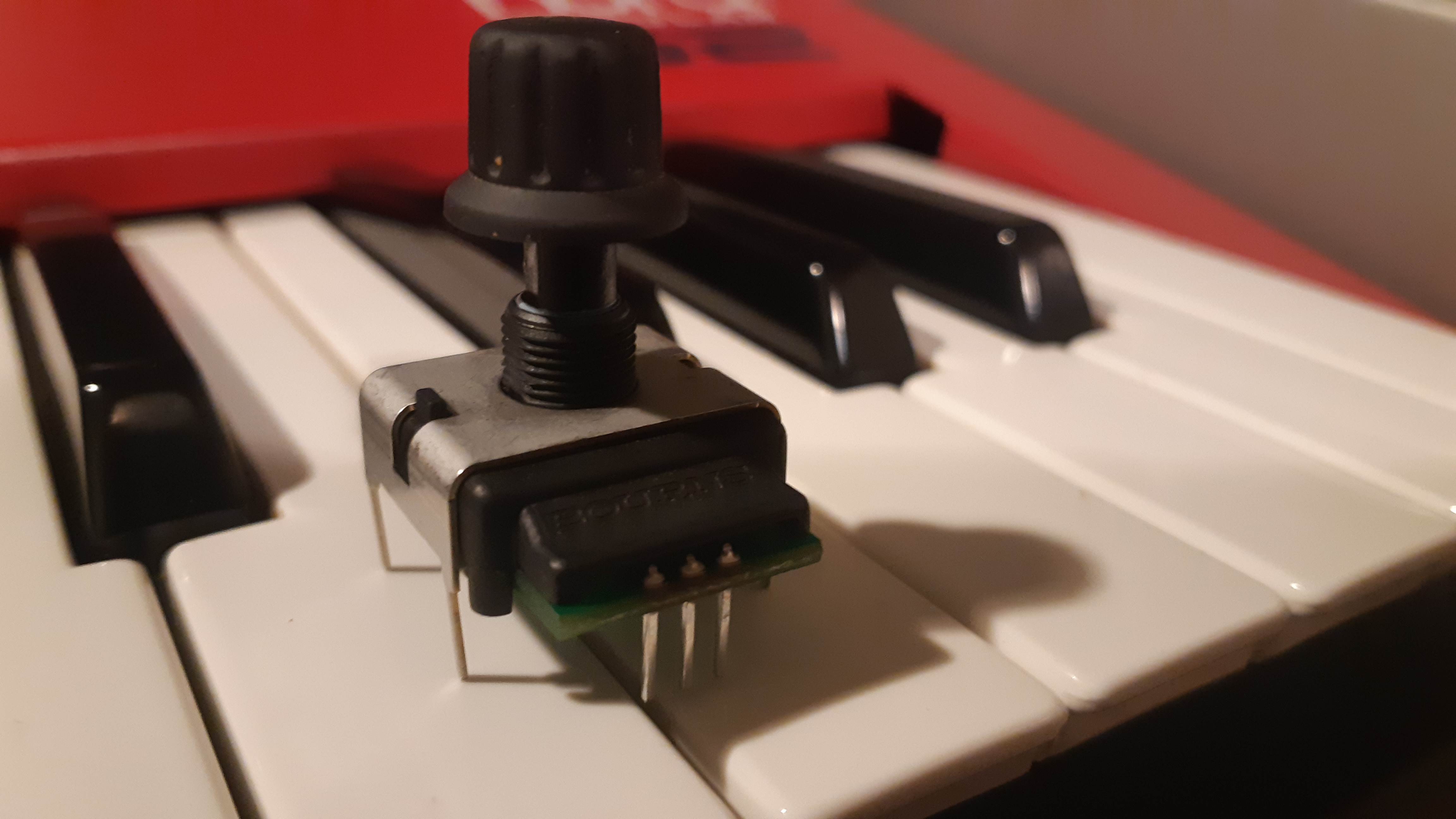

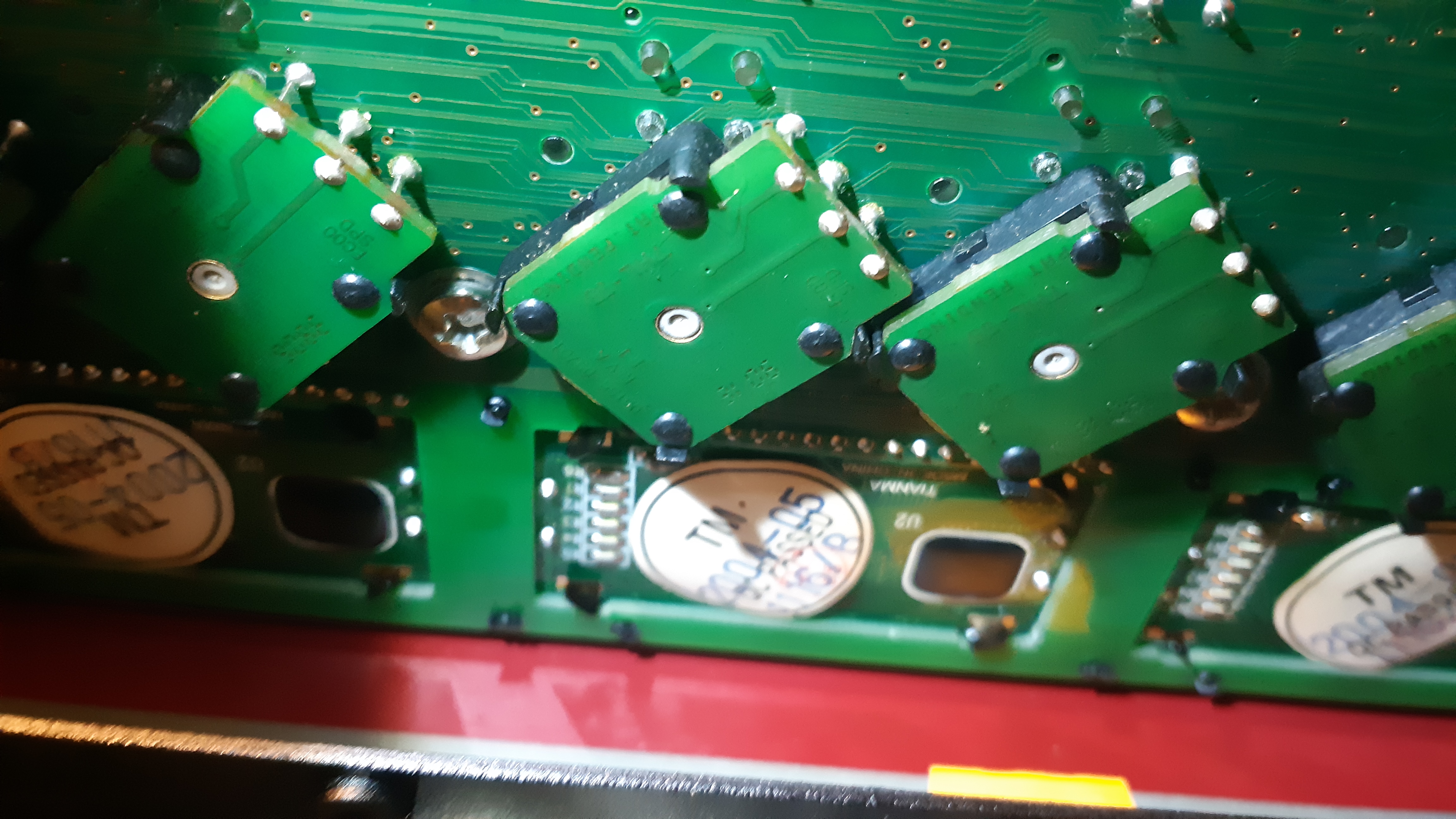

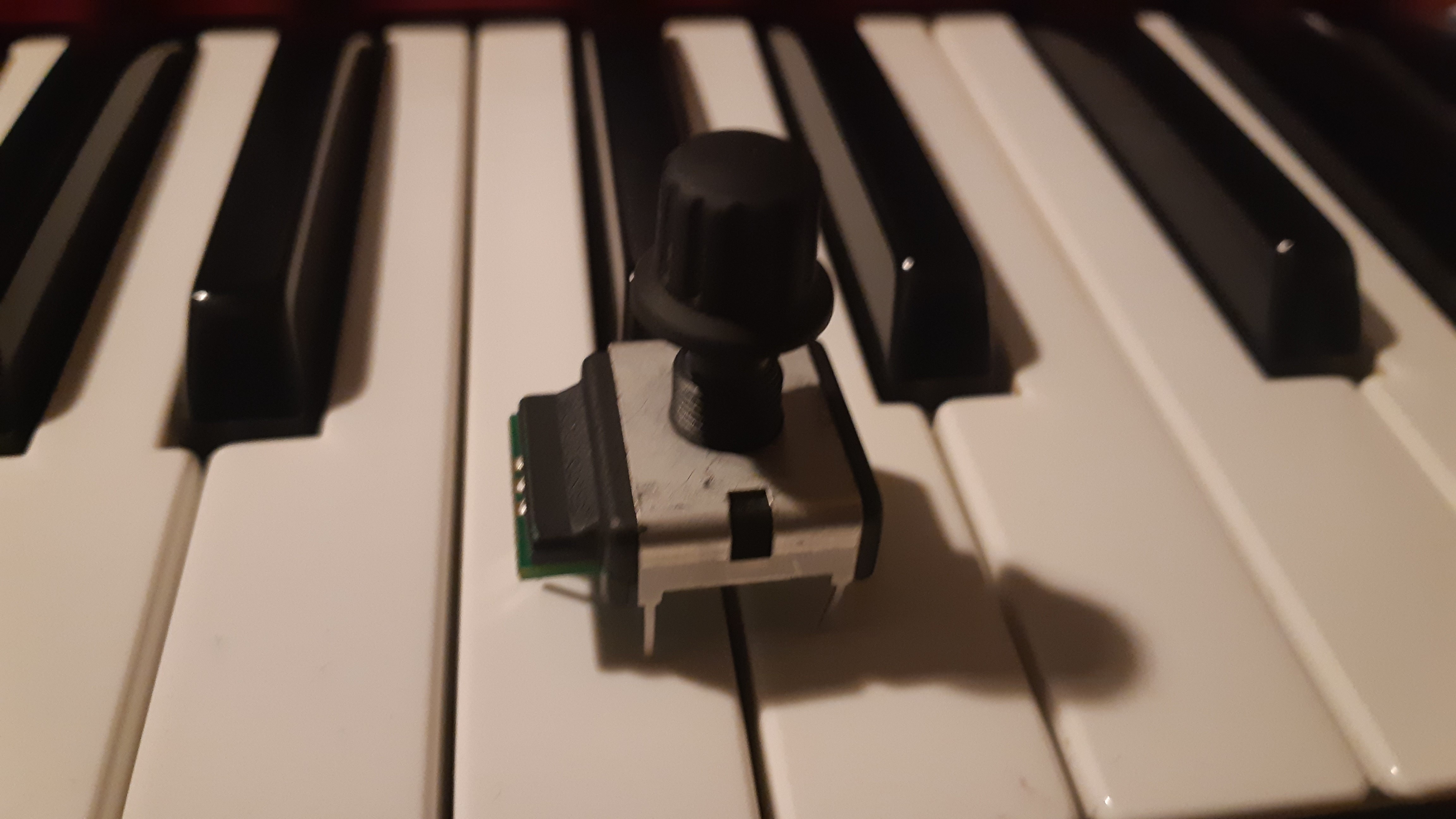

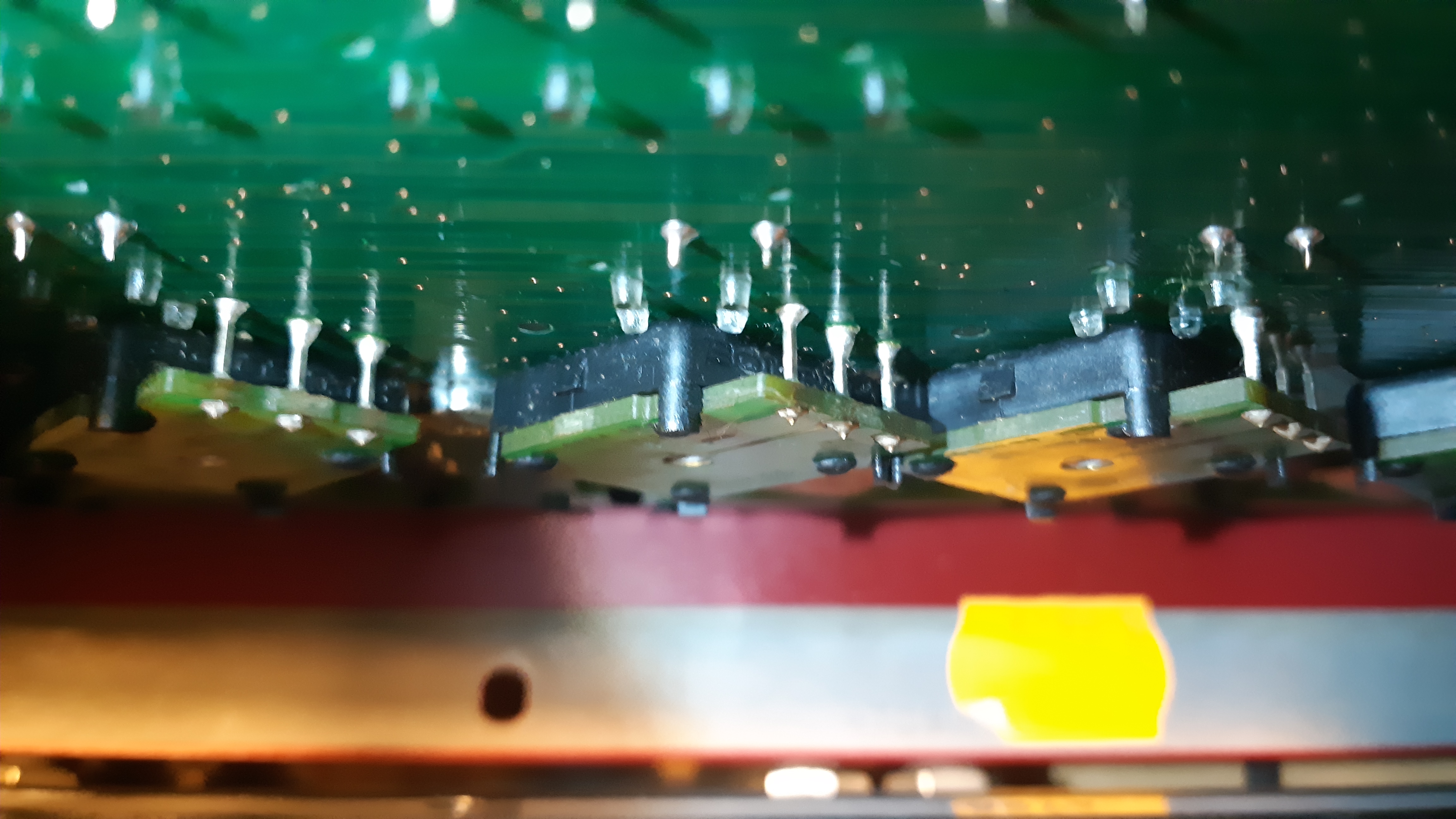

Hi!
Back, few years later. I just replaced the mod wheel potentiometer (10k), everything went well. It's a pretty straightforward repair. The mod wheel works like a new one!
Now I have to change an encoder. I have the spare part. This is not the original model (it is no longer available on Mouser) but it is the one recommended here on the forum and also elsewhere > "ECW0J-C24-BE0036"
Before to start the repair, I looked inside the G2 and noticed a difference between the original and the one I ordered. There is a piece of metal with legs on the one I ordered.
I add photos with the original knobs (not covered with metal) and with the new one "ECW0J-C24-BE0036". It can also help others
My question: Do you think it is better to remove the entire piece of metal from the potentiometer before making the modification or cutting the legs?
Cheers!

PostPosted: Sat Jul 17, 2021 5:12 pm    Post subject: Reply with quote  Mark this post and the followings unread
Pwew .. hard to tell with everything in my hands ...
I would want to alter as little as possible, so would not want to remove the metal ... for mechanical stability .. there seem to be some plastic thingies holding the original(s) in place ... I'd want something to hold the new one(s) as well .. there are some holes it seems, maybe those can be used ... for one of the metal enclusure pins ... the actual orientation would not matter for a rotary .. so maybe one? housing pin can be left (and cut of the rest ...) and glued into the hole .. or something ...
Some quick and wild thoughts only, from seeing the images .. (I dont even have a G2 keys to check Rolling Eyes )
But wish you good luck!

PostPosted: Sat Jul 17, 2021 7:42 pm    Post subject: Reply with quote  Mark this post and the followings unread
Thanks Blue Hell! Your advice is useful and I will think a little more before starting this repair
probably Estarriol is no longer here but maybe you (or someone) can help me understand which side he's referring to:
Probably you should just CUT the encoder pins as high as possible
So he is refering to the 3 pins I think. But I'm not sure which side he means?
so you'll have the pins clear and ready to have cables put on
cables = jumper wire as mentionned before?
Based on Estarriol's latest advice: no desoldering on the PCB if I understood correctly?
