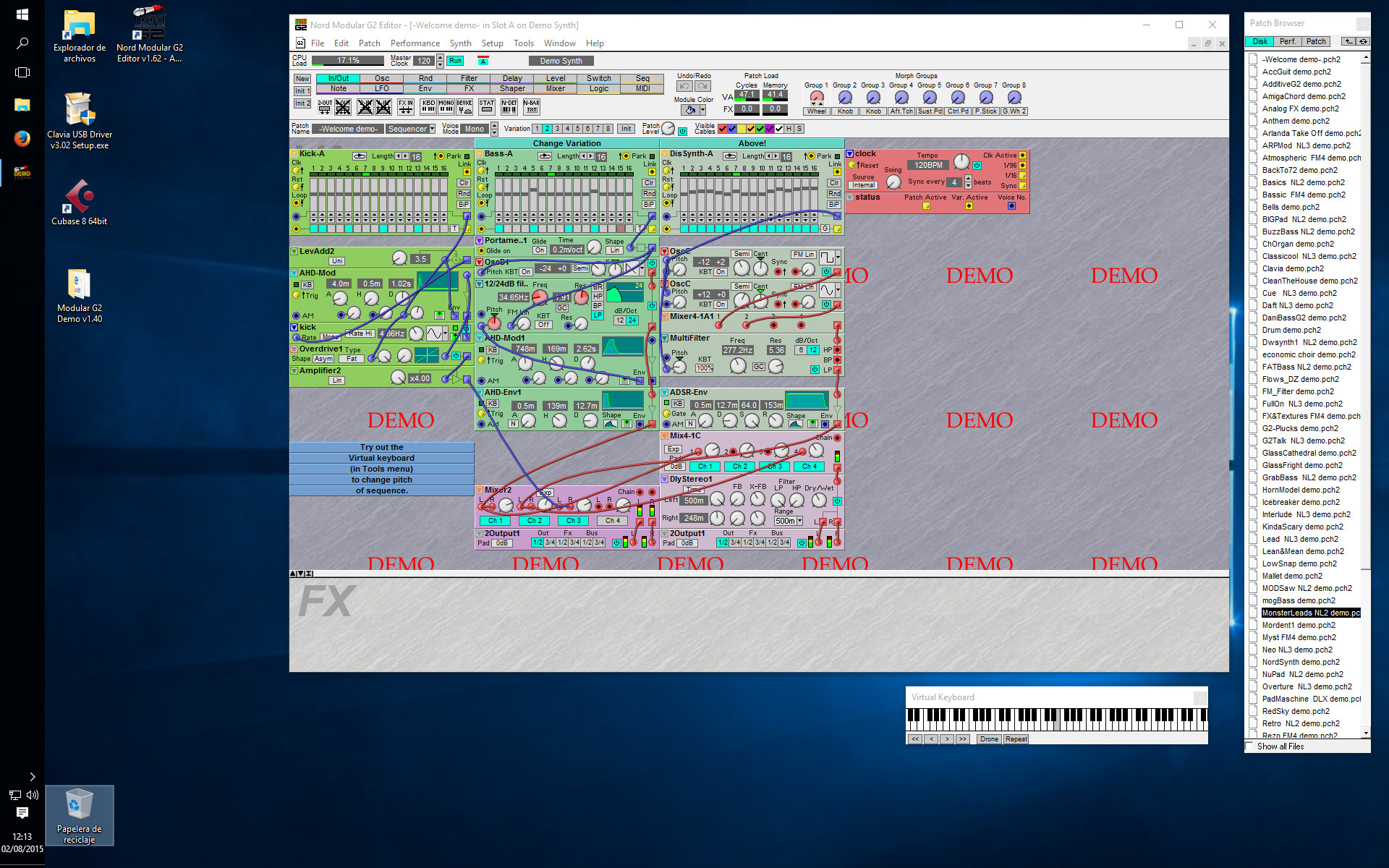

PostPosted: Sat Aug 01, 2015 11:56 pm    Post subject: Windows 10 compatibility Reply with quote  Mark this post and the followings unread
I'm happy to report that our beloved G2 is compatible with the newest Micro$oft OS using the USB driver 3.02 from Clavia. This driver can be downloaded from any of the newer Clavia synths page. Smile

PostPosted: Sun Aug 02, 2015 3:16 am    Post subject: Reply with quote  Mark this post and the followings unread
The demo Works great too.
Actually I'm running Windows 10 in Oracle's VM VirtualBox Very Happy
WIndows 10 running G2 demo

PostPosted: Sat Oct 26, 2024 2:51 pm    Post subject: Reply with quote  Mark this post and the followings unread
I'm going to resurrect this thread because today I used my beloved G2 after a long time and the editor was no longer compatible with Windows 10, showing a runtime error. Probably some ugly update...
However, it works if the program is configured for compatibility with Windows 95. The driver is still working properly.

PostPosted: Sat Oct 26, 2024 3:52 pm    Post subject: Reply with quote  Mark this post and the followings unread
Hi Jan! I spoke too soon Sad
The program seems to work, but as soon as you open the load or save dialog, or the patch browser, it crashes.
Same with the demo. It works in Windows 95 mode but it crashes when showing the load dialog.
It worked not long ago, so it must have been a recent update.
I guess it's time to use a virtual machine to run the editor and the demo...
Or maybe putting the old needed DLLs in the program directory could make it run again. I may try that.

PostPosted: Sun Oct 27, 2024 5:37 pm    Post subject: Reply with quote  Mark this post and the followings unread
In the end I read a solution that works in this other forum:
https://www.norduserforum.com/topic-25515.html
Basically, it's creating a different local account to running the program using these credentials.
I had to move my patches to a public folder so both my normal account and the new one can access them, but other than that, it seems to work well.
The demo works as well for me.
