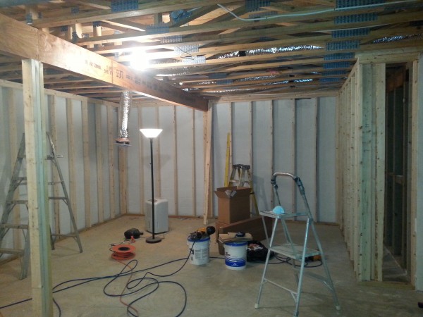

Framing begins. This is where my work ends and the contractors take over. You can see on the right that exterior walls are double-leaf.
Framing begins.

Framing continues. Here we have the doorway.
Doorway, inside looking out.

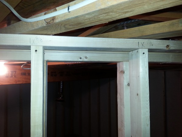

Speaking of the support beam, we need Iso-clips for that.
Iso-clips on beam.

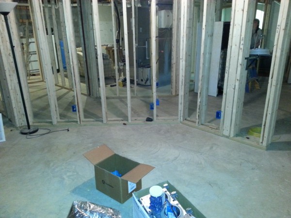

Hooking up the power. Note that the rule here is outlet boxes cannot line up front-to-back.
Electrician goes to work.

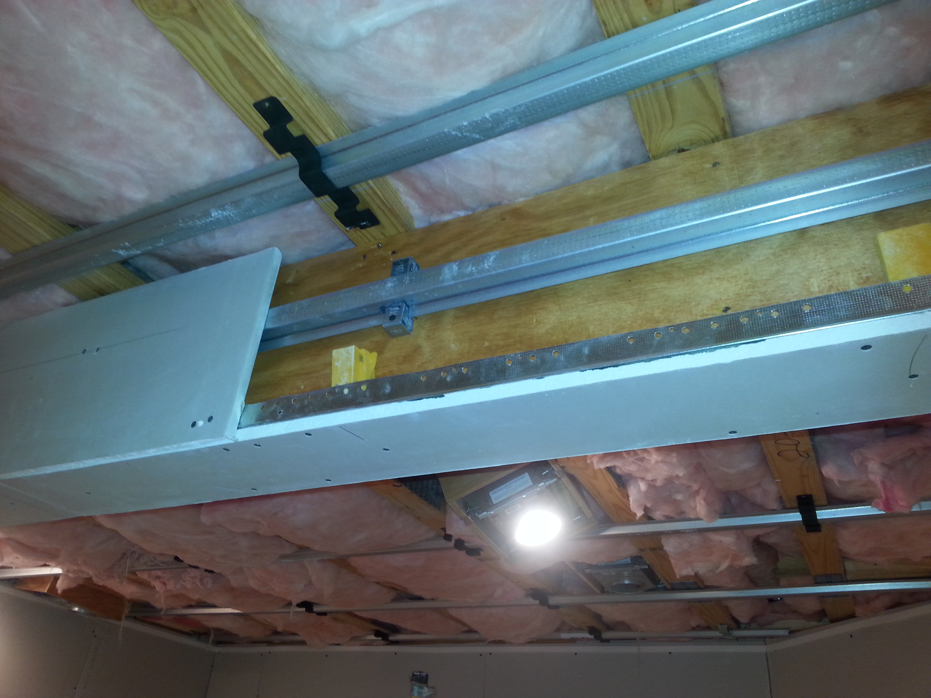

PostPosted: Tue Sep 22, 2015 7:58 am    Post subject: Reply with quote  Mark this post and the followings unread
This photo shows several important things:
1. The tracks installed on the support beam Iso-clips.
2. Drywall on the tracks over support beam.
3. Wallmat used to hold drywall corner away from beam, making it easier to screw the drywall in. This was my idea.
4. Kinetics Noise WAVE Hanger ceiling system. 20 lb silver ties were used in corners (visible if you look closely), 40 lb black ties used elsewhere.
5. Special tape on walls to isolate ceiling drywall from wall drywall, to minimize sound transmission to ceiling. One important goal of this construction is to minimize sound going out of the studio to upstairs.
Contractor had a little trouble finding the correct tracks for both beam and ceiling, but he got it done.
Drywall & ceiling prep.

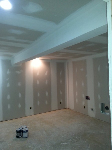

Drywall complete.
Drywall complete.

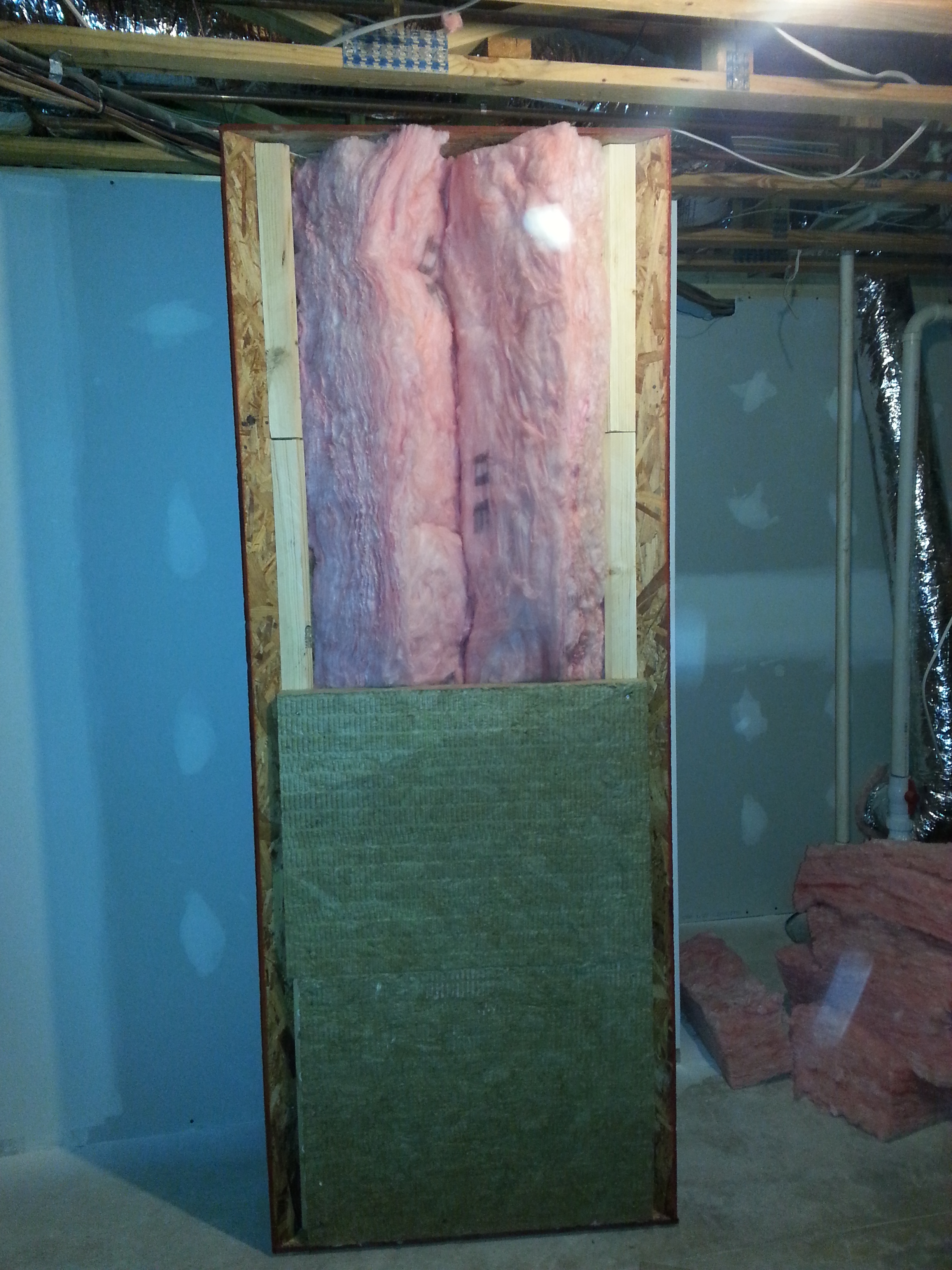

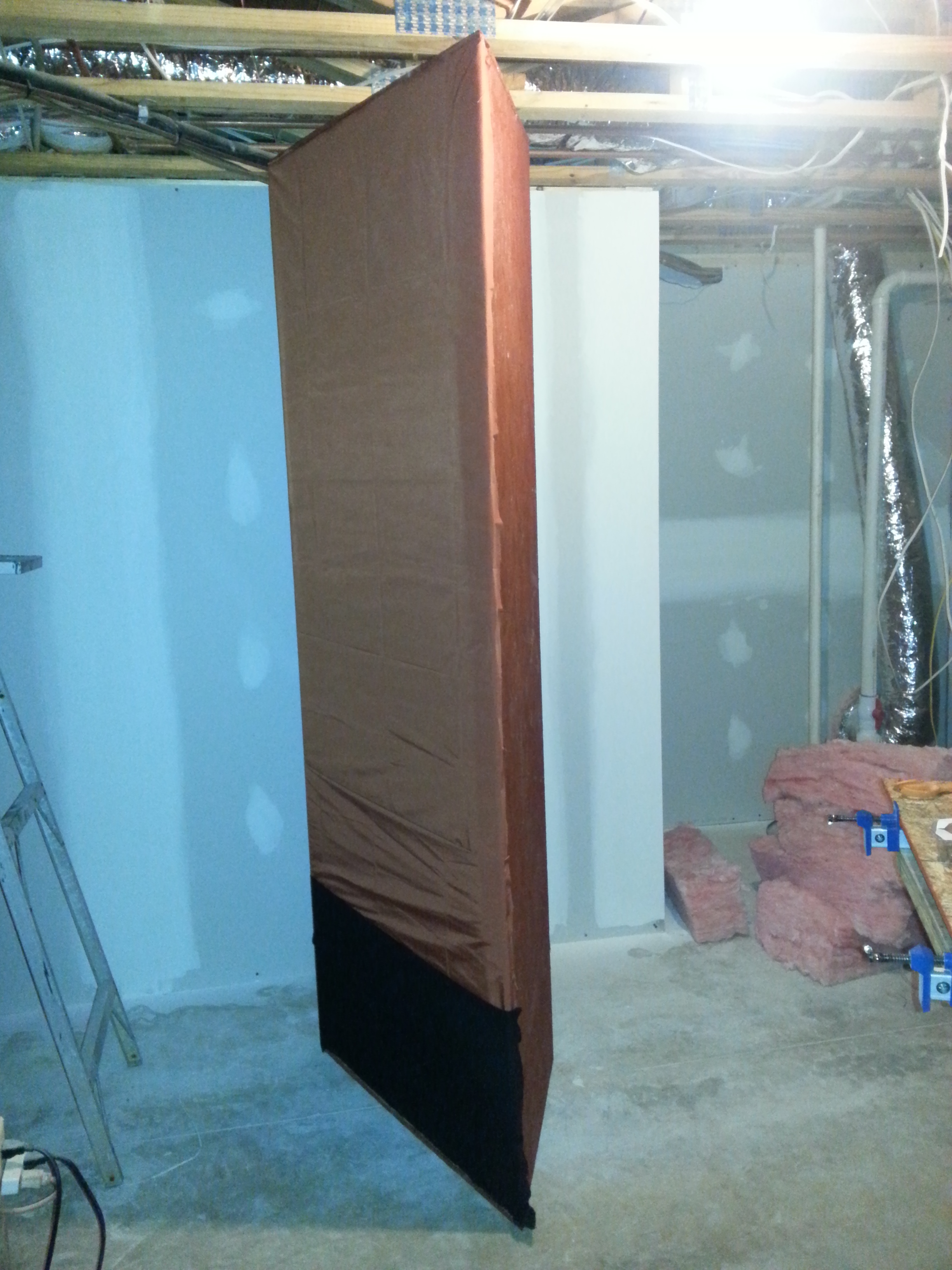

Bass trap construction. Everything went fine until I tried to stand one up. Well, it was brought into the studio on its side, and it was exactly the right height. You're probably nodding knowingly at this point. Yep, couldn't stand it up. I neglected to take the diagonal into account, so I had to cut them in half. It actually worked better that way because that made them easier to carry. I stacked them up without much trouble.
Base trap frame.
 Filesize:  2.66 MB
 Viewed:  316 Time(s)
Bass trap filled.
 Filesize:  2.2 MB
 Viewed:  316 Time(s)
Bass trap complete! But...
 Filesize:  1.76 MB
 Viewed:  315 Time(s)
!v Recently, I cut my bass traps in half.
 Filesize:  2.2 MB
 Viewed:  354 Time(s)

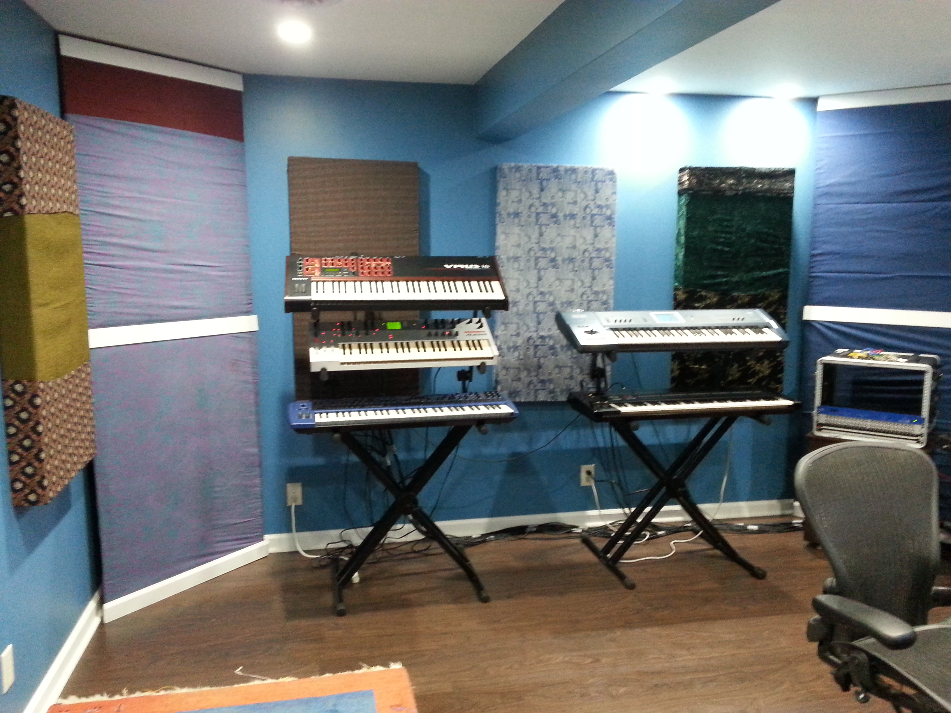

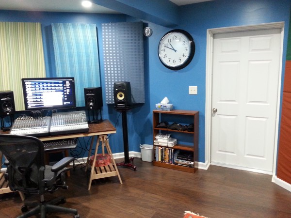

PostPosted: Tue Sep 22, 2015 9:18 am    Post subject: Reply with quote  Mark this post and the followings unread
More photos.
Still testing all connections at this point.
I had an Ikea desk. The desktop was very cheap and was bowing in the center, so I built my own desktop out of OSB and 2x4. The unit holding up the rack case in the corner I also built, because I wanted something that would hide the bundles of cables meeting at that point on the floor.

PostPosted: Tue Sep 22, 2015 9:34 am    Post subject: Reply with quote  Mark this post and the followings unread
The room is very quiet. I'm happy with the interior acoustics. It has a couple of things I need to track down and fix, though. I can hear the dogs when they go nuts upstairs, as they do whenever a random squirrel goes by. This is probably borne through the ventilation system. I know HOW to fix it, but unfortunately, the manufacturers of the devices I need sell to companies, not individuals, and I'm having trouble tracking down companies that will sell HVAC noise products to individuals.
I can hear someone coming down the basement stairs. This might be borne through the construction, or there might be a leak in/around the door.
I can hear one of the cats meowing if he's right outside the door. I definitely should not be able to hear that, and I'm hoping it's because the wall between the studio and the computer closet is not completely sealed on the closet side. I will take care of that and reevaluate.
I also need to seal the cable pass-through around the edges. Easy enough to do.
