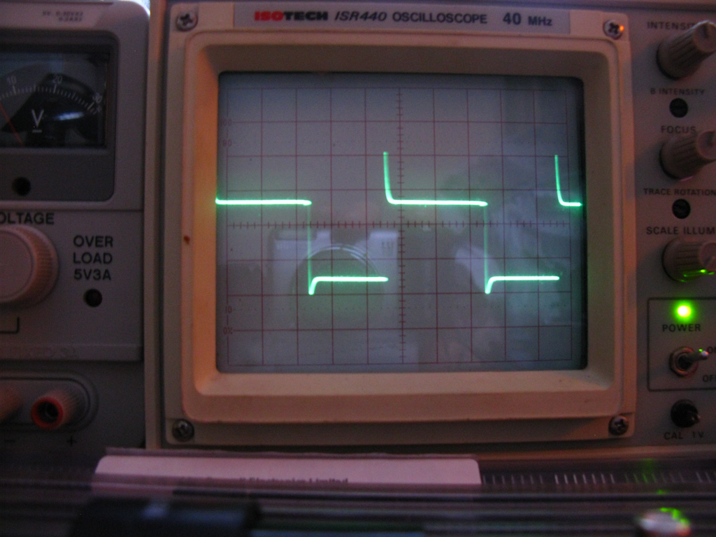

The sound is a pure square wave at the master outputs, and the left portion of the waveform is slightly ramped (dampened sounding square wave) on some of the individual outputs. The headphone output appears to be a square wave with some small noise artefacts. All at 101Hz.
does the square wave appear on all of the individual outputs or only some ? if only on some, which ones ?
maybe something common between certain individual sounds
the master and headphone cicuitry i think can be discounted for the moment as less likely area's to be at fault

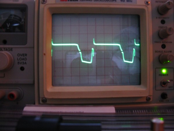

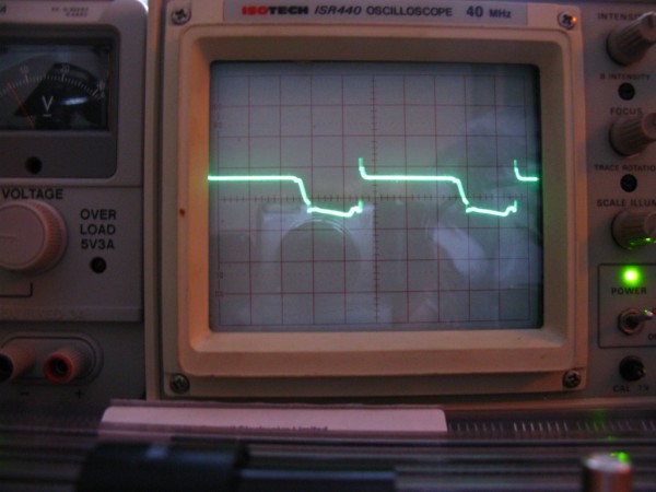

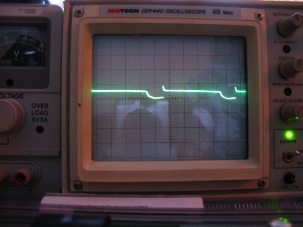

The 'square wave' (see pics) is the same across every output, doubled in voltage at the master out, and doubled again at the headphone out.
Each power up produces a different waveform (*Note the DC offset between the master and individuals at powerup 1). Occasionally no sound happens at any of the outs except at the headphones. Sometimes the display & LEDs light up differently too, changes happen per power up.
Master Out (powerup 1)

Individual out (powerup 1)

Master Out (powerup 2)

Individual out (powerup 2)
yeah the headphone outs will undoubtable have a fair bit of gain
wouldnt have expected the masters to be double the individual though
but it is common to all channels so thats something.
there will be a summing opamp stage somewhere there to mix the individuals possibly a TL0xx series chip but i dont know for sure what they may have used. the headphone circuitry will be tapped off the master
through another opamp something like an lm386
you are going to need a schematic i think
someone out there will have one.
