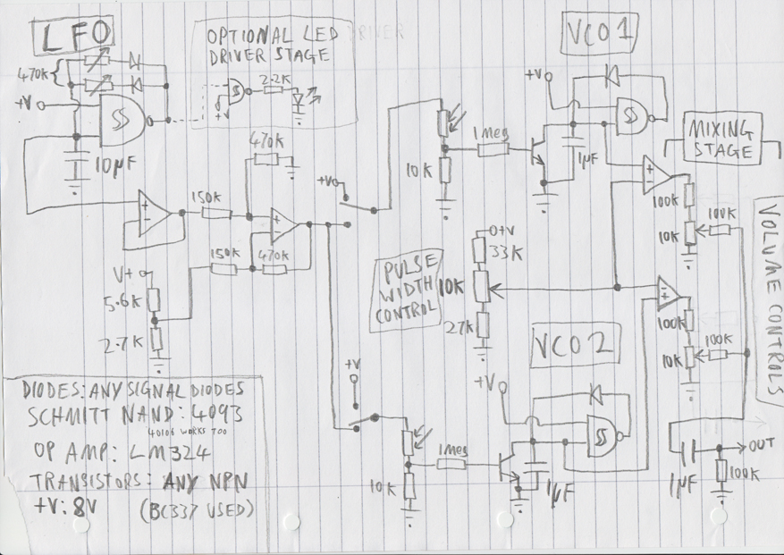

The basics:
-Two oscillators
-Light controlled
-Two settings; LFO control and straight light control.
-LFO has rise and fall time control
-Pulse width control.
Laser sounds ensue.
More details:
This device is made of junk, recycled parts and wood and metal from sweet tins Laughing
Two LDR's (light dependant resistors) are used to make two voltage dividers which provide control voltages which are fed into two simple VCO's. The LDR's can be switched between +V and the LFO. The LFO is the charge and discharge of a cap in a standard CMOS schmitt oscillator, thus the peak to peak of the wave is only about 1V and it is biased up a bit. An op amp is used to remove this bias and amplify the wave to 0V to +V peak to peak voltage.
The charge and discharge periods of the LFO can be changed independantly, this allows you to make a saw or ramp shaped LFO waves for great laser sounds as well as a triangle LFO for siren sounds and anything inbetween!
I almost forgot: The 100k resistors in the mixing stage can be anything near 100k, I used 180k and 120k because I had no 100ks left.
I will post some sounds soon.
P.S. I also forgot to say, that if you use a different power supply voltage you will need to tweak the resistor values of the pulse width resistors/potentiometer and the non-inverting op amp stage.
Circuit diagram, enjoy my childish handwriting :D

I'm trying to get my head around the LFO non inverting op amp section.
I know you've got a scope. (i've seen a couple of your vids) It must help seeing the wave forms for finalizing values and what not.
Great idea by the way.
Also on a off note, where did you obtain a 4089 chip. (I'm in the uk too) I can't find one anywhere. Really want to try that chip out.
keep up the good work man
cheers
JingleJoe
Joined: Nov 10, 2011
Posts: 878
Location: Lancashire, England
PostPosted: Sat Mar 10, 2012 12:35 am    Post subject: Reply with quote  Mark this post and the followings unread
An old electronics shop called Progressive Radio Electronics; these 4089's could be over 15 years old!
I suggest you look for any privately owned electronics shops which have been going scince the 70's Laughing There are acctually two in my area, but I had to do a reasonable amount of googling to find them both. Get searching! Wink
Now regarding the op amp stage, you mean the one after the LFO? That one is to remove the DC offset of the charge/discharge wave of the capacitor and amplify it to the maximum the op amp can, without chopping the top off!
In order to find the offset of the wave I think I used a voltage crossing detector (a simple op amp comparator like the two used for PWM in this circuit) adjusting the crossing voltage with a pot untill the wave at the output of the crossing detector was a tiny thin pulse (scope used for that) then checking the voltage at the pot with a voltmeter tells you the offset Very Happy
I did it that way because my scope is a bit crap, the different ranges are not calibrated properly and can be off by 2 volts sometimes, so it's only really good for seeing waveshapes.

One could make a VC-LFO to control the VCO, using the VCO circuit but with a big cap, controlled by the LFO already provided it would make for some very interesting sounds Smile
All I wish I had done with this device is add an arrangement like this for switching the LFO cap:
Code:
          o
      o      o
            ___
The caps would be two very different values for two different ranges.
Even without this I am totally happy with this device Smile I can even play tunes on it; with alot of practice and precision hand movements.
