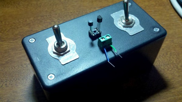

PostPosted: Thu Apr 12, 2012 7:49 pm    Post subject: Reply with quote  Mark this post and the followings unread
Thank you Ian... I've looked at that at some length and have figured that I can use a 4PDT on-off-on (criss cross the power and the diode) and a DPDT (criss cross the emitters) to work up the entire circuit for both NPN & PNP in a small project box, powered by 9V batteries. Possibly overkill Smile but will save a lot of switching around of parts, or a larger circuit board. I plan to use a trimmer too. Should be fun Smile.
PostPosted: Thu Apr 19, 2012 9:44 pm    Post subject: Reply with quote  Mark this post and the followings unread
So here's what it looks like; not actually wired up on the inside or labelled, but planned in detail, and I wanted to laugh at myself for getting extremely oversized switches Smile
[/img]
