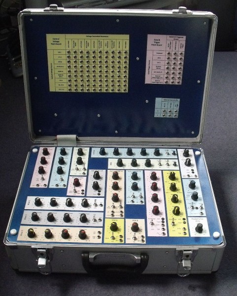

PostPosted: Tue Jan 15, 2013 9:42 am    Post subject: Reply with quote  Mark this post and the followings unread
I don't know if it will help you, but I've looked at all of the inputs and outputs on my (semi-)modular flightcase synth (see picture), which I built based mainly on on MFOS circuits, but with a few of my own thrown in. I've used matrices of 3.5mm jack sockets at the back for patching, but there are also a lot of 3.5mm sockets on the main panel for extra patching ability (some of these could have been banana socket really). Anyway, here it goes:
Rear Patchboard
CVs
9 CV outputs from LFO1, LFO2, AR EG, AR EG (Inv.), ADSR EG, ADSR EG (Inv.), S&H, Ext.CV1 & Ext.CV2
10 CV inputs to VCO1 (Pitch), VCO1 (PW), VCO2 (Pitch), VCO2 (PW), VCO3 (Pitch), VCF1 (Cut-Off Freq.), VCF1 (Q), VCF2
(Cut-Off Freq.), VCA1 (Gain & VCA2 (Gain)
Gates/Triggers
7 Gate/Trigger outputs from Keyboard, LFO1, LFO2, Random (Noise), Ext. Audio I/P, Ext. Gate/Trigger 1 & Ext. Gate/Trigger 2
3 inputs to AR EG Gate/Trigger, ADSR EG Gate & ADSR Trigger
External Inputs
2 x CV, 2 x Gate & 2 x Trigger
Main Panel
VCO1 Ramp & Pulse O/Ps
VCO2 Ramp & Pulse O/Ps
VCO3 Ramp O/P
VCF1 Ext. Audio I/P, LP O/P, BP O/P & HP O/P
VCF2 Ext. Audio I/P & LP O/P
VCA1 Ext. Audio I/P & Audio O/P
VCA2 Ext. Audio I/P & Audio O/P
Mixer 1 Audio O/P
Mixer 2 Audio O/P
Mixer 3 Left & Right Audio O/Ps
LFO1 Triangle O/P, Square O/P & 'Sine' O/P
LFO2 Ramp O/P & Pulse O/P
Noise White Noise O/P & LP Noise O/P
S&H Ext. Trigger I/P
Side Panel
Headphones O/P, Line O/P, Ext. Audio I/P, Keyboard I/P & Power I/P
That's it (I think).
Gary
 Filesize:  222.16 KB
 Viewed:  141 Time(s)

PostPosted: Tue Jan 15, 2013 11:17 am    Post subject: Reply with quote  Mark this post and the followings unread
Gary - that's a really beautiful piece of kit..... thumb up
"Everything in moderation, including moderation"

PostPosted: Tue Jan 15, 2013 1:18 pm    Post subject: Reply with quote  Mark this post and the followings unread
Thanks Dave Very Happy
I built this before I joined the forum (although I had been reading it for some time). Although I have mentioned the synth in previous posts, this is the first time that I've posted a picture of it.
Gary
