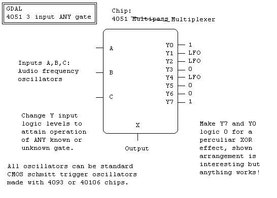

After a day of fruitless efforts I thought all my time was wasted but now after a few hours of tinkering, at 20 minutes to midnight, I bring you the 3 input ANY gate!
Depending on the logic levels of the Y inputs, you can make this thing into any gate; known or unknown! Hence the name ANY gate Smile
Rather, it will behave in the same was as any gate.
Things get really interesting though when you feel the Y inputs and binary inputs (A,B,C) with oscillators! I find that low frequency oscillators (LFOs) work best on the Y inputs and audio frequency on the ABC inputs.
You can get everything from digital bleeps and clicks to funny little rhythms and amazing space drones.
I'd love to combine this with VCO's and control them with some LFO's or other frequency modulation sources.
Sound samples coming soon!

The binary control inputs; A, B and C act as the inputs of the gate, they control which of the Y inputs are connected to X. Then you just change Y to be whatever you want, giving you the effective operation of any other logic gate. E.G. Connecting Y7 to logic 1 and all the other Y's to 0 gives the effect of a 3 input AND gate.
It's just usual multiplexing but I usually consider the Y's as signal/data inputs, whereas in this case the binary inputs are the signal/data input.
I'll go into some more detail but for explanation purposes I will use a two bit multiplexer.
Here is the truth table for it:
Code:
 A | B | Y
 0 | 0 | Y0
 1 | 0 | Y1
 0 | 1 | Y2
 1 | 1 | Y3
The Y column denotes which Y input is connected to X, the common output.
Now if we connect the Y inputs as shown below, then X will give the output of an XOR gate.
Code:
 A | B | Y   | X
 0 | 0 | Y0=0| 0
 1 | 0 | Y1=1| 1
 0 | 1 | Y2=1| 1
 1 | 1 | Y3=0| 0
It's pretty much the same old multiplexing this chip would ordinarily do, but considering the ABC inputs as the data/signal input instead of a control. The Y inputs then act as a control for the output for each conbination of binary input.

The 4051 is a multiplexer. The standard way to use a multiplexer is via the binary inputs A,B and C, which determine which of the Y inputs is connected to the common output, X.
A, B and C form a binary number pattern ranging from 0 to 7; A can be thought to have value 1, B=2 and C=4. Then with combinations of these inputs any of the eight Y inputs can be selected, they are numbered from 0 to 7.
e.g. Make B and C logic high, to connect input Y6 to the output (2 + 4 = 6)
This is the standard behaviour of a multiplexer, usually used to connect different data streams to one common bus. However, in this case, I'm thinking about things differently by using the binary inputs as the signal inputs.
I hope that clears some things up a bit Smile

Carry on the good work banjo, I think you are over complicating things a bit, it's really very simple; I'll draw you up a truth table which really helped me understand things better (see attachments).
I will explain a bit more; Using your metaphor, you will get a combination of the Beatles the Stones and the Who Smile
lets look at only the A and B inputs, if they are both high, Y3 is connected to X. (Because A=1 and B=2, 1+2=3) If Y3 is high, and all other Y inputs low, then you get the effect of an AND gate. If Y3 is low and all other Y inputs high, you will get the effect of a NAND gate.
Then, just like feeding signals into a regular gate, if you feed them into A, B and C you can change the Y inputs to change the operation of the "gate" (gate in quotation marks because it is really a multiplexer Smile).
I have added a column on your truth table to allow for the entry of logic states of the Y inputs which will tell you what X will be at different combinations of A,B and C.
Therein lies another interesting idea; the 4051 is an analogue multiplexer. See where I'm going with this? Wink You could add any signal to the other inputs, like a triangle LFO for amplitude modulation.
