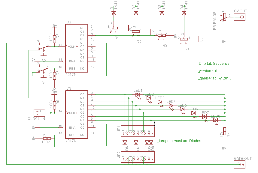

Dirty LiL Sequenzer,
Prototype finished.
It is a 8 Step sequenzer (4017), instead of 8 Pots i use only 4.
Instead of Switches i use jumper.
With every Gate u choose, the CV Counter advances.
It is a simple design but, by changing the source of clock and reset and by using less or more than 4 gatesteps, it has some features.
The design is easy adaptable to different amounts of steps'n'pots.
Below the Schemo and some pics of the Prototype.
In the prototype i have added two momentary-switches for manual gate and reset, and dont have the RangePot.
-EDIT-
Jumpers must are Diodes, thx PHOBoS.
Better Schemo attatched.
-EDIT END-
cheers

nice! Very Happy I like the different options it has, like using the gate out to clock the (CV) sequencer, a simple way to create a swinging sequence.
I would add a buffer to the CV out though (opamp as voltage follower). And maybe an extra option to set it to a different amount of steps,
you can get nice variations if you would set the gate sequencer to 7 steps. Of course you can always keep adding things.
edit: something I just noticed, you're probably gonna use more then one jumper at a time (for the gate output). If so you should add
some diodes in series with the jumpers else you'll be shorting the outputs of IC3.

Thx PHOBoS,
i added a Workaround in the first Post,
the jumpers must are Diodes now.
I have drawed 2 new Versions.
One implement a step lenght option on step 5,6 and 7 and the manual Reset. The other has one more Option on the CV-Reset.
The step lenght option i have also in the prototype now.
