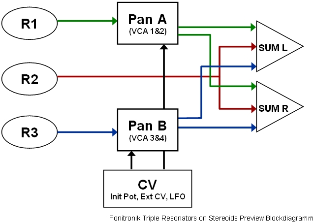

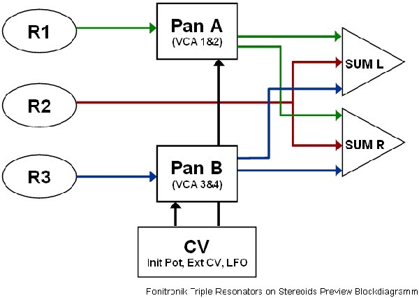

PostPosted: Mon Sep 29, 2008 6:59 am    Post subject: Reply with quote  Mark this post and the followings unread
the idea was to have the original PS3100 resonators three BPFs and pan them into stereo like this (the wet/dry mix would be sacrificed - i don't use it at all):
 Filesize:  76.82 KB

Matthias,
Thanks for posting the diagram for your stereo resonator design. That was the basic approach that I was hoping you would take.
I assume that this diagram only shows the new features that you plan to add, such as adding additional CV inputs to control panning. In other words,
1) Do you plan to make any changes to any of the original features such as the way the original CV inputs that control the frequency of each resonator are implemented?
2) Also, since you are adding the stereo panner, do you still plan to keep the LFO in the new design. (I certainly hope so.)
Anyway, I'm really anxious to get a hold of a couple of the rev 3 boards!
David

PostPosted: Sat Oct 04, 2008 6:25 am    Post subject: Reply with quote  Mark this post and the followings unread
camelneck wrote:
Matthias,
no. i will leave off the wet/dry mix control, though. i myself don't use it at all and it would make the stereo more complicated. and hey, does any our other filters have a wet/dry control?
yes, i do.
i will try to get it all on one PCB with eagle light. if it doesn't work i will split the circuit into two parts: one PCB for the actual resonators and an additional PCB for the stereo option. this would maybe please all who already got a rev1 or 2 board, but will be a little bit more expensive for those, who need both boards. distribution would be more complicated as well. i still think about it.
