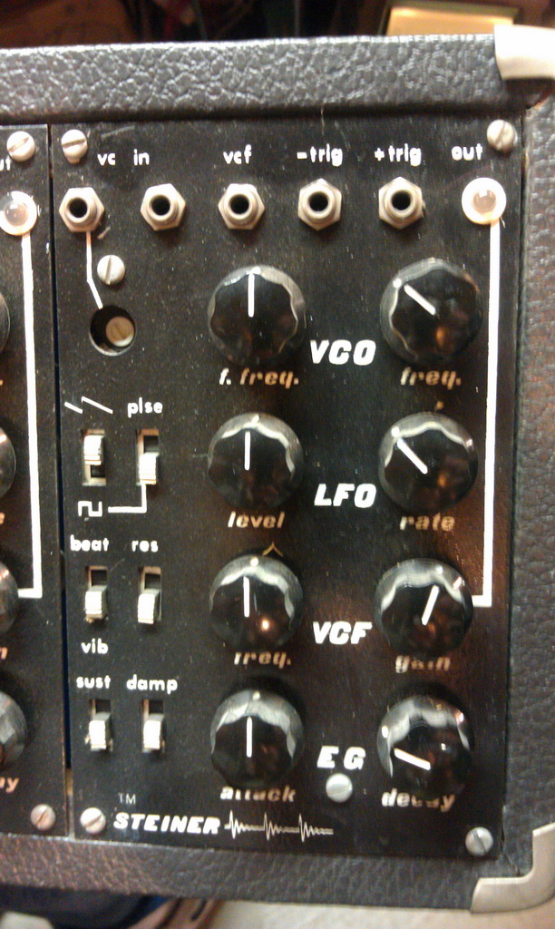

Hi Everyone.
To compliment the Steiner Synthasystem resurrection I completed (see here http://www.xmission.com/~dingebre/Synthasystem.html), I'm now undertaking the Steiner Microcon. I'll put up a page with build/calibration notes and will have PCBs for sale. Be aware, it does use two Vactrols which may be hareder to find as time goes on. They are the VTL5C3/2 variety right now available at Allied Electronics. It also makes use of 5 74C14 Hex Inverters. There are some substitutes which I'll have in the build notes. It also uses a 2n5246 JFET which also recently went away, but it isn't really special and there are substitutes. Everything else should be relatively easy to find.
There are a couple of trimmers on the PCB which will be configured so you can make it a panel pot, like resonance, and sustain level. So, stay tuned.
The Microcon was a standalone synthesizer voice, VCO, LFO, VCF, EG (driving a VCA). It also had a unique way to "fatten" the VCO sound. Below is a photo taken of one Nyle mounted in a custom rack of 8 (or was it 9) Microcons as a special order.
Carry on...

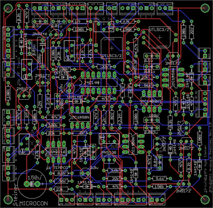

PostPosted: Sun Nov 20, 2011 2:37 pm    Post subject: Reply with quote  Mark this post and the followings unread
Progress is made. I ordered some prototype PCBs this weekend. Right now, the PCB is 4 inches by 3.9 inches and will fit flat behind a 21 HP panel. I don't have any power conditioning on the PCB, so as it it, it has to have +/- 12. You can add one of my power conditioning PCBs from the Synthasystem project if you want some extra filtering and/or regulation.
I should have the PCBs in a few weeks and will post a panel design when done.
I could also split it into 2 PCBs if the width is more a problem than depth and then could put some power conditioning on the second PCB. What do you think?
David

PostPosted: Sun Nov 20, 2011 5:18 pm    Post subject: Reply with quote  Mark this post and the followings unread
SubG wrote:
my idea was to built one behind a buchla panel,but seems i will need to redraw the pcb
anyhow looks great
What form factor works best for Buchla? I can re-do the layout if it still works behind a Euro panel.
David

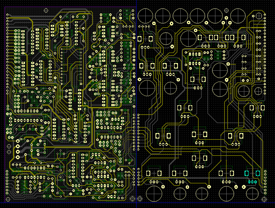

PostPosted: Mon Nov 21, 2011 2:08 am    Post subject: Reply with quote  Mark this post and the followings unread
to fit behind buchla panel pcb may be max. 105x155 mm,105x150mm is ideal

PostPosted: Mon Nov 21, 2011 10:58 am    Post subject: Reply with quote  Mark this post and the followings unread
So in my "english" unit mind, this is 4.13 by 6.1 inches. The PCB as it stands is 3.9 by 4 inches. So as is, it should fit, if not an ideal size.
What could be done to make it easier for you to use? Different mounting hole location?

PostPosted: Mon Nov 21, 2011 2:44 pm    Post subject: Reply with quote  Mark this post and the followings unread
dingebre wrote:
well for a buchla style module ideal would be to replace all connectors by 2 long headers parrallel ,but stretch the pcb to the buchla size then so the headers comes at outsides of the pcb,so the pcb just have to be plugged in into the hmm pot pcb .
but normaly first a front panel layout design have to be done to see where there is room for headers..
and provide on board +/- 15v psu (buchla compatibility) Wink
i think if you do a pot pcb aswell for buchla style you could sell some.
i probably will wire up mine.

Fascinating. Thank you for the info and example. For now, I think I will stick to my standard layout form. But if there is enough interest for a specific Buchla format, I'm willing to give it a go.
David
