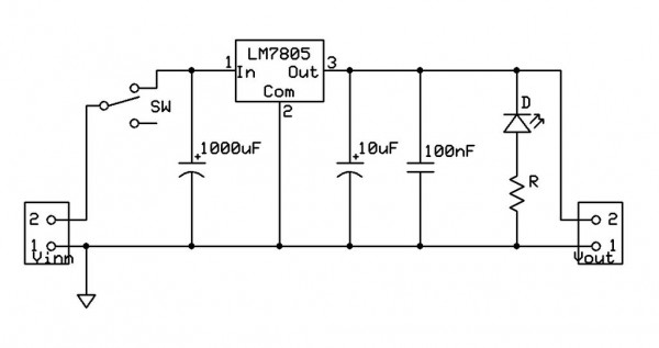

Hello Crotan, I'm also about to start building my first Lunetta but I do have some decades experience with logic chips.
And I'll put a LM7805 regulator after the wall wart (probably 9V). Are those good thumb values?
Minimum voltage for CMOS chips is 3 volts so regulating the input to 5 volts is cutting things a bit fine unless you know what you are doing. If you have a modern regulated DC wall wart then further regulation is not needed. I chose a 12 volt 2 amp because I thought I might want to build in a small amplifier kit. There seem to be plenty of posts here about 9 volt Lunettas.
All patchable outputs will go through a 1k resistor and a 4001 diode (for stackability). Are the diodes necessary? Will they modify the sound in any way that I'd need additional parts?
I would stay away from the diodes unless the circuit you are copying has them. There will be times when you will want to use the current sinking capability of the CMOS chip and the diode will prevent that. I was going to add current limiting resistors on the outputs but then I saw that no-one else did so I'll only be adding them if I think there is a possibility of heavy current draw.
Watch out for the current draw of LEDs. Make sure the chip can handle the LED current as well as whatever musical thing you want it to do.

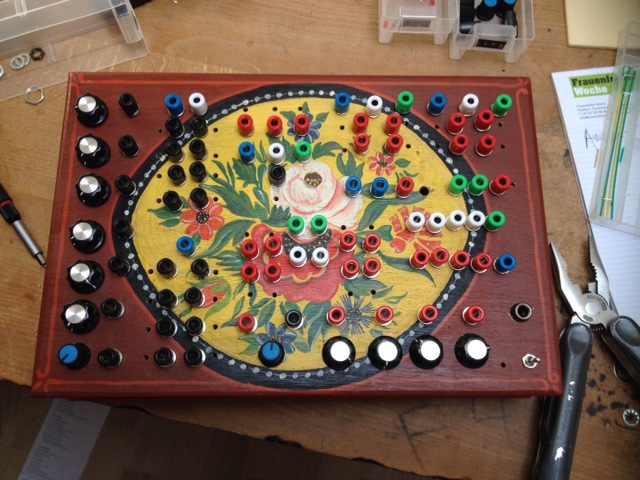

Hey folks!
It's been quite some time, but I finally started building Very Happy
And - quite obviously - I've run into problems pretty soon. I've tried quite a few things and am pretty confused, maybe you can figure it out:
ATM I'm running 6 40106 oscillators, a 4017 counter and a 4040 divider. Powered by a regulated 5V output.
I can run the counter clocked by the oscillators in the mixer - it sounds fine. I can run the divider clocked by the oscillators in the mixer - sounds fine as well. But I can't clock the divider with a counter output or vice-versa. Though I can run the reset of the counter by a signal from the divider, while clocking it with an oscillator.
I've tried: removing the 1k resistor in series on the output / removing the 100k resistor to ground on the input / changing to 9V (i plan to include a 74hc chip, which is why I'm running 5V. maybe I'll change to 7..). Nothing worked though.
The chips are the 40XXBE series. I checked the datasheets - but my know-how isn't good enough to figure out, whether the problem could be by routing or incompatible stuff with the chips.
Anybody got an idea? I don't think that could be because of the soldering ... otherwise I wouldn't be able to run them on their own, I guess.
Cheers, mates!
(picture of my box attached - just so that there's something nice to look at in this post Smile )
 Filesize:  150.72 KB
 Viewed:  331 Time(s)

I just wanted to say that is a very cool looking box, nicely done!
Surely you need to clock the counter and divider before they can clock anything else...apologies if I'm not understanding the problem.

nice looking box Very Happy

Steveg wrote:
croatan wrote:
40106 -> 4017 // everything nice, 4017 blinking, can hear the outputs
40106 -> 4040 // everything nice'n'blinky, can listen to outputs
As PHOBoS said it is difficult to tell without the schematic but my best guess is that the LED's are loading down the gate outputs too much.
Try a multimeter on the chip outputs ... If it reads less than 0.25 times your supply voltage you aren't getting enough voltage to trigger a high logic level.
Otherwise (or to be sure) just disconnect one LED and see if that output will now drive another chip.
Those LEDs need to be drawing less than one milliamp use high output LEDs and size your resistor to that current.
MAY YOU LIVE LONG AND PROSPER
(...while stupid me is off replacing resistors geek )
Thank you all folks! I'll be able to stay away from drawing schematics a little bit longer...
EDIT: OMFG IT'S ALIVE

PostPosted: Thu Jul 09, 2015 8:46 am    Post subject: Reply with quote  Mark this post and the followings unread
ah the LED's good thinking steve, they can indeed cause a voltage drop.
Makes me curious though, what was the value of the resistors ?

PostPosted: Fri Jul 10, 2015 1:41 am    Post subject: Reply with quote  Mark this post and the followings unread
Oh Good!
Nice box BTW!
Posts: 24476
PostPosted: Fri Jul 10, 2015 2:00 am    Post subject: Reply with quote  Mark this post and the followings unread
Very nice box even :-)

croatan
Joined: Apr 20, 2015
Posts: 8
Location: Switzerland
PostPosted: Fri Jul 10, 2015 2:34 pm    Post subject: Reply with quote  Mark this post and the followings unread
erhm.. 220r. during sorting my parts (and before I got a multimeter) i put them in the same bag as my 2k2 ... Embarassed But I learned something, didn't I
@Blue Hell, Steveg: Cheers mates =) I'm really happy about it too!
@elektrouwe: I did measure the distances... but well.. I usually find time to work on the synth late at night... after work... which often is followed by free beer. But it has to look handmade, doesn't it Razz

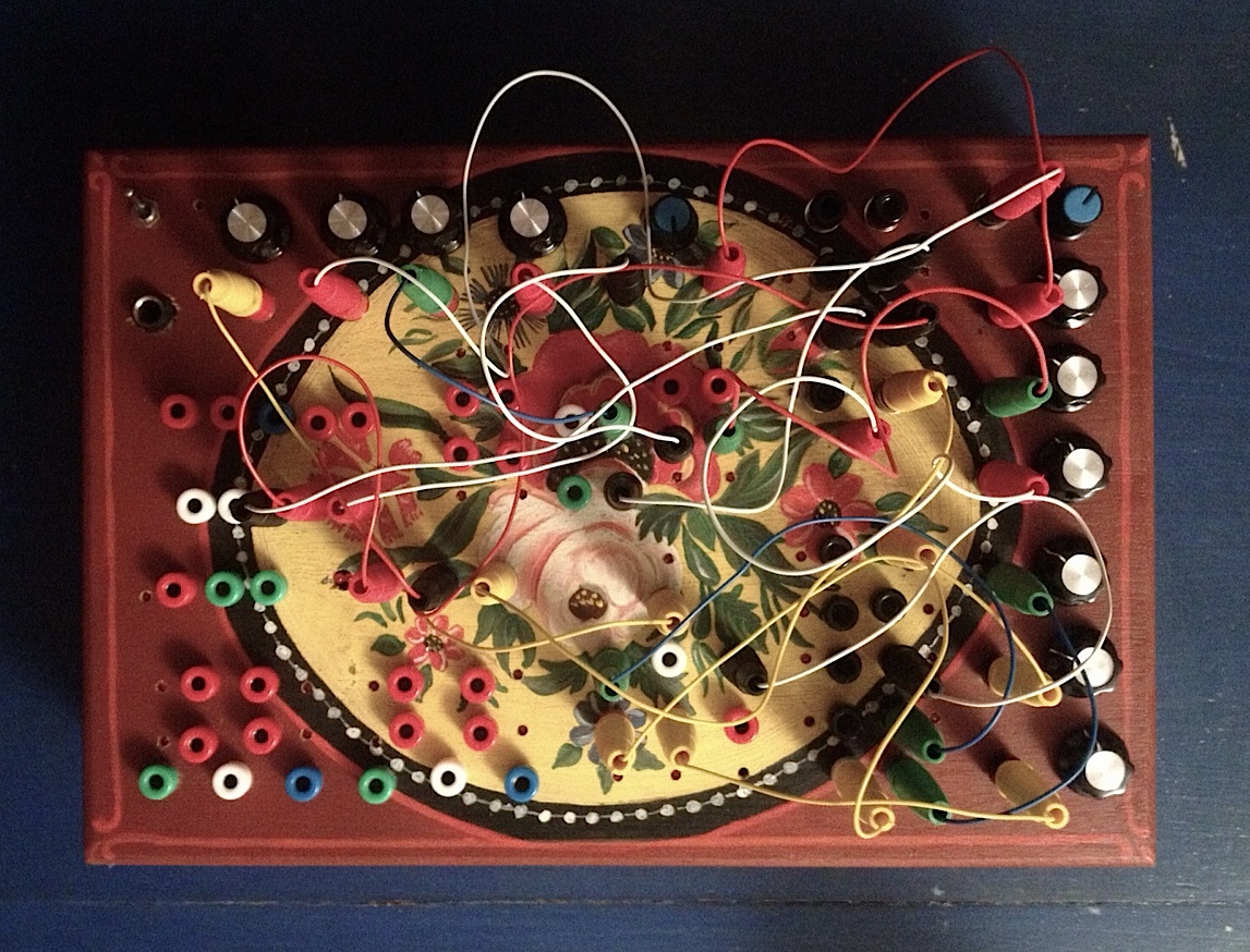

Hey folks,
My first lunetta semi-modular is finished! drunken cheers surprise
Recorded my second flight with my new baby for you:
[added a lil' reverb & compression]
It contains:
40106 oscillators
4017 counter
4040 divider
4015 shift register (2 seperate, non-linked)
4066 (4xswitches; 2 controlled by the same input, but inverted)
4052 mux/demux
4046 pitch tracker (though that one behaves strange..)
Slacker Melody Generator
XOR Gates
Passive 4-channel mixer
VCO and R2R are reserved for the next one. Can't wait Wink
Aaaand, question:
I'm running it with a 9V battery the power regulator circuit in the attachments. Can I just replace the battery wires with a 9V wallwart (round 1A)..? Don't wanna fry anything...
Many, many, MANY thanks for your help - synthDIY opened a new world for me love It's just incredible how much information can be found on here..

Steveg
Joined: Apr 23, 2015
Posts: 184
Location: Perth, Australia
PostPosted: Tue Jul 14, 2015 3:52 am    Post subject: Reply with quote  Mark this post and the followings unread
I see no reason why you can't replace the battery with a plug pack. One Amp will be more than enough.
The only caveat is make sure of the polarity. In fact it would not hurt to put a power diode between the power plug and the regulator.
