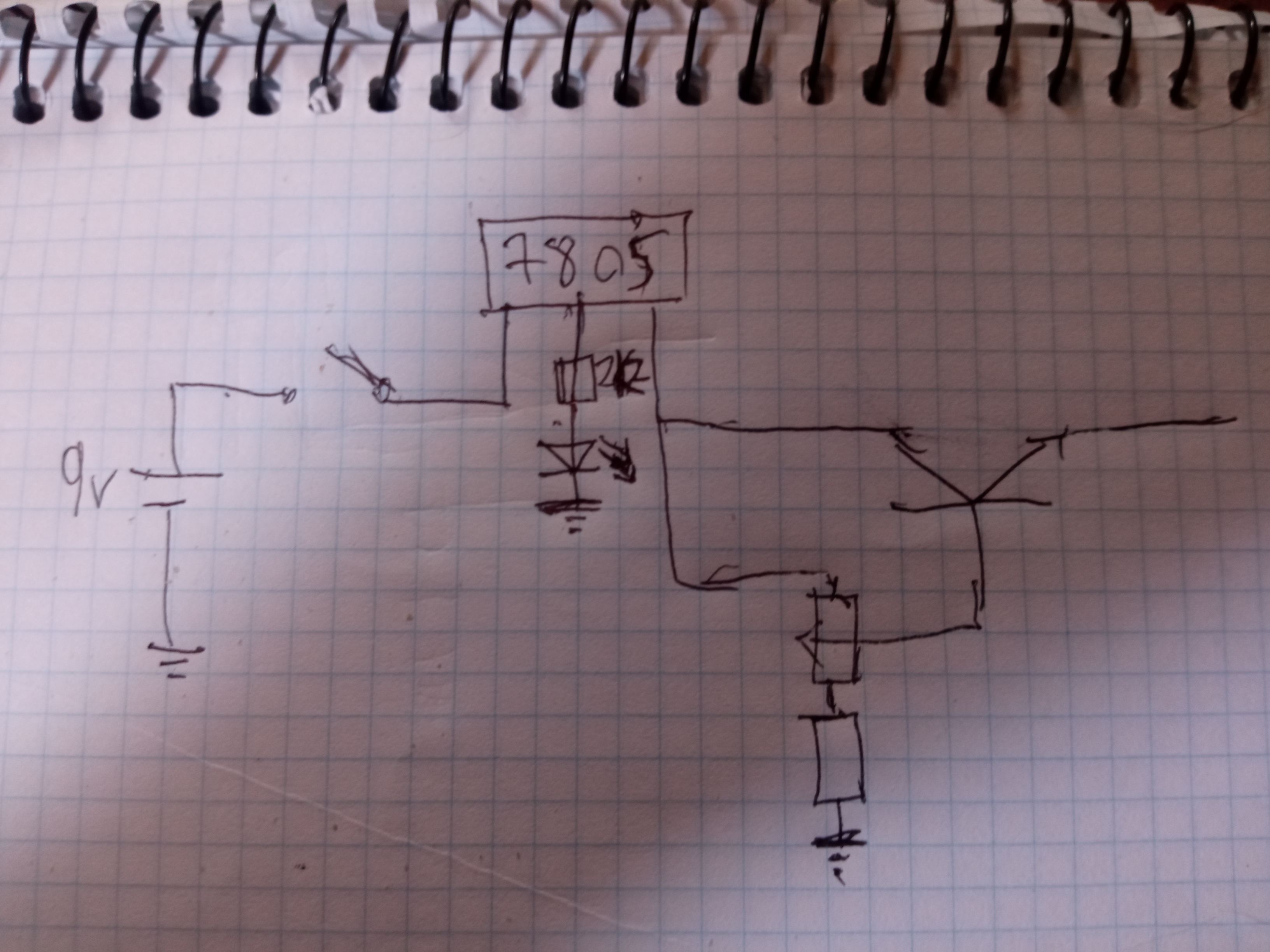

PostPosted: Tue Apr 25, 2023 5:32 am    Post subject: Reply with quote  Mark this post and the followings unread
Like this?

tranzol190
Joined: Apr 18, 2023
Posts: 7
Location: europe
PostPosted: Tue Apr 25, 2023 6:31 am    Post subject: Reply with quote  Mark this post and the followings unread
I build what is on the drawing and find out that regulator causing significant voltage drop battery is weak like 5v. So think i will look for zenner. Thank you for your help
Posts: 24454
Audio files: 297
PostPosted: Tue Apr 25, 2023 6:49 am    Post subject: Reply with quote  Mark this post and the followings unread
tranzol190 wrote:
Like this?
Heh, no .. there should not be a 2k2 at that place ... regulation will not work then - the diode is OK though.
