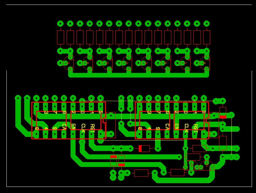

Well I have started to draw up a PCB. To keep it simple each pair of 4017 will be on its own board each board will be complete in it's own right. Each board can be run as a solo 16 step sequencer and only requires the addition of the diodes to steer the reset function to the 'switcher'.
That's the current idea anyway. Also to keep each board as small as possible the transistor outputs will be on their own PCB Shocked It's getting out of hand already! My only thought is whether to have these set as 1 x 16 or 2 x 8 or indeed 2 1 x 8 boards.
At this point I'm drawing and changing on the fly. The sequencer PCBs will, in theory, be able to be stacked using solid core wire to link the common reset lines and the power on reset components line (not shown). I love the 4017 chip. I've had hours of fun knocking up light chaser circuits with them. BUT my one bug bear.......... Why didn't the chips designers have the outputs in sequential order? I may waste a little board space running links and pads to have the outputs in order. At least that way the inter wiring should stay neat. Here's a pic of the small progress so far.
Fen

Also as I've read about them, specifically the clone circuits, I see some have trigger and accent inputs. Although in certain cases I see these have been joined together I think I understand that the accent could be connected to a CV output as well as the trigger line just being fitted to the trigger. Is this correct?
I've only build the cowbell and the accent is just another trigger input.
I'd personally use AND gates instead of the 4066 since you're working with digital signals only.
yeah what's up with that, it's something that has annoyed me with a bunch of chips, it probably has something to do with the manufactoring process I guess.
Have you tested the circuit on breadboard ? I have had some troubles with the 4017 not working as I expected before.

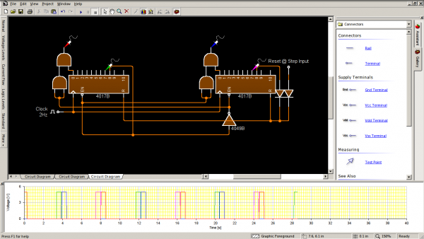

Further to the above. I've had a little play in sim. To the far left of the image is the transistor pair that is the stock input for the 808 circuits. top line being accent from the CV lower line being trigger.
I think accent may also be known as velocity? If a pieo sensor and circuit were used as input.
The fisrt 8 CV pots go from 100% - 65% (there is a deadone from 100% to 95%)
EDIT: its not dead theres an extra pulse at the start of cycle so 17 instead of 16.... PHOBos had that problem to.......where did I see that?
the second 8 CV pots go from 35% - 0% ordinarily you would see a regular step down like a staircase. but because the accent IN and Trigger IN are bound together by the transistor switch you get the decreasing spikes instead.
I presume the 808 circuits could also be played if interfaced with a pieo sensor circuit you could have a drum synth kit.
excuse the spelling of pieo the _ key on my keyboard is dead.

PostPosted: Sat Oct 03, 2015 6:07 am    Post subject: Reply with quote  Mark this post and the followings unread
http://www.electro-music.com/forum/post-402866.html#402866
I think there's another thread where I ran into the same problem, reducing the pulldown to reset solved that.
(the little gate also had some similar problems)
and here are some z's for you to use:
z z z z z z z z z z z z z z z z z z z z z z z z z z z z z z z z z z z z z z z z z z z
let me know if you run out, I have more where those came from Wink
edit: oh an extra pulse not skipping,. maybe this one ?
http://electro-music.com/forum/post-398500.html#398500

Cheers PHOBos. I knew I'd seen it mentioned! A search also brought it up as a standard issue it seems. I'm trying to recall if I ever had an issue with LED sequencers but I'm pretty sure I had no issue.
Though that begs the question does the differing end use have an effect? Can't see it but who knows?
I know the software I use is only indicative not accurate. I've done an overlay of the CV steps on the CV/trigger spikes the first (extra spike) occurs on the CV rising edge the last spike occurs on the CV falling edge and the intermediate spikes are at the end of each step. Thats in the first 4017.
The second 4017 spikes all sit center of each CV step which seems more normal. I tried using a transistor on the clock line and this fixed the first 4017 group but then the second 4017 group drifted late and the extra pulse occurred in that group instead Shocked
I really will have to bread board the basic 16 step sequencer and see what occurs. Duly noted the links provided thank you.
What are your thoughts on the loading on the outputs in terms of how far can you go? So how many drum type circuits could I possibly drive maximum?

Other than that here's an idea I had. Useful or no I know not, I also suspect it's nothing new. When Cascading 4017 IC's the most common method seems to involve losing output 0 to the required driving logic and because these go live a bit before they are used in the flow of sequential outputs.
So why not use a pair of AND gates on output 0 of each 4017. See attached image. Basically you can use output 0 as normal via the output of the AND gate. The first OUT in a sequence will be on as it should be.
All other AND gates are off until required by the relevant output 0 and inhibit line both being logic 1. So where as you may usually lose output 0 and 9 to the driving logic of cascading you can reclaim output 0 at least.
It may also not suit some circuit designs. It can preclude doing things in certain ways or just foul up the logic in unexpected ways in certain circumstances.
My only other 'thing' is. Although I don't trust the sim software as far as I can throw it 'real world testing is the only proof' in sim the standard cascade methods show a bit of a pause between 1st and last outputs and intermediate pairs..... propagation delay I think it's called? OK it's in milliseconds I really should get a life. But the AND gate method seems to severely reduce the effect..........
Other than that it could just be the software handling the circuit better in one method than it does the other. Remember...... I actually know BUGGER ALL Very Happy

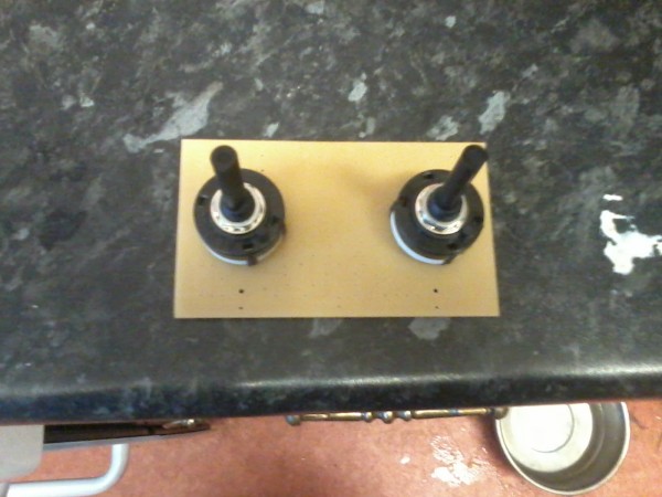

Anyway here goes. I've been 'designing', in the loosest sense of the word my modular drum sequencer. Despite the corporeal build delay I will be able to test the cmos core of the theoretical circuit I've cobbled together from disparate parts gleaned from posts all over the web.
But mainly here, MFOS, and a randomly stumbled upon PE sequencer PDF scanned document.
So the core circuit is a pair of CD4017, One CD4081 and a CD4001. With these chips I can run a 1 x 16 or, at the flick of a switch, 2 x 8 sequencers.
Primarily the above is taken from the Practical Electronics March 1979 Sequencer project. Although it has to be said, and it looks like some scribbles on the scans indicate, there is an error in the latch logic of the schematic that bugger up an otherwise neat idea. I don't know if the PCB patterns have the same error but I'm rolling my own anyway......well I will be and my output interface is totally different anyway.
That said I worked out how to get the latch logic sorted so that you could actually switch between 1 x 16 or 2 x 8. in 2 x 8 mode each 4017 can have it's own clock drive.
After that I pulled all the disparate parts of the output interface together. To match one CD4017 I need 2 CD4081 IC's to form the pulse OUT in conjunction with a gate to trigger circuit.
To each OUT of the 4081 a switch and pot for CV. Also here a tap out for an LED on each OUT for indication when sequencing. On the OUT of each pot a signal diode. These are then summed into what is the MFOS drum trigger circuit.
On Rays site this is shown with a piezo on the input. The circuit is divided into two parts. The first half outputs a CV output. For synth drums I understand this is termed velocity. The harder the piezo is struck the greater the initial voltage level the softer the lower the level. This effects the apparent sound of the synth drum. The other half of the circuit provides the trigger, a 5V pulse commonly, though some units vary in requirement.
Thats it up to that point. There is some finessing to do and some ideas bubbling under. Today I also etched and drilled my first PCB in ages, for the sound card oscilloscope. good fun!
Here's a pic of the output circuit to give you the idea and a pic of the PCB I've just done. Toner transfer method FTW!
Fen

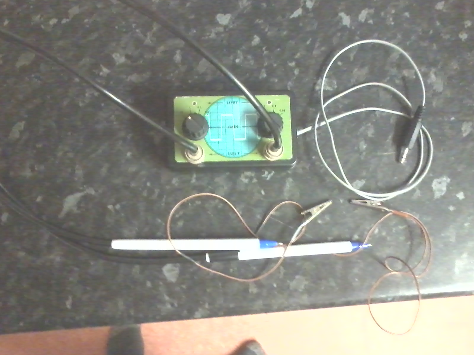

Not much going on today. Father in laws weekly visit takes precedence. But yesterday I boxed my oscilloscope interface. It took all day! Not perfect but it does and I can fettle it later.
I have only to knock up some 10x Probes and the jobs a good 'un. The unit passed it's 'Burp' test as per the documentation and I just have to do the final LED limit threshold adjustment. Basically if the input is approaching the sound cards input limit the LED on either, or both channels lights up as a warning.
I did manage to plug an arduino circuit into it as a test. The arduino is driving a 4 x 5 LED matrix in a pseudo random pattern (The code was done for me. I am just not capable Sad ) . So I took line from one LED to the scope input and a shared GND and watched XOSCOPE monitor the input.
Yep. A bit rough with 2 wires as the link but it works!
Fen

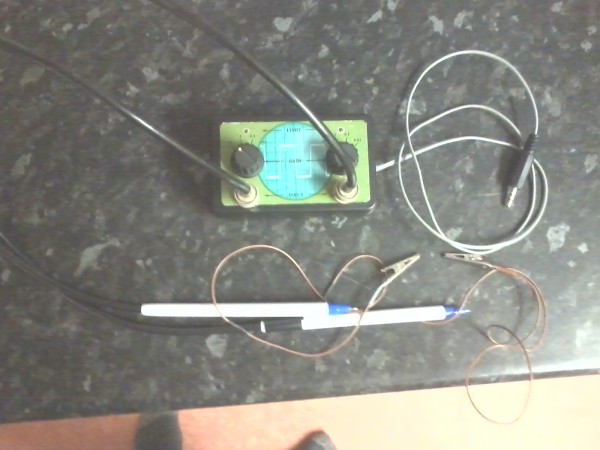

Finished it completely today. The case is a 'PSU' block. So there is a 25 x 30mm rectangular hole at one end and a small 8 x 8mm hole at the other.
But first things first. I made my second 10x probe. Basically a 6.8M and a 2.2M resistor in series to make a 9M. They are laid in tandem and the leads at the same end bent over to each other, soldered and trimmed. This is then slipped into a bit of heat shrink leaving the remaining leads clear at one end.
One of the leads is then bent back up the covered resistors. A 5.6pF ceramic cap, nearest to 6pF I could get, is laid on top of the resistors with one of its legs bent up in the direction of the resistors. So you have a resistor lead and capacitor lead in one direction and a pair in the other.
I spiral wound each cap lead round each resistor lead and snip off the access. A biro tip is used to make the probe tip. This is heated with the iron to boil the ink out of it then filled with solder prior to soldering one end of the resistor cap package into it.
After that its fit the coax through the pen body. fit a wire for the ground also. Trim the outer insulation exposing the shield, gather into a tail and solder. attach the hookup wire to this. Trim the core insulation twist and solder the wire and solder the tip/resistor/cap package to this. Rebuild pen body around this. Solder alligator clip to hookup wire and your done.
Now the holes in the case. A black ice cream tub! cut up to fit the rabbat in the larger hole and the smaller hole has a piece hot glued inside, having been prepped for the audio out cable to pass through. This leaves an 8 x 8mm hole about 3mm deep. I filled this with hot glue which acts as a grommet for the wire and makes it look neat!
The unit also had its limit LED level adjusted using a meter on the wiper of the internal adjuster. Both leads have been plugged in and used in tandem and it works fine. So far on square wave pulses available but it was enough to see it working.
Now I promise to get back on with some sequencer and drum type stuff. I'm warmed up and my head is still clear (barring a small dose yesterday) NEXT!
