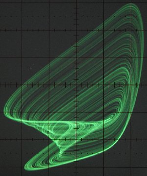

Yes folks, it's real. If Tim Escobedo's Q&D VCF:
http://www.geocities.com/tpe123/folkurban/fuzz/simplevcf.gif
is overdriven a bit it goes chaotic.
The circuit I used is almost the same as Tim's, except that it is run from a 12 V supply. With low Q (10 k on the resonance pot) and 0.6 V peak drive (from a TRI VCO) a sweep of the drive frequency produces a series of period doublings followed by a chaotic region (even with the usual small windows of periodicity!) followed by a final period undoubling. The attached file is a recorded sweep.
I've checked quite carefully that this is real and not just an artifact. The chaotic pattern depends on the type of diode used and goes away if the diode is substituted by a resistor. In the latter case, the filter looks like a bandpass filter driven into clipping, as expected.
Analyzing the circuit and simulating its response would be a fairly tedious job. But the necessary conditions for chaos are there: the system is of third order (with the drive included) and the diode provides the necessary nonlinearity.
This encourages an idea I've had for some time: to make a combo module that will operate as either a filter or a chaos generator. This now looks within reach.
Many thanks to Graham Meridith for pointing out this circuit, to Tim for a patient discussion of the filter's operation and to Scott Stites for pointing out that the MS20 filter has some unusual multiphonics when overdriven.
Ian

Wow. That's a pretty neat bug/feature. I can't even begin to account for that behavior. If only I knew about it earlier. Smile
I'm curious. What kind of op amps are you using? I almost universally use plain low powered TL06x chips. Occasionally TL07x series. I noticed the SK quad filters were 5534 I think. I have in the past treated op amps rather generically.

loss1234 wrote:
so you did nothing to the circuit except change to a 12v supply?
So is it possibe to add chaotic elements to circuits by replacing resistors with diodes? Or do you really need to approach this from a math standpoint?
No significant changes. The feedback network is the same, except for 450p instead of 500p for the small cap. (A larger cap actually gives a more dramatic chaotic behavior.) The CV input is not connected. The freq control has a bypass cap, but it doesn't make any difference. The bypass cap at the Vcc/2 supply is left off, but that doesn't make any difference either. The audio coupling cap is 0.1 instead of 0.01.
In general, chaos only occurs under special conditions, so just throwing some nonlinear element into a circuit usually doesn't result in anything interesting. That's why I was so surprised to see chaos in this circuit. Most of the work I have done with chaos is based on systems that have been studied previously.
Ian
frijitz
Joined: May 04, 2007
Posts: 1734
Location: NM USA
Audio files: 54
PostPosted: Fri Nov 30, 2007 8:53 am    Post subject: Reply with quote  Mark this post and the followings unread
Yeah, i didn't expect the chaos at all. At first I thought I was just having trouble with my scope triggering. But triggering off the input signal straightened me out on that.
I used an LF351 (similar to TL071). I also threw in an older slow opamp (BB3500, similar to LM307), but other than the slower slew rate it worked the same. So I don't think there is any major contribution from an opamp pole or anything weird like that.
The signal is different from anything I have seen before. As the input signal crosses zero from below, the opamp slews very rapidly upward, usually clipping. Then the decay of the waveform is much slower. So the opamp clippping may be an important part of the systems nonlinearity. Not sure about that at this point.
Ian

I've looked at this interesting circcuit a bit more. After reducing the input drive to +/-50 mV there is still nonlinear behavior. As the driving frequency is increased there is a resonance when f = f0 (the main resonant frequency) then around f = 2f0 the period of the output signal doubles and there is another resonance at f = 2f0. So the resonance occurs twice at the same output frequency but for input frequencies of f0 and 2f0. I'm surprised nobody has noticed this before. I have checked all the wiring and the component values very carefully. Well, perhaps it's the larger supply voltage.
Ian

PostPosted: Sat Dec 01, 2007 2:22 pm    Post subject: Reply with quote  Mark this post and the followings unread
A little further work on this interesting circuit. I tried it powered by a 9V battery and I seems to behave about the same as with 12V. Adding a small resistor in series with the diode reduces the tendency to chaos and rounds off the waveform a bit. A scope shot of the attractor seen with a 1 k series resistor is attached. The two signals used were the output and the voltage at the top of the diode. It's a very interesting shape. I can't recall seing an attractor quite like this before, although I can't quite follow how it is folded.
Ian
