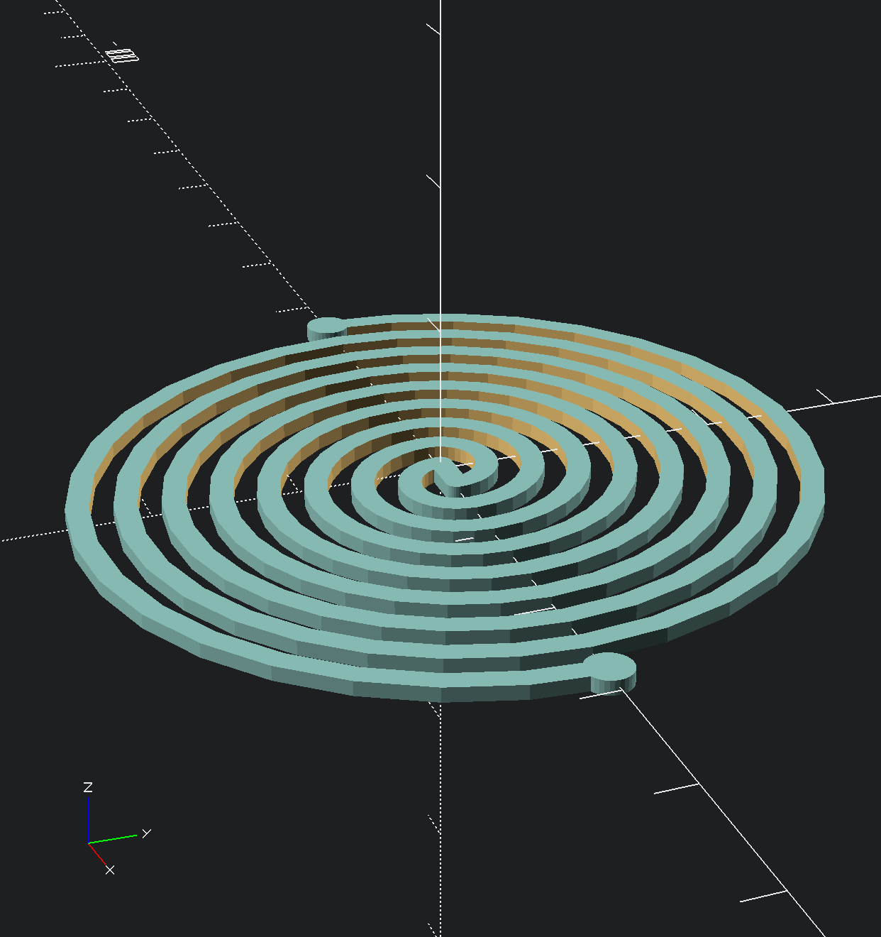

Excitement! I thought and thought of a way to do this. You see, it's not very simple because well, of a hundred problems. It became clear to me, as if divine inspiration guided my thoughts (which we know is true), as I created the CAD file.
It turns out that by interlocking two spirals I was able to make a varistor! This will be my first product. Vo1t, would you like to be the first customer? The model shown is defined by the following parameters:
Code:
num = 4;  // number of loops in controller
radius = 25;  // radius of controller
thickness = 1;  // thickness of traces
$fn = 32;  // number of facets on round parts
It is very fragile in this form, however with care it has not broken yet. I measure it to be 68 kOhm untouched. Then as I move it around, it gets as low as 10 or 20 kOhm or lower (I didn't notice the bottom end too much).
Actually the test setup kinda sucks right now because I'm using both hands to hold the probes and an extra finger to move it around. I need to make some way of attaching the leads on either end. Also it probably should have a base of some type with mounting holes.
Tell me what you think?
Les

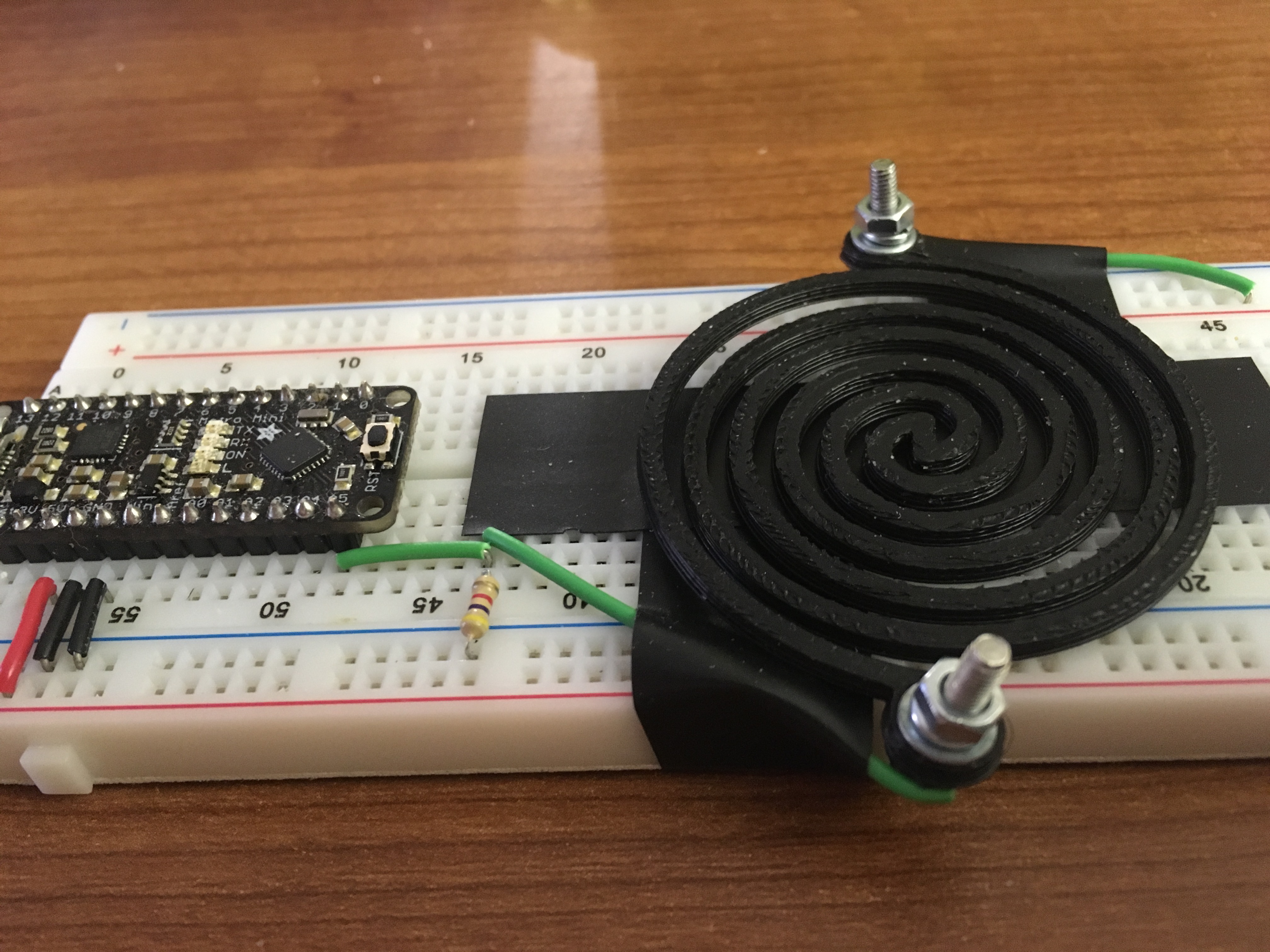

Here is the test fixture photograph.
Les

Ow.. I think I completely misinterpreted Your meaning of how to use this device...
I thought that by moving a finger over the spiral you would introduce a kind of "shortcut" between the windings of the spiral.
Please enlighten me Rolling Eyes how is this contraption ment to work?
deltamodulator
Joined: May 18, 2016
Posts: 91
Location: Texas, USA
PostPosted: Mon Jul 04, 2016 12:24 am    Post subject: Reply with quote  Mark this post and the followings unread
Hi Grumble,
I thought the same thing before I built it and hooked it up to an Arduino and wrote the Processing code. The shorting of the finger does nothing because the finger is an insulator compared to the winding's resistance which is in the neighborhood of 10k Ohms to 100k Ohms.
Instead, what I found is that the thing is flexible to the point that you can push the coils together to create shorts, and you can slide the resulting short along the length of the coil by moving laterally. This is the smaller change in Resistance.
To learn to play it well would require understanding and mastery of technique. Also I feel that a larger loop with more coils would be very beneficial.
Les
