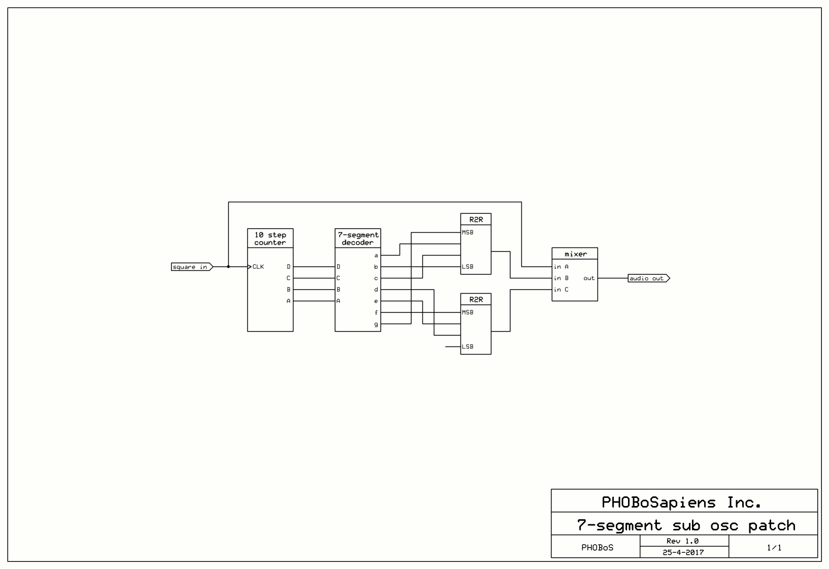

I uploaded a recording here. The module comes in around the 2:20 minutes mark.
And here's a diagram of how I hooked it up to the R2R's.
edit: forgot to mention that the mixer is stereo so one R2R is connected to the left channel the other to the right.
