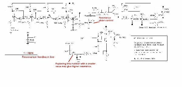

Would it be possible to use an LM13700 for the Transc. op-amps and some kind of transistor pair for the Exponential function converter? I am trying to breadboard this filter but I am stuck on the converter.
Does any one know a simple Anti log function generator circuit?
I found this(see pic) but I am not sure if this one is the correct one to use here. I think the one in the picture is a Lin/log converter. I think I need a log/lin converter. I am not sure how to do that.

Here is an update to help you build a roland sh101 type of filter. These guys did the hard part of figuring out what the resistor values are to replace the BA obsolete chip with Discrete components: http://mutable-instruments.net/shruthi1/build/smr4mkII. There is a schematic at there website.

Is the expo converter from Roland Service Notes working? it's for +15v, that's right?
in this PDF :
http://www.synfo.nl/servicemanuals/Roland/JP-4_SERVICE_NOTES.pdf
and the image above sh-101_vcf_schematic.jpg has diff voltage +5v
I'm not aware of the calculation here, but has anyone a schematic for -/+12v or an explication note?
I want to know how this thing is acting like the IR3109, I must try to breadboard from discreet and LM31700...

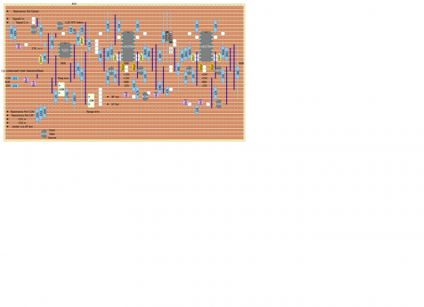

just finished that above mentioned 121 VCF and hmmm... i'm not so glad with my result... i have used 2xLM13700 and 4x 2SK30 instead of the original parts...
the filter does self oscillate but only in the very low spectrum and the Output is rather a square than a sine... even with no Input at Audio in...
tried playing aroud with the resistors in the Feedback path of resonance...
reducing that 6,8k resistor even lowered the frequency so i thougth ok let's increase it... so i soldered a 4,7k with a 10k trimmer in series and well it's slightly higher and the resonance Output is lower in Amplitude but i only get more of a humming frequency and when i only had 68k in self oscillation disappeared...
any idea how it's original behaviour is?
does it cover a wider range of frequencies in self oscillation?
any Information or Input would be welcome as usual... thank you

something must be wrong with your build. i am getting a very nice sine wave across the whole spectrum:
roglok
Joined: Aug 28, 2010
Posts: 202
Location: uptown
PostPosted: Sun Nov 01, 2015 4:24 am    Post subject: Reply with quote  Mark this post and the followings unread
did you pay attention to the FET pinouts?
wackelpeter
Joined: May 05, 2013
Posts: 461
Location: germany
Audio files: 10
PostPosted: Sun Nov 01, 2015 10:31 am    Post subject: Reply with quote  Mark this post and the followings unread
Hi Roglok,
thanks for your reply.
Have soldered the FET according to the SK30 data sheet i found at my suppliers pages.
These are as per front view (where you can read the identifier) from left to right source, gate and drain...
and when i read the original schematic correct, then there is the gate connected to the Output of the OTA the source to +15V and the drain goes to the next stage and -15V via resistor. correct?
Wasn't there something about 2N3819 Fet's where sometimes the Pins where swapped?
wackelpeter
Posts: 461
Location: germany
Audio files: 10
PostPosted: Tue Nov 03, 2015 10:31 am    Post subject: Reply with quote  Mark this post and the followings unread
Problem fixed...
Forgot to cut two rails on my stripboard design so that the gates and drains of the FET's between stage 2 and 3 where tied together... luckily nothing blew up and i have now a sine over the whole spectrum with full resonance and the filter sounds like a filter know and not only like an VCA turning tone on and off...
will now tweak and tune it a bit until i'm satisfied...

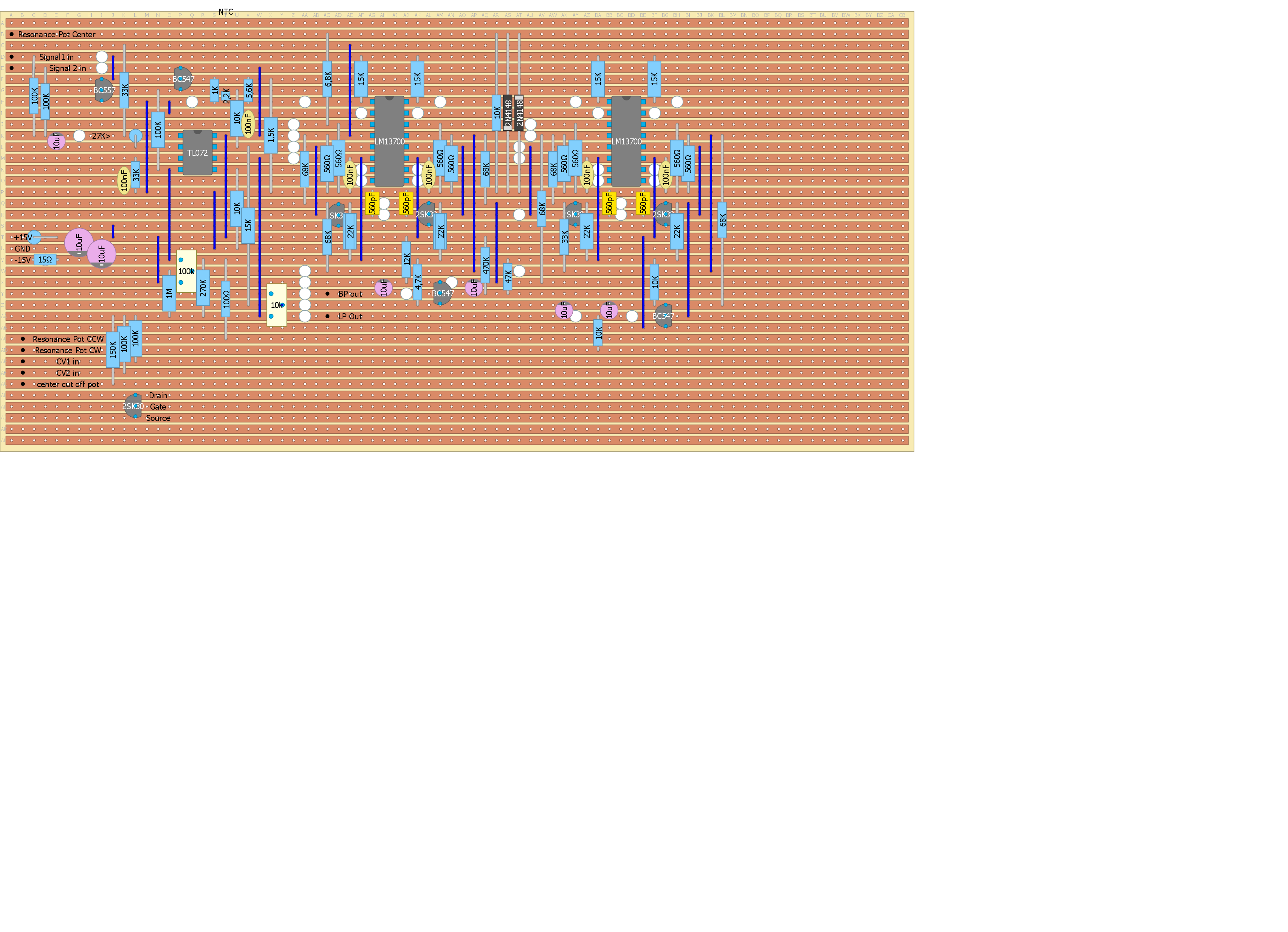

Okay....
Here's my first i guess a bit lousy attempt...
the White dots mark where the trace has to be cut on the side with copper rails... indeed also cuts are needed underneath the IC's...
the black dots mark the Points for external wiring... not shown frequency pot which needs +15V and GND on it's outer wipers... also not shown Input attentuators for Signal and CV...
All Electrolytic caps except those 2 on the power rails should be non-polarized as per Frequency Central...
btw. in the schemo i see BP which for me would mean Bipolar... hmm... for non-polarized i'd expected a NP
because lacking a sdt-1000 i used a 2,2k NTC and a 8,2k to 10k resistor in series (that's the one mislabeled with 1k)
Before building please take Care of the Veroboard Size... i guess i missed a bit the Ratio... but everything should fit easily on a 2,5mm raster on a 100x160mm board
would be nice if someone could check if i missed something... maybe i'll do that later...
P.S. tried to upload the diy layout creator file as well... but this doesn't seem to work... restricted file extension
Edit says: like in my first own build i forgot to cut a trace... please do cut between both drain of the FETs between stage 2 and 3
 Filesize:  231.53 KB
 Viewed:  423 Time(s)

this is great, thank you very much!!!
i have a Q if i may...
what scheme did you use for this layout?
wackelpeter
Posts: 461
Location: germany
Audio files: 10
PostPosted: Mon Nov 09, 2015 11:47 am    Post subject: Reply with quote  Mark this post and the followings unread
that was the original schematic attached in the 121 VCf clone pdf from frequency central... see above in this thread...
just figured out the Pins of the LM13700 vs Ba662 and then going for it..
i have to tell that ialso tried to mod this with a small passive hpf via Rotary swith and different cap sizes... works not as well as thought first... it's more lowering the volume than filtering higher frequencies out...
edited that in my previous post too... have spotted the first mistake... both drains between FEt 2 and 3 should be separated... the same i've forgotten in my first own build... i knew someone, who can endlessy repeat the same stupid mistake... Wink

Another Q please, how did you match the FETS?
wackelpeter
Posts: 461
Location: germany
Audio files: 10
PostPosted: Tue Nov 10, 2015 7:45 am    Post subject: Reply with quote  Mark this post and the followings unread
They're unmatched as are the LM13700 too... Just straight from one Batch...
I also have no idea how to match FETs... If i would like them matched i had to ask Google and friends how to do...
btw. here's a small revisited Version with the forgotten cut in the rail now drilled...
 Filesize:  229.5 KB

thanks to Roglok for providing the link to the wonderful Roland SH 101 filter revision by Frequency Central.
My question is, may i subb in any general op-amp in place of the specified lf 351 ? And can i use the lm 13700 in place of the 3080 safely?
i attached a part of the schematics. May i assume that the red arrow is pointing to the audio input?
and what's the symbol the green arrow is pointing to?
Someone tried to stripboard the filter but i havent heard about the results.
Any help?
thanks!
