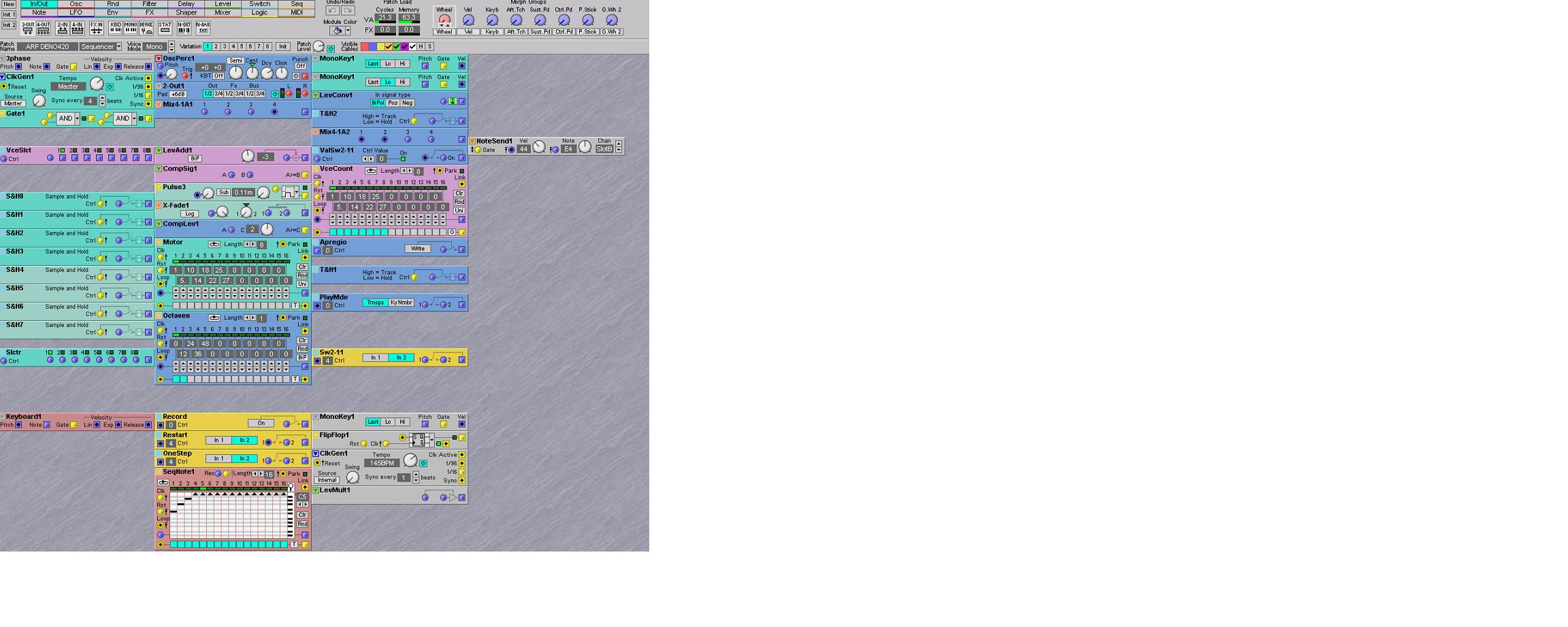

Hi
Is possible to transpose the G2 arpegiator in real time with another slot ?
exemple :
slot 1= synth patch+argegiator -
slot 2 = transpose arpegiator of slot 1 in real time with one note ?
thx

I suggest that we continue in English so that all members of the forum can read it. But I'm much more comfortable in French too! We can go back on AF if you want.
Just say it and ask for help if you do not understand the patch! G2 Built-in arpeggiator does not send MIDI out. I suggest to use a 2nd slot with an DIY arpeggiator patch instead of using the built-in arpeggiator. Like the one I posted on AF. Several types of arpeggiators (monophonic, polyphonic, voice allocation, etc.) are available on the forum.
Tell me what you do not understand in the patch that I posted before
(the top part if you want to make a chord and change it to an arpeggio).

The top part is not mine. Yesterday I tried to find the initial patch without success. If someone recognizes the patch (top part) and can tell who the creator is, I'd be happy to add it to the patch (as a reference) and here in the discussion.
