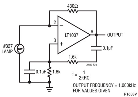

My plan is to lift up the ground terminals on the inverting and non-inverting sides and connect outputs from other oscillators in some creative way. Ideas for how to do so are forming now.
The Wien Bridge Oscillator Schematic (from Google image search)

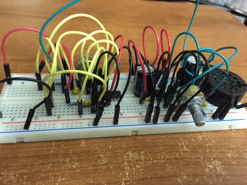

Here is a quick update on my progress.
See "The Electrifried" speaker driver breadboard circuit. It is designed to receive power from the left, generate test signals in yellow wires and drive an 8-Ohm speaker on the right. It works pretty well.
More to follow.

I was having some issues with powering the board due to lack of parts in my workshop. No battery holders, no wall power cube jacks, no usb power connectors - all stuff I normally have suddenly missing. So what to do?
Order new parts then look more. So long story short, lots of power parts are on the way. This includes some pleasantries such as a 2.1mm jack in-line power switch, very handy and very safe. Also some panel mount USB power input parts for the final design.
Then I searched more thoroughly, and on top of the refrigerator was a box in a box that had a jack and plug of 2.1mm size! The female one was what the circuit needed so I hooked it up, plugged in a 12VDC transformer found earlier, and and suddenly crisp, loud (loud enough) tone came out of the speaker!
So long story short, problem solved. I played a bit with the frequency knob of the oscillator and was able to get bird calls out of it even! Happy day!

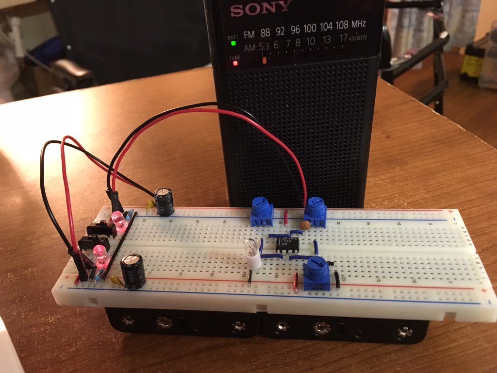

Friends, checkout this photo of my latest test circuit. It's got my latest test circuit. The idea is to make a "Mr. Microphone" that shifts the burden of the audio output to an AM radio. This is cool because its small and simple which saves space and complexity. An equivalent circuit (single supply and LM386 speaker output with artificial ground) with more typical setup took an entire breadboard and had wires all over the place!
Below and attached to the underside of the breadboard are a pair of 6V battery holders creating Vcc and See. I like this arrangement because it eliminates the virtual ground and does not glue me to a test bench where a bench supply delivers power.
The circuit is simple: just an oscillator that oscillates in the AM band. When it's on and all tuned uo I can hear a frequency from it that drifts or warbles. It h as no antenna yes so I'm surprised that it works that well. I have t here pots: negative feedback, upper RC and lower RC. I chose this arrangement to study how the circuit works.
It's fun to listen to the frequency drift when t he power is switched on. I figure it's due to the lamp warming up (or probably al of the parts). I am currently working on removing harmonics due to the slew rate limit of the opamp of 11 Volts/microsecond. The test for that is to set the oscillator at a low frequency and scan for a harmonic at twice that frequency, then adjust the feedback pot to minimize the upper frequency. I have better pampas on order soon, but this one is what I have for now so I'm working within its limitations.
The transmit distance is about 0 to 4 inches so. At 8 to 12 inches in any direction the signal is completely lost. Of course that is without an antenna. Next up: build an antenna!

It's a lamp, yes. I'm not sure if it's neon or incandescent or whatever else a lamp can be. I got it from Digi-Key. I'm not sure if it's the right lamp for the job and some kids claim to have damaged half of my stock of 10 lamps including this one. The kids are pranksters. Grrr but not that much!
This lamp reads 100 Ohms when off. I heard it mentioned that sometimes the lamp glowed and other times it did not glow in this application, dependent on the setup. Or it can glow below the visible threshold in daylight and room lighting.
The way it works is the lamp has a positive temperature coefficient meaning that when it heats up it gets higher in resistance. So what happens is the amp starts out with harmonics in it's spectrum then the lamp warms up from all the signal applied to it and this causes the gain of the lamp to lower then the reverse happens, etc. (or the other way around, anyway it stabilizes). This creates a clean sine wave.
When I play with it I see signs of this happening by tuning the lamp so that harmonics exist up and down the AM dial. Then when I tune the feedback resistor (I make it a 10k Ohm pot) I notice the effect. In no case do I not notice the feedback. I think this is because the trimmer pots I am using are 10k Ohms and the resistor is 100 Ohms, so I plan to use a smaller resistor parallel with the pot to get more sensitivity. That or get a 1k Ohm or 100 Ohm pot.
Anyway, it's really fun to play with and the goal is worth the effort. Stay tuned!

I just improved the transmit distance from about a decimeter to a full meter (early tests of me playing around show this). First I would an inductive antenna, then I made calculations for a matching resonant capacitor. The website for calculating the inductance value is here:
